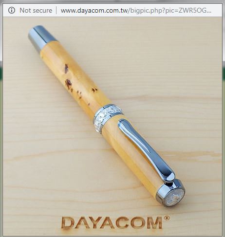

The highest quality kits you can buy is from Dayacom hands down. DAYACOM INDUSTRIAL CO., LTD But they require an amount that is not possible to even consider ordering from them.
OK.. Since you brought it up....That is my question. Dayacom is in Taiwan! The only difference in their product and the one I can get from Ed @ Exotic Blanks (or anywhere else for that matter) is that their picture says "Dayacom" at the bottom. It is listed in their "High End" section. Plus, they don't list prices. I imagine that they are the ones that PSI and Ed get their supplies from in bulk but that is a moot point as I'm not buying 500 of them. Plus, I can call Ed and Darlene on the phone or order online and have it in 3 days! Or if there is a problem with a component I can call Ed and have another one in 3 days. Please tell me how Dayacom kits are of a higher quality.
Dayacom Jr. Aaron
Exotic Blanks Jr. Aaron
I don't have time to find PSI's version with a different name but they sell it also.
They are the same kit as far as I can tell.

The kits you see on the Dayacom website are the exact same kits that Exotic Blanks sells. . CSUSA sells some Dayacom kits also. . Other vendors may also sell some Dayacom kits. . Sometimes the name gets changed. . Sometimes the vendor may not tell you he/she is selling a Dayacom kit. . But, I think it is true to say that Exotic Blanks does tell you, and also that they keep the same name. . In any case, you can't go wrong buying from Exotic Blanks. . Whatever they sell, they will tell you all you want to know about it, and they will stand behind everything they sell. . Dayacom kits often have the Dayacom name on the back side of the clip (where that is possible), and the plastic ziplock baggies they come in have the Dayacom name, plus the refills have the Dayacom name. . Dayacom kits are known to be of superior quality. . You can put a high degree of trust in their name and, as far as I know, there has never been a phoney kit marketed under their name.
EDIT: (because you and I were typing at the same time) The Majestic from PSI is NOT the same kit as the Major by Dayacom.
Also, I have always believed that Dayacom has a unique manufacturing source for their kits, which I have always thought is theirs alone.
PSI seems to source their products from a variety of sources; some sources are in Taiwan and some are in China. . I would be extremely suprised if PSI and Dayacom have a common source for anything.
