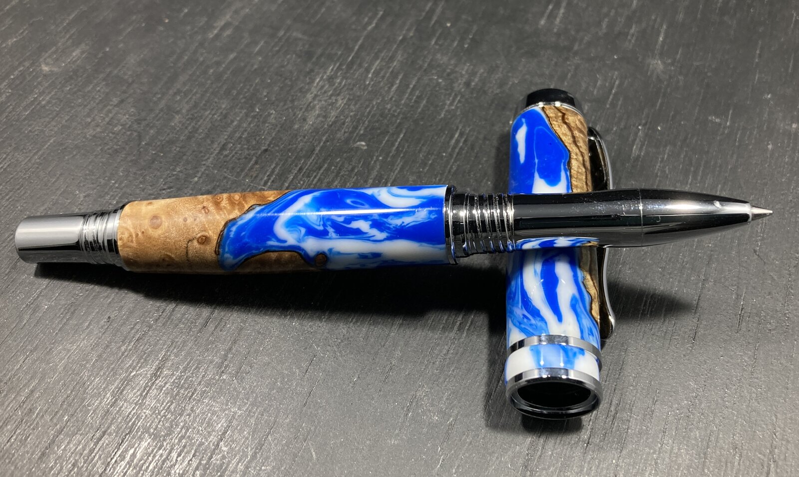

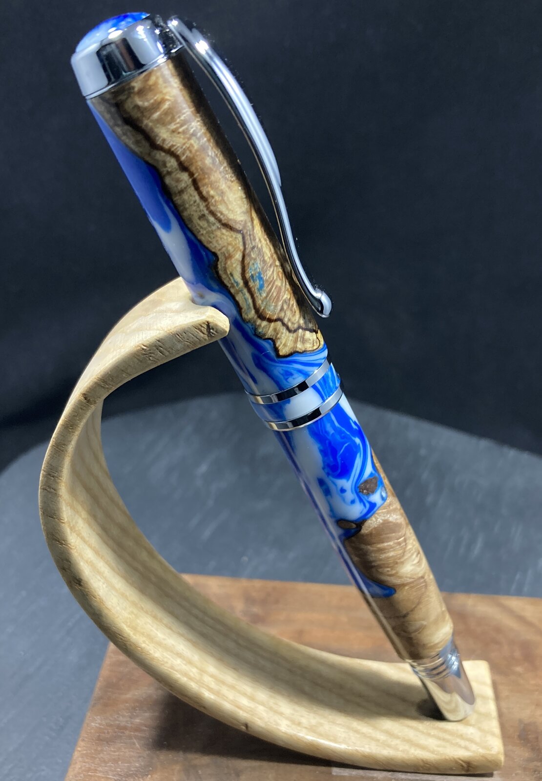

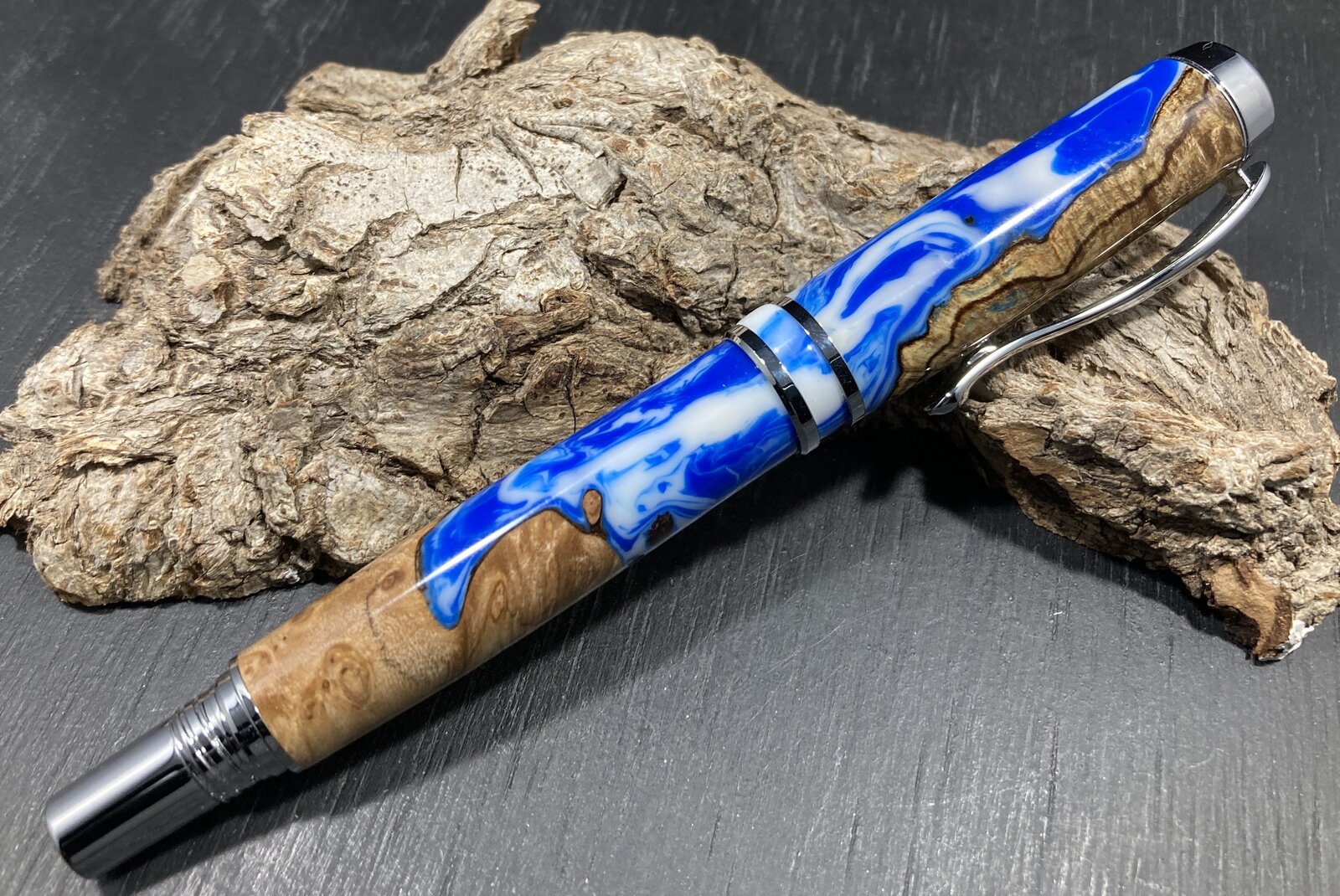

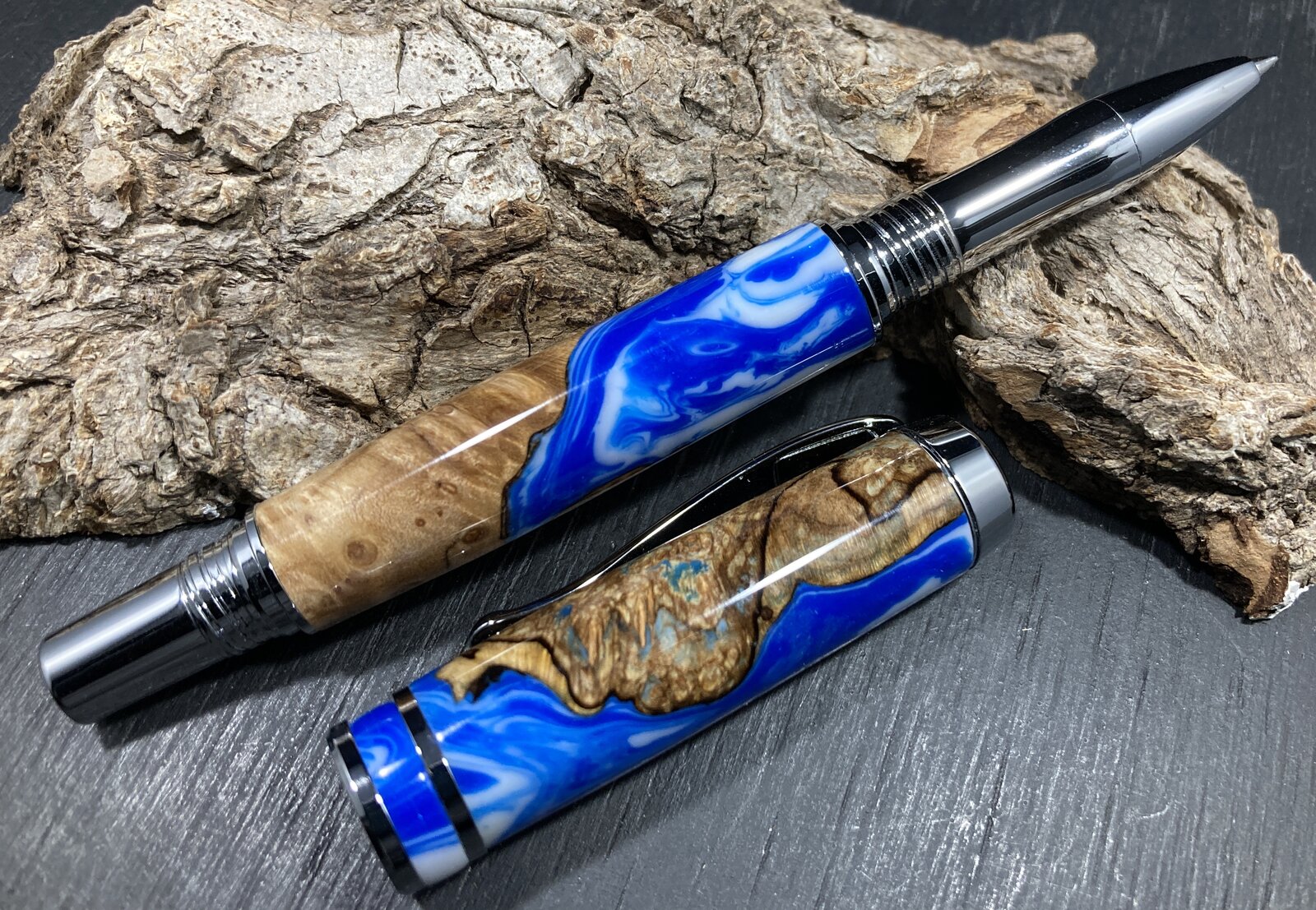

Nothing else to do with it being bitter cold outside. I found a hybrid blank I had poured back in May, and never used. I thought it would look nice in a Jr. Gent or Diamond Knurl rollerball.
I think I spent more time making the Center band (using my shop-made cheapo resin mandrel) and the finial than I did on the entire rest of the pen. But, each time I get a little better, and it goes a little smoother.
For some reason, the pen reminds me of the frozen Great Lakes (maybe because I have been watching the weatherman a lot lately.😁 )
