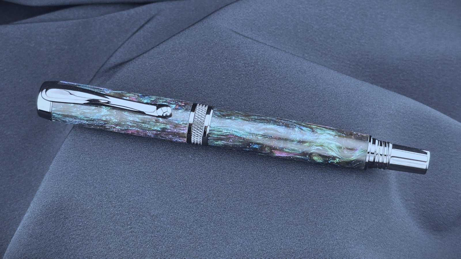

What is schism you ask? Hobble Creek named it, but it turned nicely and is very sparkly. That's what I know. Nothing fancy added to this one.

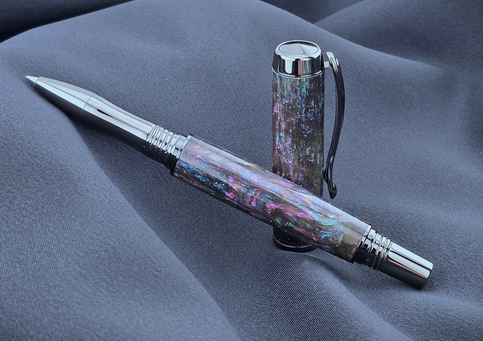

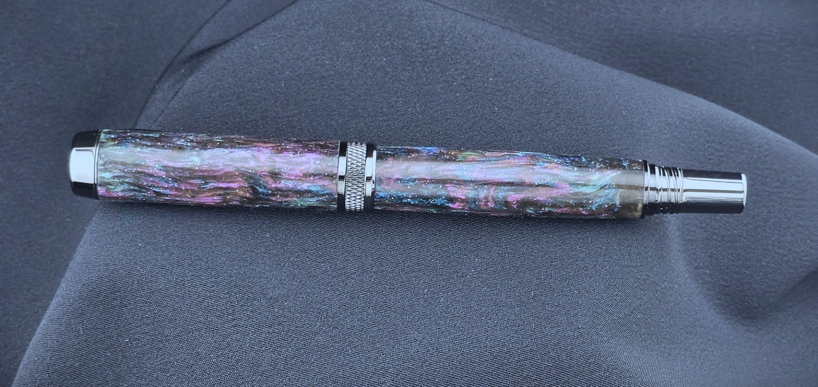

The color in the blank is more green than blue, but accurate pictures are tricky. The middle picture looks the closest to me.
Edit: Updating after a couple questions that made me realize things I didn't mention originally
I feel that the gunmetal is doesn't overpower the darker blank material. That and I just like gunmetal hardware. :D
I polished the barrels with the first 3 grits of zona paper, put on 2 coats of medium Glu-Boost and 3 coats of thin, then polished back through all 6 zona grits. The CA really gives some extra depth to the urethane resins.

Oops, I edited to add the process and hardware info. Normally, I put that in my posts. In my defense, I should have already been asleep when I posted this.
It was a round blank. The chatoyance is more even when they are vertically cast. I'm sure there's some science involved, gravity and particle shape and whatever.
