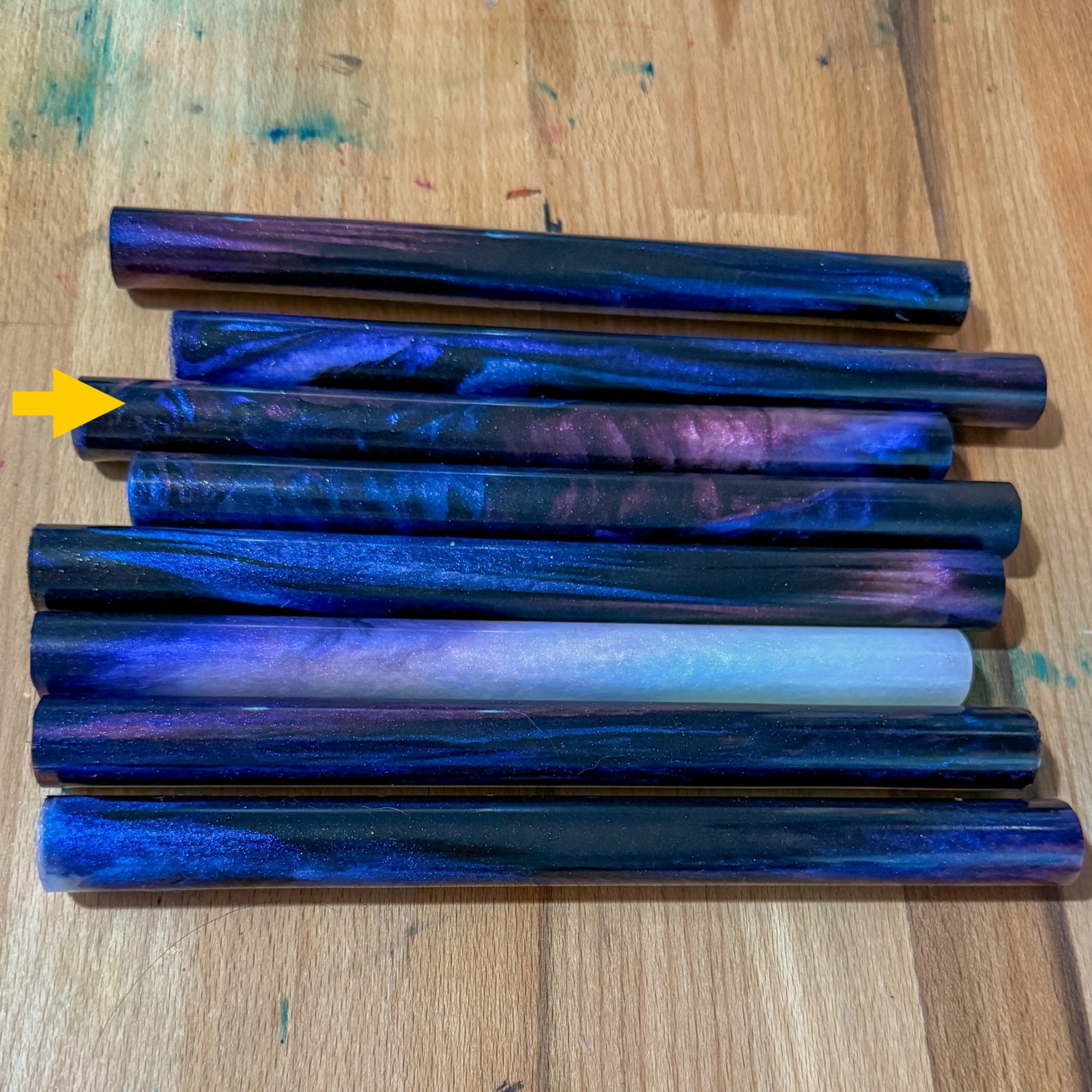

Here's a fresh batch of galactic spiral blanks (the original spiral pattern) in the Uzumaki colorway. These ones also glow in the dark and will put up another video soon (recorded this during the day).
This evening's turning was working on a commissioned calligraphy pen holder from the Venus resin, one of the galactic spiral blanks. This is the top section of the second blank from the left. In this colorway it is easier to see the internal spiral behind the surface streaking.

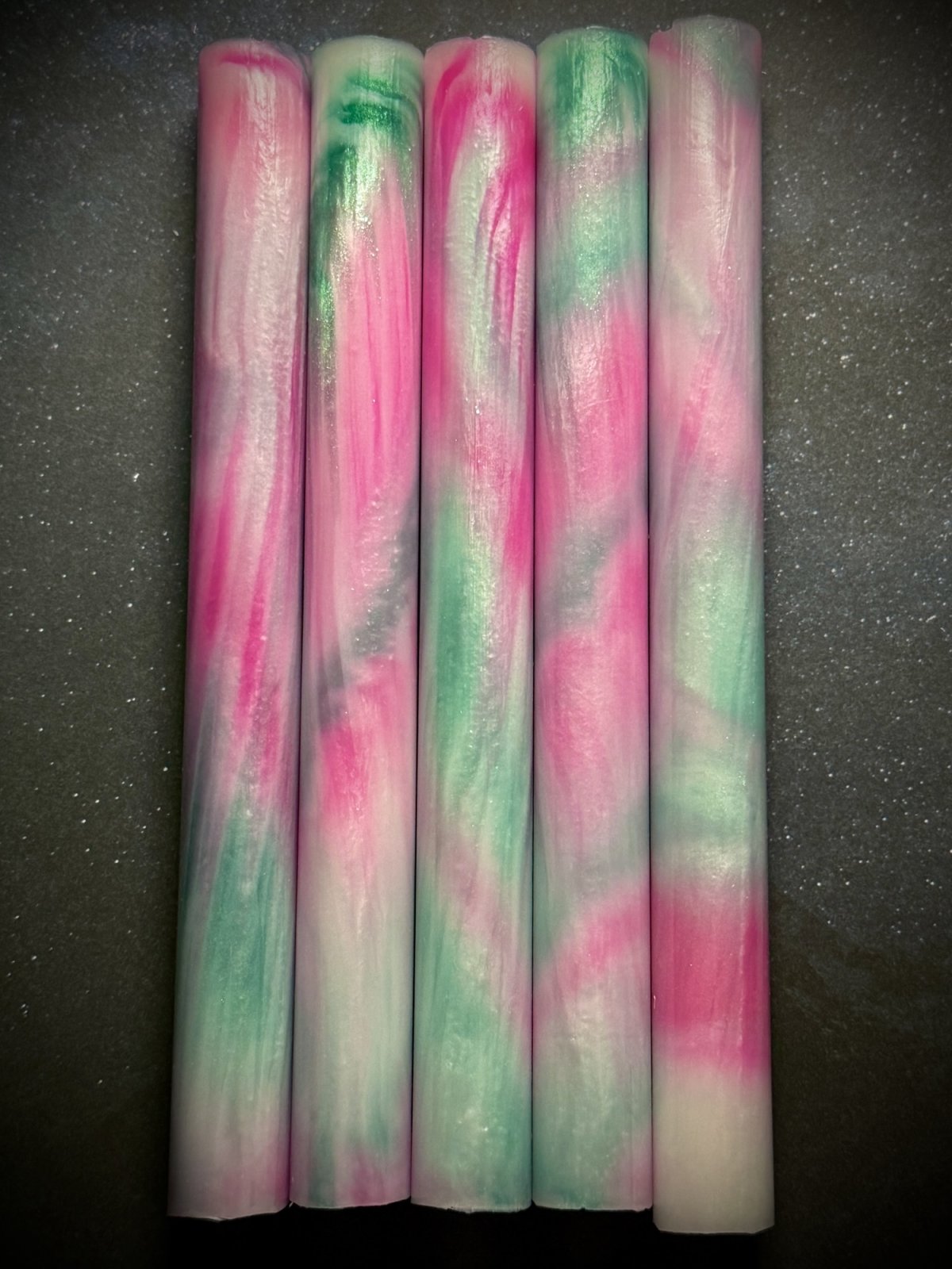

Here is one more set from 4th of July restocks.
The first is one of my segmented Spiral Blanks that has a candy cane or barber pole like appearance. The shimmery grey infill in this one is translucent, though it's not apparent in this video.
The second and third blanks were made seconds apart, and it's pretty fascinating how much the temperature change alters the look of the blank in that window. These are also in Thermoset which looks a bit different than Alumilite as I mentioned above. The last three are also thermoset, and the middle one I alternated the spiral to make a zig zag.
