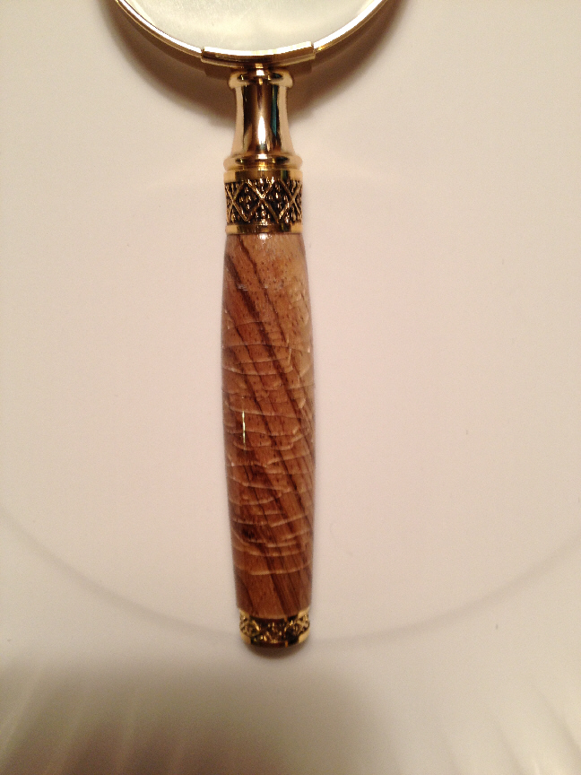

DEVESTATED! What happened here?
Bobostro61
Jan 5, 2013
576
Chicago, IL
I made this magnifying glass and a letter opener last night. Both came off the lathe with a great looking CA finish. This morning, they both looked like this! What could cause this to happen overnight? I was thinking maybe it was old CA glue? Possibly applying the finish in a cold garage? I don't know. Any ideas? I put on a few coats of medium CA followed by several thin.
Stick Fast. I've used these bottles on many many pens with no issues. They've been sitting around for a while. I've been doing a lot of PR blanks and decided to get back into using wood for a change. Just wondering if the combination of old glue and the cold garage had anything to do with it. Although the glue isn't even a year old yet. I don't know...
Definitely caused by wood movement... CA is extremely rigid, it will not expand and contract with the blank. My guess is you heated the blank while sanding, then applied your finish. As it got colder throughout the night, the wood contracted and the finish didn't.
You can eliminate wood movement causing the issue by switching brands of CA.I use Hyperbond thin flex to finish mine.It costs around 5 or 6 dollars for 4oz.Then again it could just be old or maybe it's the accelorant causing the issue.
What was the temp in the garage?
Not ungodly cold. It was in the 20's outside. Warm enough in the garage though where the container of water for wet sanding didn't freeze from the day before.
As far as brands go, I've always used Stick Fast with no problems. It's just a bummer to see such a nice kit go to waste.
Not ungodly cold. It was in the 20's outside. Warm enough in the garage though where the container of water for wet sanding didn't freeze from the day before. As far as brands go, I've always used Stick Fast with no problems. It's just a bummer to see such a nice kit go to waste.
The kit is not wasted. At worst the blank may be wasted but may be saved yet.
I use stick fast pretty much exclusively an love it. Haven't had that issue yet - although now I probably will. :-(.
I have seen this on some of my older pens. I believe that big swings in temperature causes it. I have done shows in FL were it HOT then they cool and get HOT again not a good thing wood expands and contracts. Are your blanks stored in the cold environment then turned, finished and brought back into a warm environment.
Something to think about....
Good Luck
I have had the cracking occur twice. Both cases, the woods were oily. I attributed the problem to the oils(camphor and sandalwood). Now, the oil may not be the case, but my shop is heated and I've used Stickfast almost exclusively, so that was the only thing I could think of.
Perhaps we should get a group effort going, buy stick fast and do various experiments with it to see exactly what makes it do this.

Reason for most of these questions is I would love to be able to reproduce this effect easily for not just artistic value but educational and documentation purposes.
This is very interesting. I have seen it on many others pens, none of mine. And with varying temps. I use E-Z Bond CA and even when it had gotten old, never gave me these types of issues
Perhaps we should get a group effort going, buy stick fast and do various experiments with it to see exactly what makes it do this. Few questions that I have is: *) What are you planning on doing with the glue and accelerator? *) What type of accelerator are you using if any? *) What type of wood is this? *) Do you plan on doing a refinish or toss the blank? Reason for most of these questions is I would love to be able to reproduce this effect easily for not just artistic value but educational and documentation purposes.
Ed - that's a great idea. If we could make the cracking happen on demand, we could have a Better idea exactly what causes it.
Not sure how it could happen on (properly) stabilized wood... this really is a simple case of wood movement. It's not the stickfast, most brands of CA in the US are made by just one or two manufacturers and rebranded to suit the company selling it. I use EZ bond and stickfast, BOTH on every piece that gets a CA finish, and have never had an issue. I make duck calls that travel from warm dashes in pickups to icy cold water and back again regularly, yet have never encountered the "cracked glass" look. The wood moved, simple as that. Use dry wood and you will likely never experience this again.
To me , those look like tension cracks rather than compression ridges . Even if the wood wasn`t completely dry , it wouldn`t shrink that rapidly , and it would be more apt to cause the white haze effect . I`m too lazy to check the thermal coefficients of expansion of different woods versus CA , but it appears that the one for whatever species of wood this , is higher than CA`s . But I would also bet that at least two other factors played a part in this , the first being a very thick layer of CA , perhaps not as well bonded to the wood as it would have been if the thin CA had been used first , and secondly and partly caused by the first , the CA was a long way from being fully cured and reaching it`s maximum tensile strength .
Are you confident that the wood was dry?
I have a question - has anyone had the cracking effect happen on stabilized wood?
I have, and each time it was with the Stickfast Wood Finishing CA. I tried the same blank with the regular Stickfast and it didn't do it. It seems to be associated with the medium glue, not the thin. What this means I couldn't tell you.
The wood was definitely dry. Zebra wood pen blanks I bought from woodcraft several months ago. I keep my blanks in the house then out to the garage to turn. Could be that I did screw up by putting the medium glue on first. The blanks had some pits in the wood that I thought the medium would fill first and then put on the thin. My mistake. Live and learn!!
I'm going back to your second post and have had issues with older ca and cool or cold temps..almost identical cracks that don't really seem to follow the wood grain..I'm definitely not an expert but would think expansion cracks would tend to mesh with the grain pattern..and before anyone flames me, I previously stated I'm the opposite of an expert and don't have scientific data to back my opinion.:wink:

I'm going to go along with it being a temperature related issue.
I had the thick clear coat finish on an electric guitar neck do the exact same thing after leaving it in a cold car for a bit too long, and then bringing it in to a warm environment.
Cracks just like those all up and down the whole neck.
I was not a happy camper.
Yes - Stabilized Boxelder Burl.
Also - The first I ever saw this effect personally was on a Gator-Jaw blank.
Here's my personal experiences so far.
  1. I've experienced it 7 or 8 times at least in the past year or so.
  2. I too use StickFast CA, usually 2-3 coats thin followed by 3-4 coats medium.
  3. Temperature doesn't seem to be a big factor, most mine has happened in the Indiana spring through summer months where temps don't fluctuate rapidly at least.
  4. I Normally use accelerator on the medium to speed drying.
  5. I've tried NOT using accelerator with some results, but still got the crackling on some laser cut image bodies.
  6. Crackling seems to occur anywhere from overnight to two months later.
  7. I also tried the StickFast Wood finish CA with mixed results (same thin/medium method as above). Using Accelerator, some didn't crackle, and some did. Darn!
  8. Tried StickFast Wood Finish CA without Accelerator and at least got different results: of half a dozen pens done, none crackled, but all after a few weeks of curing show a wrinkled "orange peel" like texture on what was a glass-smooth surface when it came off the lathe. So this is certainly not a very good alternative.
  9. I've not tried other brands because I seem to recall reading in some of the other threads that people were having the crackling with those other brands as well.

thought the stick fast was a flexible ca ,
not sure also if i used a accelerate or not i don't always, i did on the ones that didn't no crack.
I had a similar problem with some pens a few months ago.It turned out to be the result of using some older CA glue (Stick Fast Medium finishing glue) I made a number of pens when the glue was just opened with no problem but when I made some after a few months the finish would crackle overnight no matter what I did. I bought a new bottle of glue and problem solved. BTW - I kept the glue and still use it for gluing tubes in blanks or other uses where it is not a finish.
mike

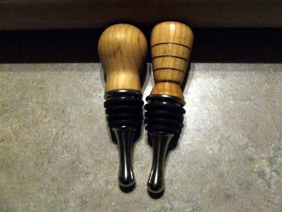

I'll give you a pic to look at and see if you can tell me which is which??
One has a CA finish and the other is simply polished and waxed. Can you tell which is which? You sure can when you hold them in your hands.
