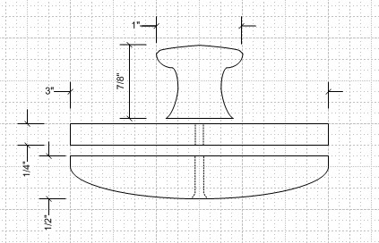

About 10 years ago, wife and I were on a day-trip to a nearby town and were walking through a gift shop that offered calligraphy supplies. I noted that they had a small desktop blotter, so I did my Norm Abram imitation and made a set of measurements so that I could replicate the blotter when I returned to my shop. I made two of these - one for my son, while the other has resided on the desk in my office for the past ten years.
Dimensions are not critical, but I kinda like the 1 1/2x3 size of the blotter I made as illustrated in the attachments. The radius of the curved bottom is not rocket science - I think I used a paint can as a target, and then refined the shape to have a smooth curve using a disk sander. I used red oak for the body and padauk for the handle, but any timber would work. Finish is WOP. The blotter is held together by a single flat-head wood screw that enters a countersunk hole at the bottom of the base, proceeds through the top plate of the blotter and into the knob. I suppose a stronger design could be done by embedding a nut in the handle and using a flat-head machine screw rather than the wood screw, but mine has held up for ten years.
I later used contact cement to glue a layer of thin (1/16") craft foam around the curved bottom, around the ends and onto the top of the base. Pressure from tightening the knob on the wood screw keeps the blotter paper in place against the craft foam. I've also thought about gluing a small bit of sandpaper on the bottom of the upper plate to provide additional gripping force on the blotter paper, but that hasn't proved necessary.
Finding blotter paper isn't as easy as it was many years ago, but a good quality rag paper will work.
