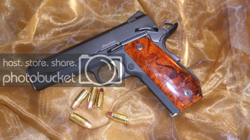

I've never heard of Desert Ironwood being stabilized. That doesn't mean it doesn't happen. It's just that Desert Ironwood is extremely dense, and won't absorb much of the resin.
I have made a set of grips out of Desert Ironwood burl, and they turned out great. And I bought the block from Bad Dog burls (un-stabilized).
Here's the set I made.
I may have to refinish them. After learning so much about finishing pens, I think I could do a better job on these. BTW, they are about 2 years old, and no cracks so far.

Nice looking 45. you've got there, stunning with those grips however and while the pics is very well taken and clear, putting my "firearms safety hat, on" I would have preferred to have seen that 45. with the magazine out, the slide open and certainly, the hammer down...!:eek::wink:
It would still looked nice, with the magazine next to the rounds, and the handgun being so new and well looked after, the open slide would show the shiny barrel.
Done this way, it would give a certain confirmation of your firearms safety procedures, mentality and tendencies...! This doesn't mean that you are unsafe or don't practise safe procedures, don't take me wrong or be offended by my observations, they are pure and simple of friendly nature resulted from my firearms handling background, that's all...!
In regards to the wood finish, I don't know what coating material you used but, if you have a good layer on them, you could obtain brilliant results by polishing them with a polishing buff and some polishing past/compound...!

Dan Wesson's are soooo sweet...(the grips are nice too!!!) (I have the 2009 PM9 Stainless)
This is my 2nd DW. I have a 2009 CBOB stainless. It's actually my favorite gun. This one uses thin grips, so I can't change them to my CBOB. I bought this one because I couldn't find a PM 9. Now that they are going for around $1400, they are a little easier to find. But I got on the list for this one early, so I got my 9mm. A little cheaper to shoot, but I like the 45 better.
Cheers
George
This style of gun (1911) is designed to be carried this way. They have a grip safety, and a thumb safety which is set. It's know as "Cocked & Locked", or condition 1. It is actually unloaded in the picture, but I took the picture to show the condition that it's carried. And I didn't take offense to your comments. Oh, and BTW, it's a 9mm. :)
It's finished with gloss polyester. But I know I could do a better job after finishing pens for a year. I still don't use a buffing wheel. I may have to get one soon. If I do, I'll give it a shot before I strip the finish off and start again.

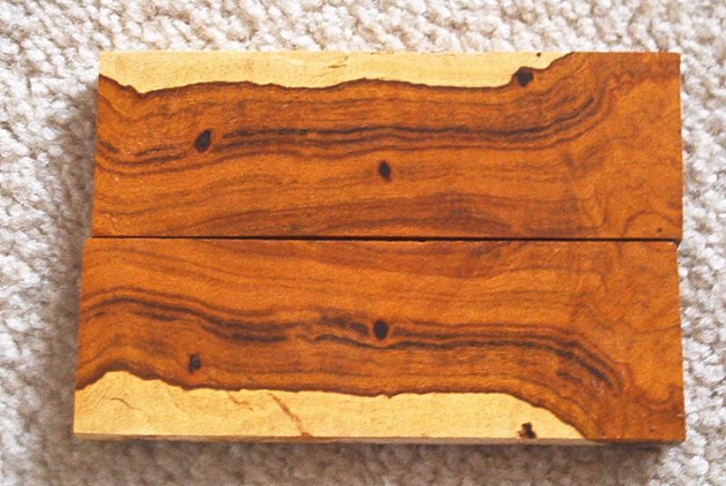

Heres what the wood looks like. I got it for $12.50 shipped. :D
That's a good deal on DIW. I love how it polishes. To bad pictures can't do it justice. There's just no way to show the 3d effect of the wood. Of course that can be said for many pens too.
