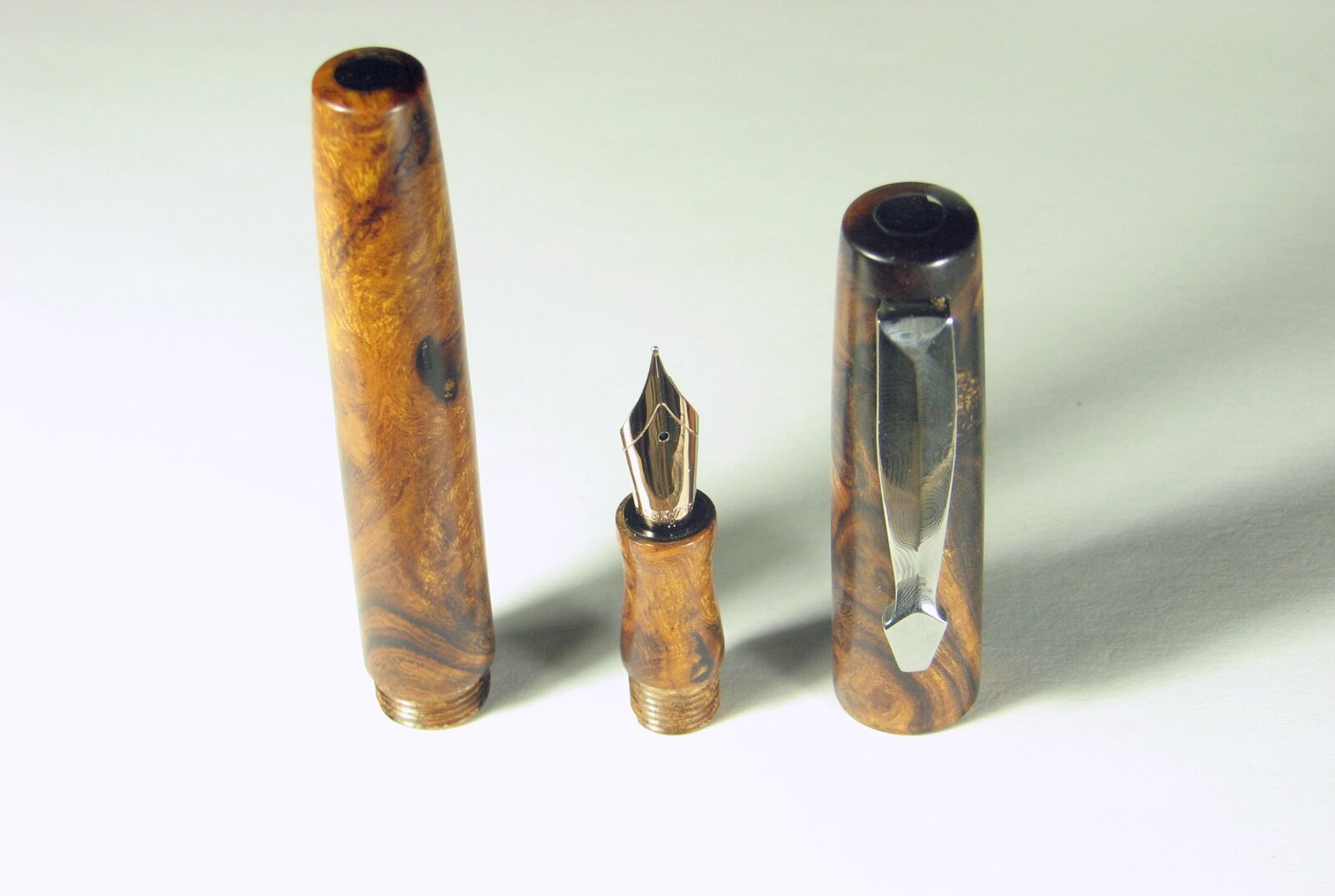

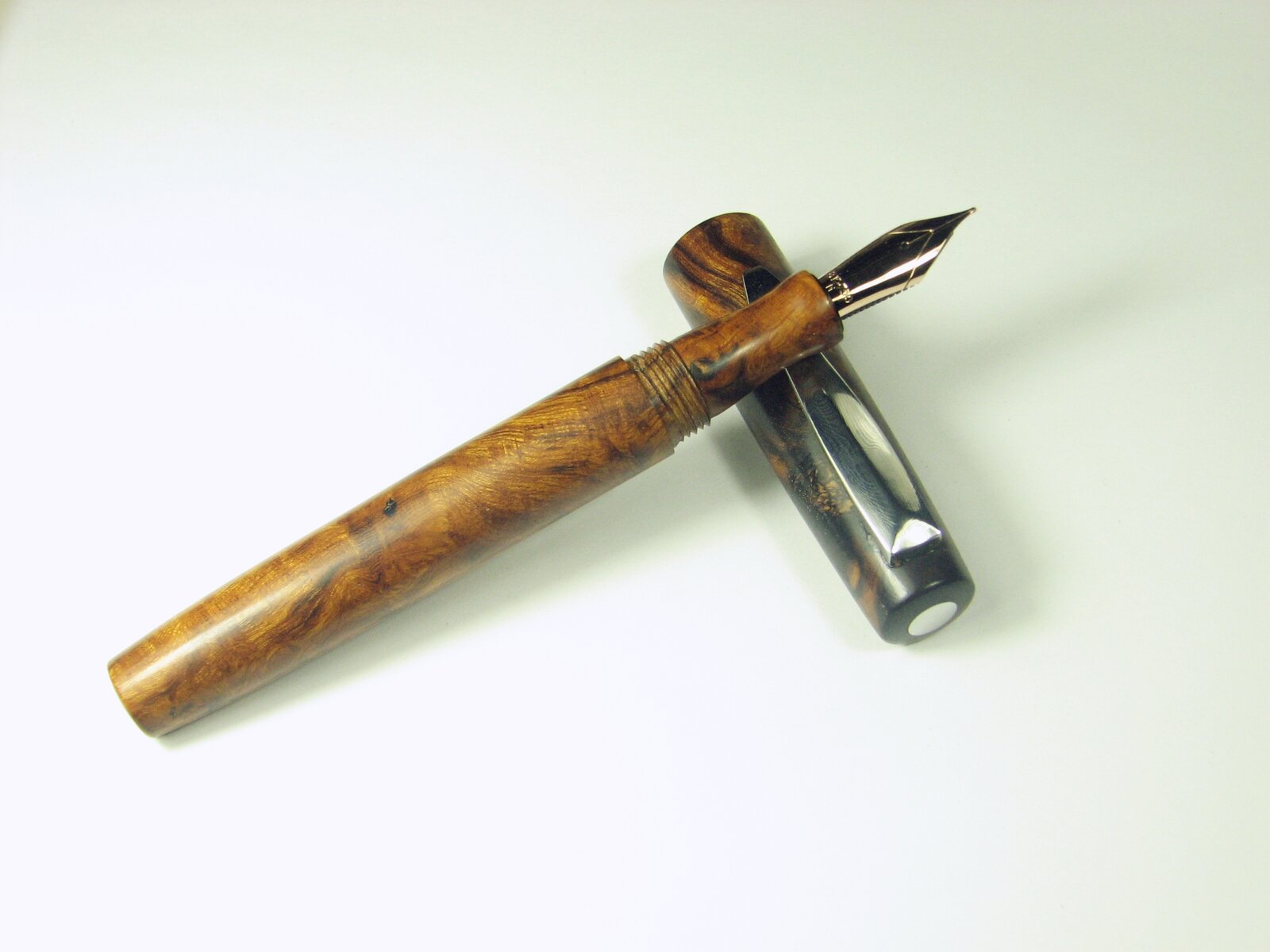

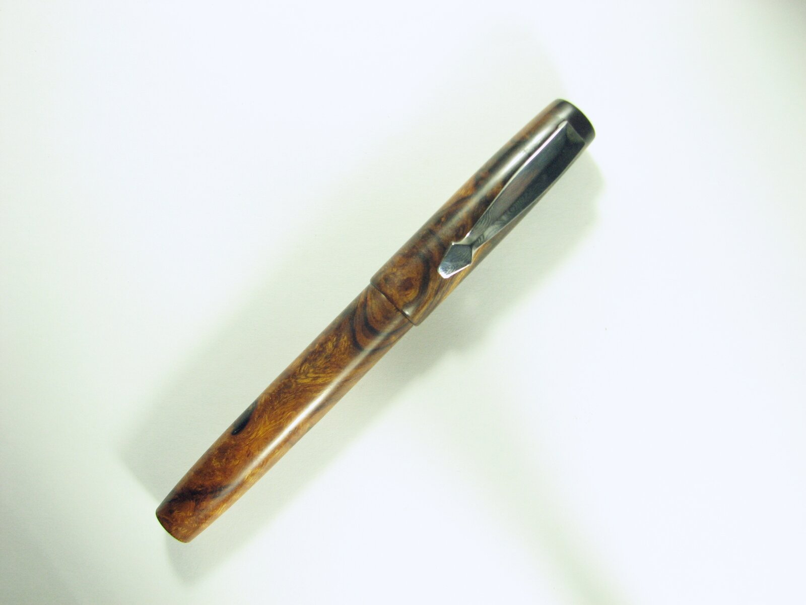

Hi everyone! I wanted to show my last pen, made from a wonderful DIW burl, with a Damascus clip. The guy wanted a 18K rose gold nib to fit some pink diamonds he has and which will be fitted at each end, on the steel dots. Cap is sleeved with acrylic. It is not that easy to take a good picture of Damascus steel...
Any Cc are welcome. Enjoy!

@Pierre---
Please can you tell us if you treat the wood in any way before cutting the threads . . . . any kind of stabilization treatment ?
Also, do you cut the threads using single-point threading techniques, or do you use taps and dies ?
Pierre---
Jun 10, 2012
415
France
@Pierre---
Sure.
Usually, I make a first cut a bit too shallow, then I coat the threads with thin CA, then make the last cut. Kind of stabilization I guess. I made test with and without, with is a bit better. It does not make miracles, but threads on weak woods are cleaner. Some woods like maple are threadable with this technique, and not really without.
Dies do not work on wood. I use a threading machine, same system as this one but smaller, with a 10 000 rpm engine.
