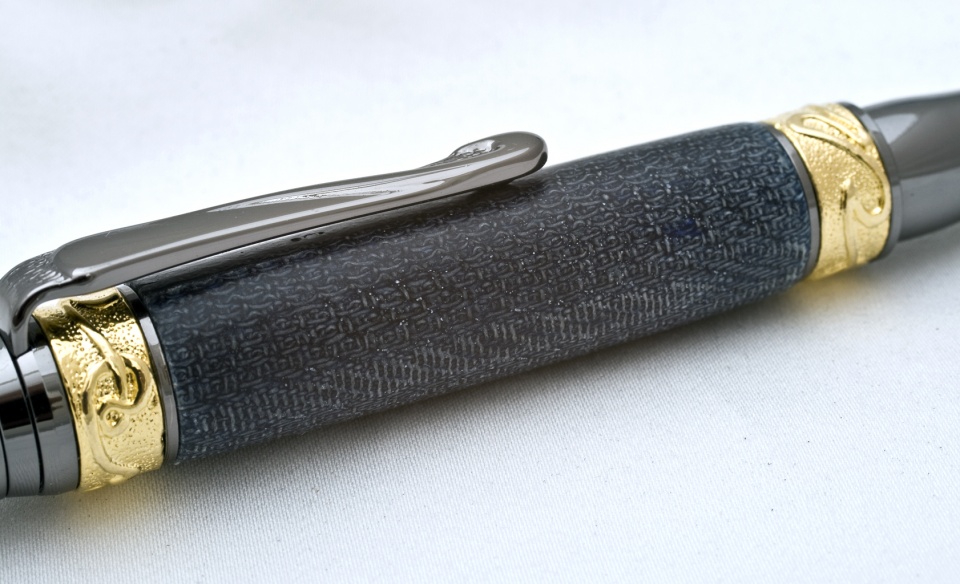

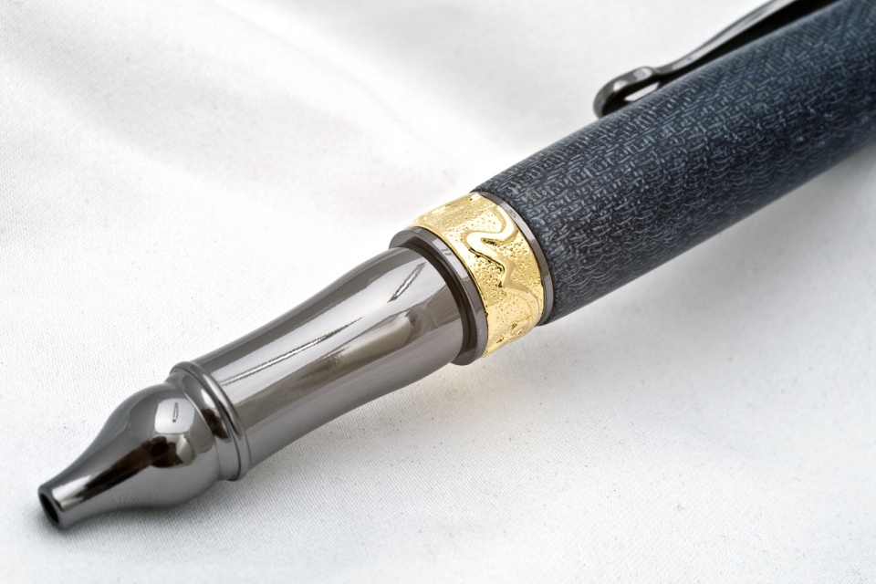

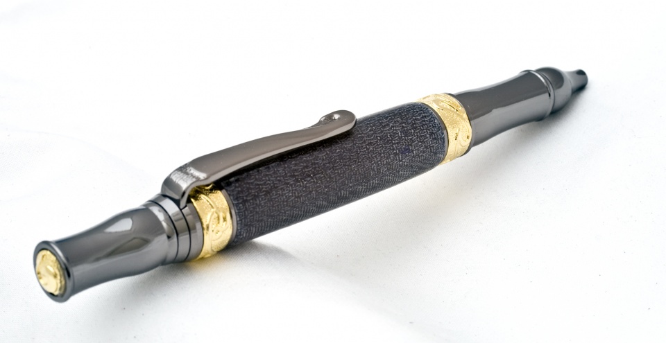

This is 50 layers per inch compressed denim in epoxy. I put it on a nouveau sceptre ball point in black titanium.
This block is 4th block of denim micarta that I have made recently. Have had some good results with the setup I am using.

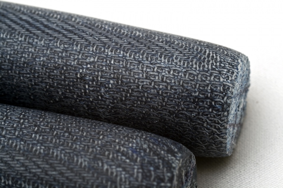

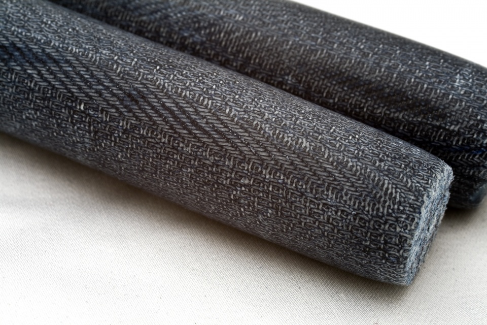

These are after some sanding on the rod.
attachment.php
attachment.php
attachment.php

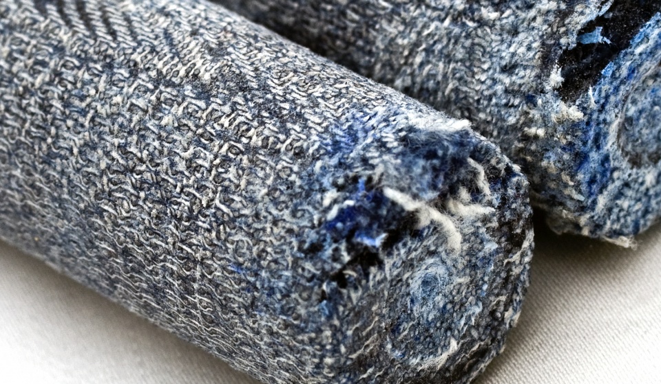

This is more raw from basic roughing.

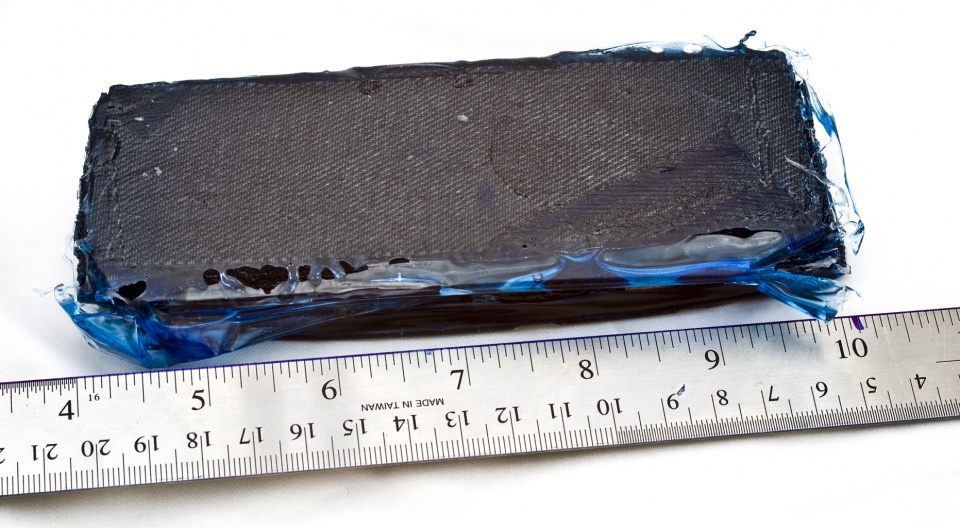

Negative on rolling. This is compression. 50 layers of 11 1/2 oz denim compressed to 1 inch. Standard brass tube from the kit.
Very cool nice looking pen. What type of finish are you using, it doesn't look like CA.
Mike
Not a CA finish by any stretch of the imagination. It is just pure denim and epoxy sanded and buffed. No need for a CA finish either. Most will tell you they like the feel of a rougher denim micarta over a glass smooth texture. You could do a CA finish I suppose but it's not needed.

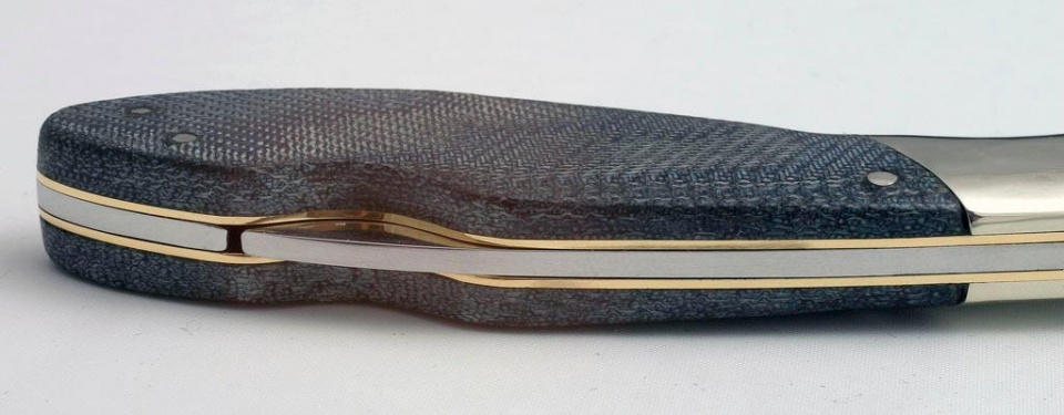

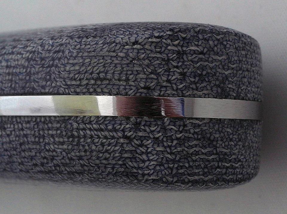

These are some other denim micarta projects that I have done in the past
attachment.php
attachment.php
The last image is the kitchen knife and about 15 layers.
