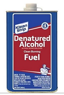

I few years ago, I was surprised could not find it at Home Depot & Lowes, read about the cali ban. but I was able to find it at an Ace Hardware. I just ran out again and found that Lowes now sells it labelled as "camping fuel".
I noticed this the last time I bought some DNA - the label no longer referred to it as a solvent, but said it was a fuel (although it was stocked in the paint department next to the lacquer thinner, turpentine, and other solvents). I asked the clerk at the cash register if there was anything different about it, and she looked at me like I had two heads.
I suspect this is just a label change to get around local sales restrictions. I know our colleagues in the UK have a problem getting 'methyllated spirits" (their name for DNA).
[California banned the sale of DNA starting January 1, 2019]
I suppose you could also use Everclear from the liquor store.
Amazon appears to sell it, and I couldn't find any mention of not shipping it to California. That said, they do note that it's not returnable because of HazMat shipping issues, which suggests that shipping from Amazon could also be problematic - probably ground shipment only which means slow and expensive.

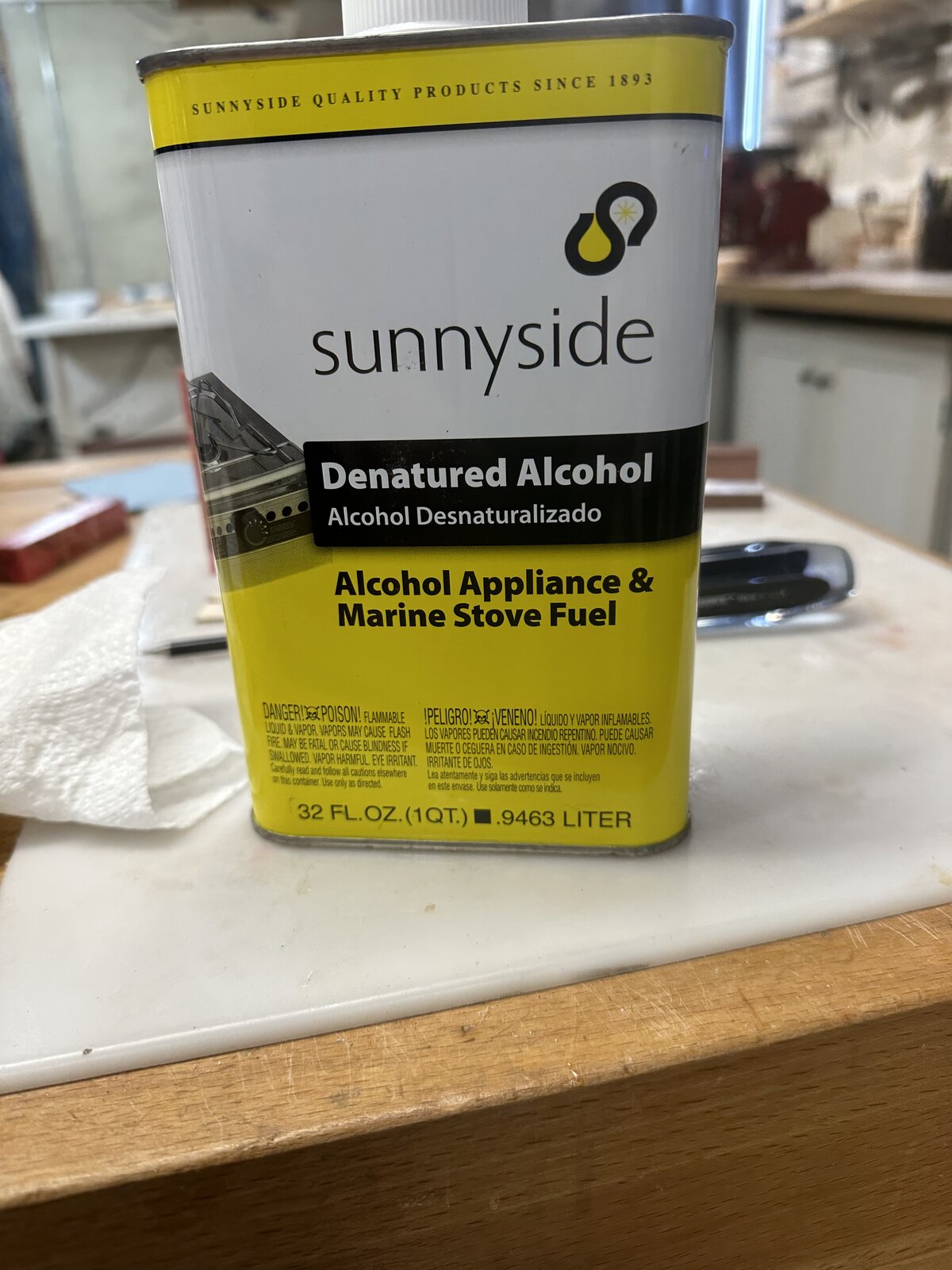

Our can looks just like this from Home Depot here in Texas. I think it's a workaround.
