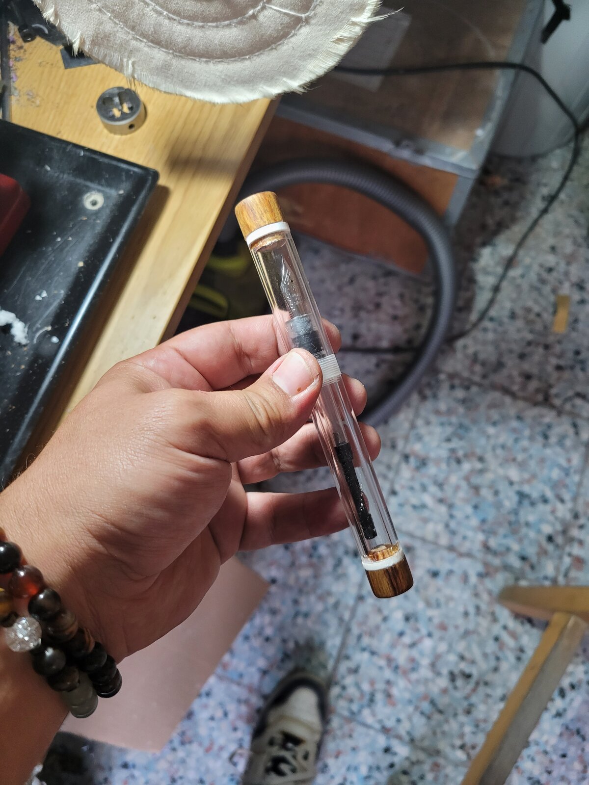

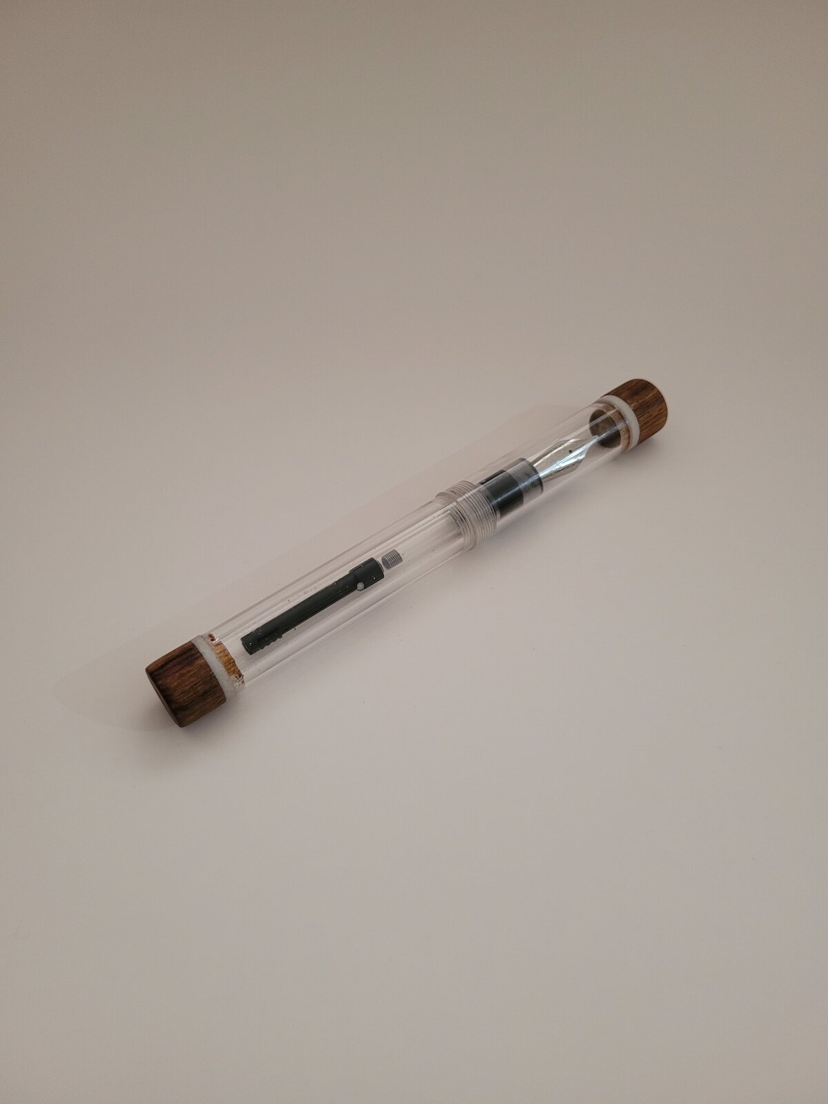

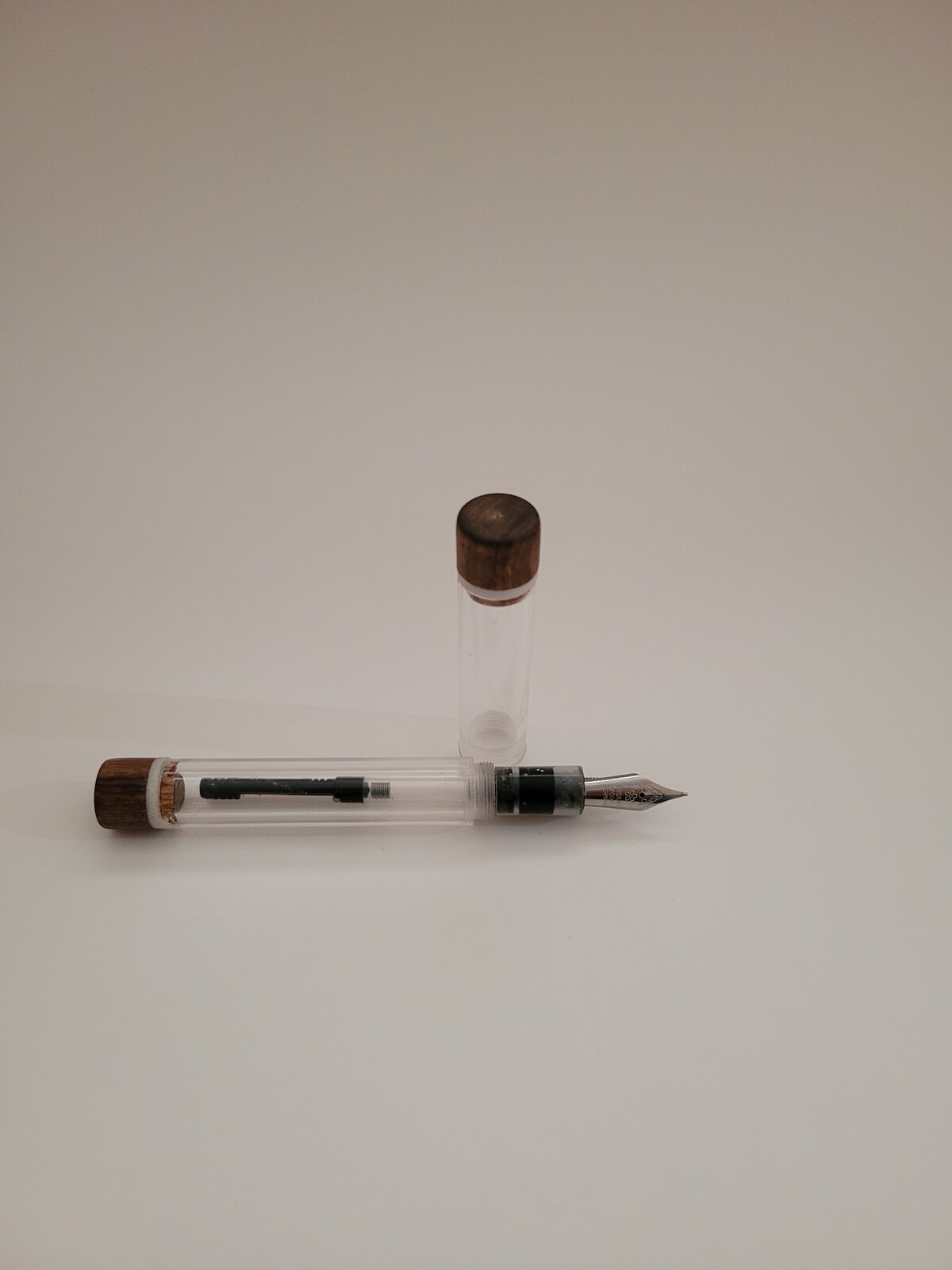

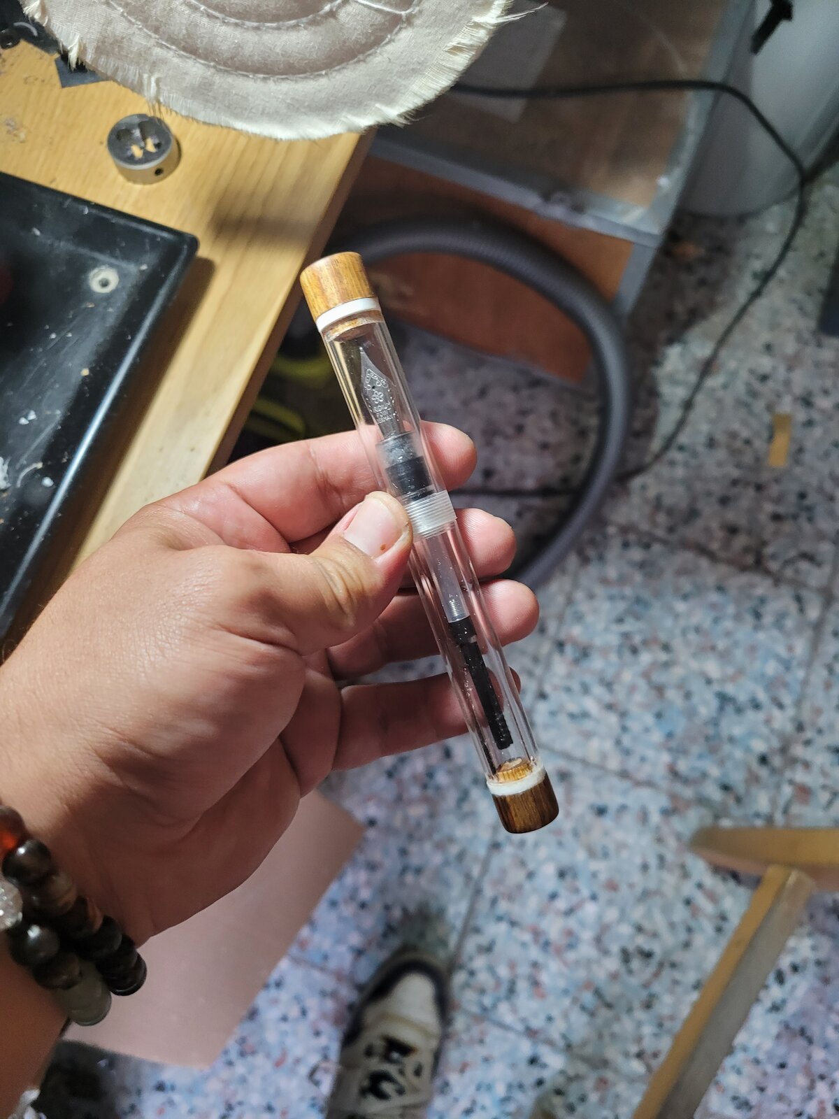

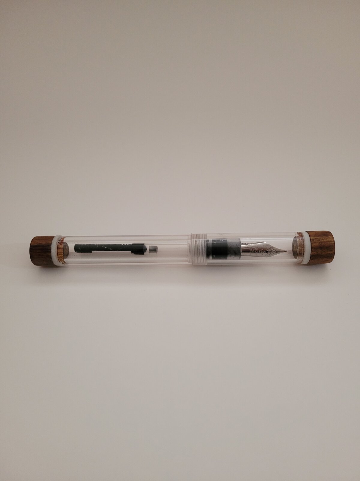

Hey all,
I tried a transparent pen. Hope you will like it.

Very NICE work!!
I tried dozens of times and never could get the inside scratch-free--CONGRATULATIONS!!
Yours looks superb!!
Ed
Me also :) I drove to İstanbul twice in two days because of it. I tried, tried and tried but it was not clean. Then I found another material as pipe, not stick. It was fitting perfectly to my design when I opened the threads. So I used them.
I would suggest making the tenons on the end of the acrylic, rather than the wood finials, and drilling the corresponding holes for the tenons into the finials. That way you don't end up with the overlapping materials and glue lines visible.
Brilliant
