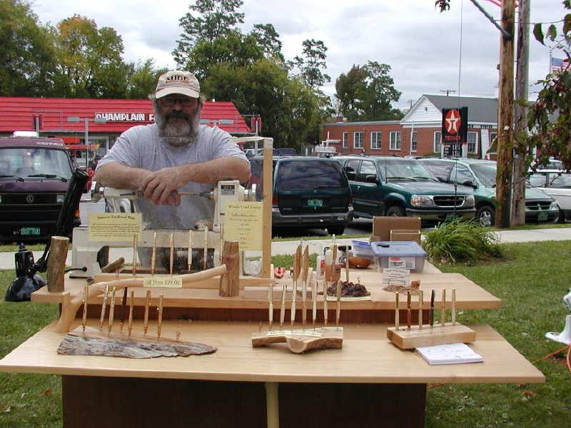

When I set at shows I only turn, I put my pens together at night. I can get more done that way. Turn woods that does not dull your gouge so quickly. I take 20 sets of blanks per day. Have a piece of plex glass in front of your lathe. It takes me about 30 minutes to setup and start turning. Take a couple of writing pads for test runs. I have older pens for that, Ive had to many kids with sticky hands grabing all my pens and I stop them in there tracks and say to use the pen on the pag. I caught one kid with my nicest pen in his mouth. Have wood with a story. Have something for people to read to make them smile about your work. When they smile they buy.

Thanks again for your input!! I really like your "pen holders" and general approach. Many of these ideas will be incorporated. The "test pad" is an idea I have used for years in my indoor display and, I agree, it keeps MOST of your pens from getting "crudded up". I am attempting to build it into the new outdoor demo design-developing slowly but surely.
