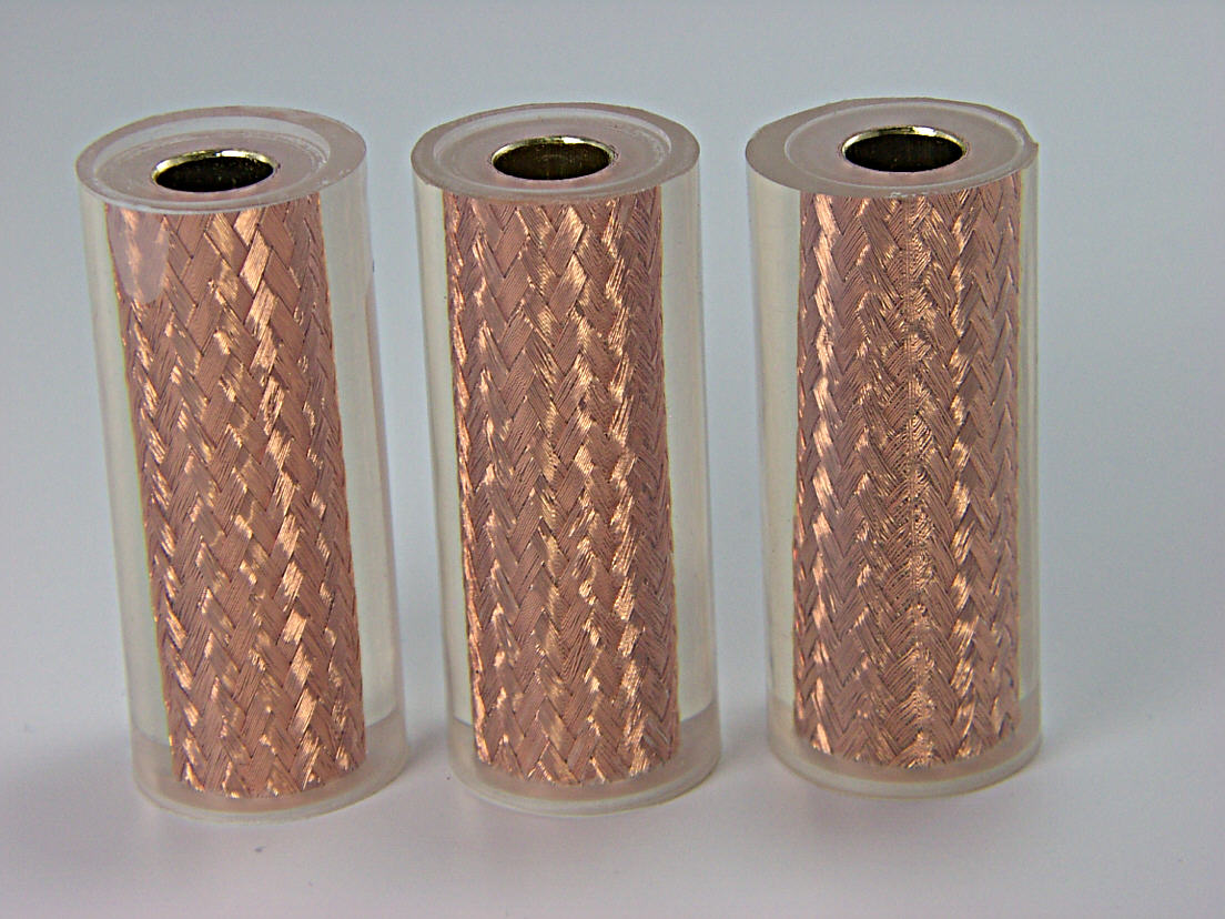

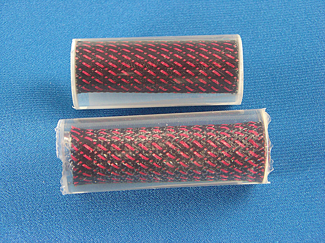

I keep them in tank over night. Then sometime the next day I take out and if I want I can put more in. I do not pay attention to times. I know a whole night which is at least 12 to 14 hours will fine. I do not demold untill I need them. I cast in plastic tubes so there is no sticky stuff to worry about. At times I may stick in toaster oven for a few minutes to make sure they are cured if I am in a hurry to turn. But usually never in a hurry any more these days. Here is what they look like after I take the silicone stopper out and the copper ones were flushed trimmed. Now they all are never perfect. The 2 red copper and black ones, the top one is perfect and the one under it went haywire. Same pot. Same pour, Same everything. Just one of those things. It happens. Hand made stuff. Things happen.
