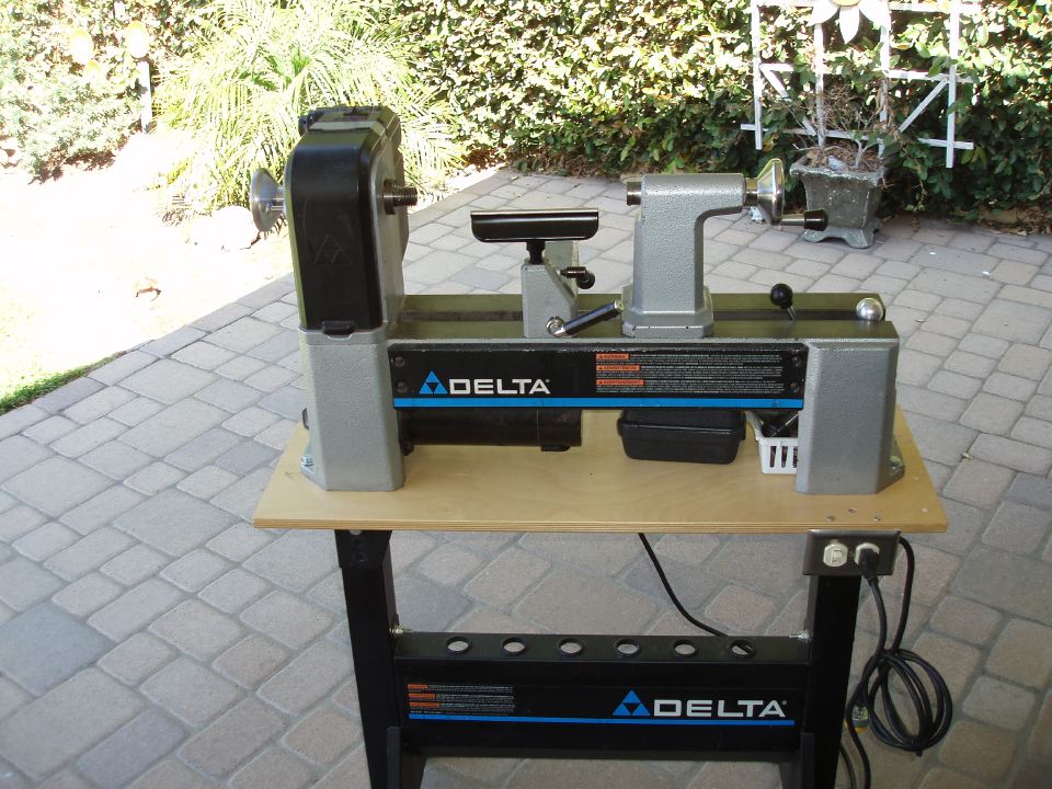

The switches on my Delta 46-460 can get finicky at times. It still works, but they have a reputation for issues. The previous owner had installed a separate, reliable switch in a more convenient place, and I use it all the time. See the lower right corner, under the shelf. It is simple and effective.
