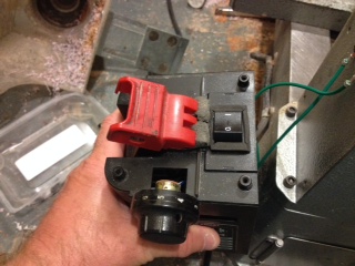

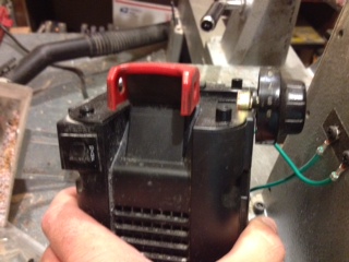

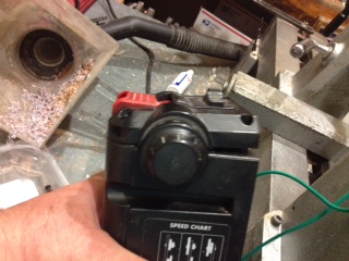

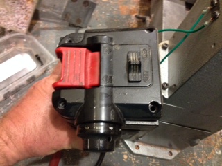

I'm pretty sure I have a Type 1. What do you think?

Mike, it's hard to tell from your photos. That looks like a rocker on top. Can you pop it out and pull the wires off the tabs? Then, it comes apart to expose those copper contacts. A good inexpensive place to start. But, forgive me IF I'm wrong.
Mike, that's the 1st version (same as mine). From what I remember reading, the switch is upgradable to the newer model. I've had a few times where the lathe would hesitate before starting. I'm probably looking at a switch replacement myself down the road. (Hopefully just the switch).
