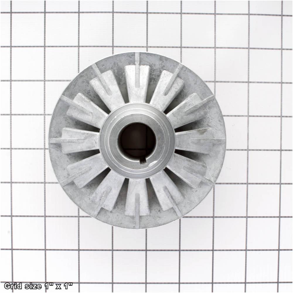

Hey there! I have a Delta 1440 with a problem. The internal pulley has broken and cannot be repaired. I believe the part # is 5140061-87, but all of the parts are discontinued as this lathe is pretty old. It was given to me by a friend and I'd like to keep using it. Reaching out here to see if anyone would have any leads on parts or any suggestions. Thanks!

It looks like you have a Reeves drive, if so I can't make you one for $52.
Here is a Grizzly that might work...
I couldn't find a dimensioned drawing so I can't guarantee it will fit but it's somewhere to start.
Here's the link to a forum discussion about your lathe...

BOOM! Thank you so much! I'll order this pulley and give 'er a go!
