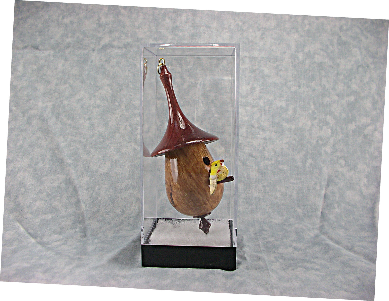

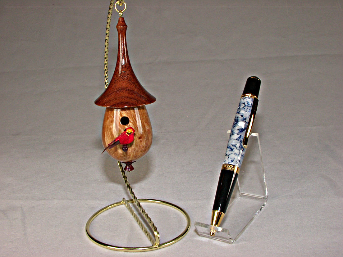

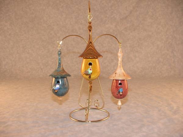

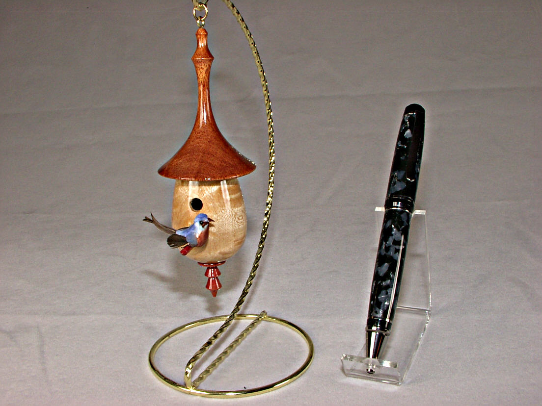

Here is one of those projects I have made alot of over the years and still on occassion. These small birdhouse ornaments are made from various woods but are all finished in Deft gloss lacquer from rattle cans. I spray them outside because the fumes are toxic when sprayed alot. Never have I sprayed at 12" away. I never measured but would say it is from 6" to 8" away. Each coat is applied so that it is completely wet and no orange peel from lack of product. each coat is dry to touch when next coat is applied. All coats are applied same day and no down time between. They are done in the shade on a low humidity day. No other polishing is needed after they dry and cure for a few days. when smell disappears they are cured. Any small project like this is done the same way with Deft. As I said I also used Watco with same success. After awhile you get a feel for the spray can. Now I have sprayed other projects with waterbase lacquer but for that I use a HVLP spray gun. Now that I probably stay about 12" from because the spray is a greater circumference even choked down. But again it is a feel thing and you see what is happening with your eyes and recognize it. Good luck. By the way one coat of dewaxed shellac under all.
Here is one of those projects I have made alot of over the years and still on occassion. These small birdhouse ornaments are made from various woods but are all finished in Deft gloss lacquer from rattle cans. I spray them outside because the fumes are toxic when sprayed alot. Never have I sprayed at 12" away. I never measured but would say it is from 6" to 8" away. Each coat is applied so that it is completely wet and no orange peel from lack of product. each coat is dry to touch when next coat is applied. All coats are applied same day and no down time between. They are done in the shade on a low humidity day. No other polishing is needed after they dry and cure for a few days. when smell disappears they are cured. Any small project like this is done the same way with Deft. As I said I also used Watco with same success. After awhile you get a feel for the spray can. Now I have sprayed other projects with waterbase lacquer but for that I use a HVLP spray gun. Now that I probably stay about 12" from because the spray is a greater circumference even choked down. But again it is a feel thing and you see what is happening with your eyes and recognize it. Good luck. By the way one coat of dewaxed shellac under all.View attachment 374871View attachment 374872
Thanks, John!
Love the birdhouses! I've been making a few of those. Mine are not as nice as yours, though. Love the little birds. The lacquer does look great on them.
