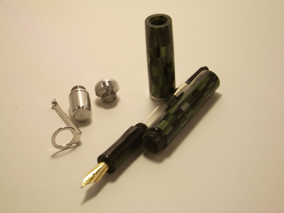

A functioning pen made from parts you've turned or created yourself, rather than the parts you buy in a kit.
It means different things to different people. Some call it kitless if the only purchased components are the "nib/feed/housing" unit, the ink delivery mechanism, and the clip. Others exclude the clip.
A true "Kitless" requires making all metal pen components with the exception of the ink refill and fountain pen nib.
So far nobody has told me that the pens I make with a purchased clip are "not true kitless" pens (which is lucky, or my entry in last year's bash would have been disqualified.)

I'd consider a ballpoint pen kitless if it used a clicker mechanism or transmission which is screwed into threads the maker cut herself/himself (in other words, not into a press-fit coupler like the ones in kits). I wouldn't expect the springs to be homemade, but I think the nose cone should be.
Rollerballs are usually built along similar lines to a fountain pen -- and again, I'd expect the nose cone to be home-made.
YMMV, IMHO, JM2C, etc.
