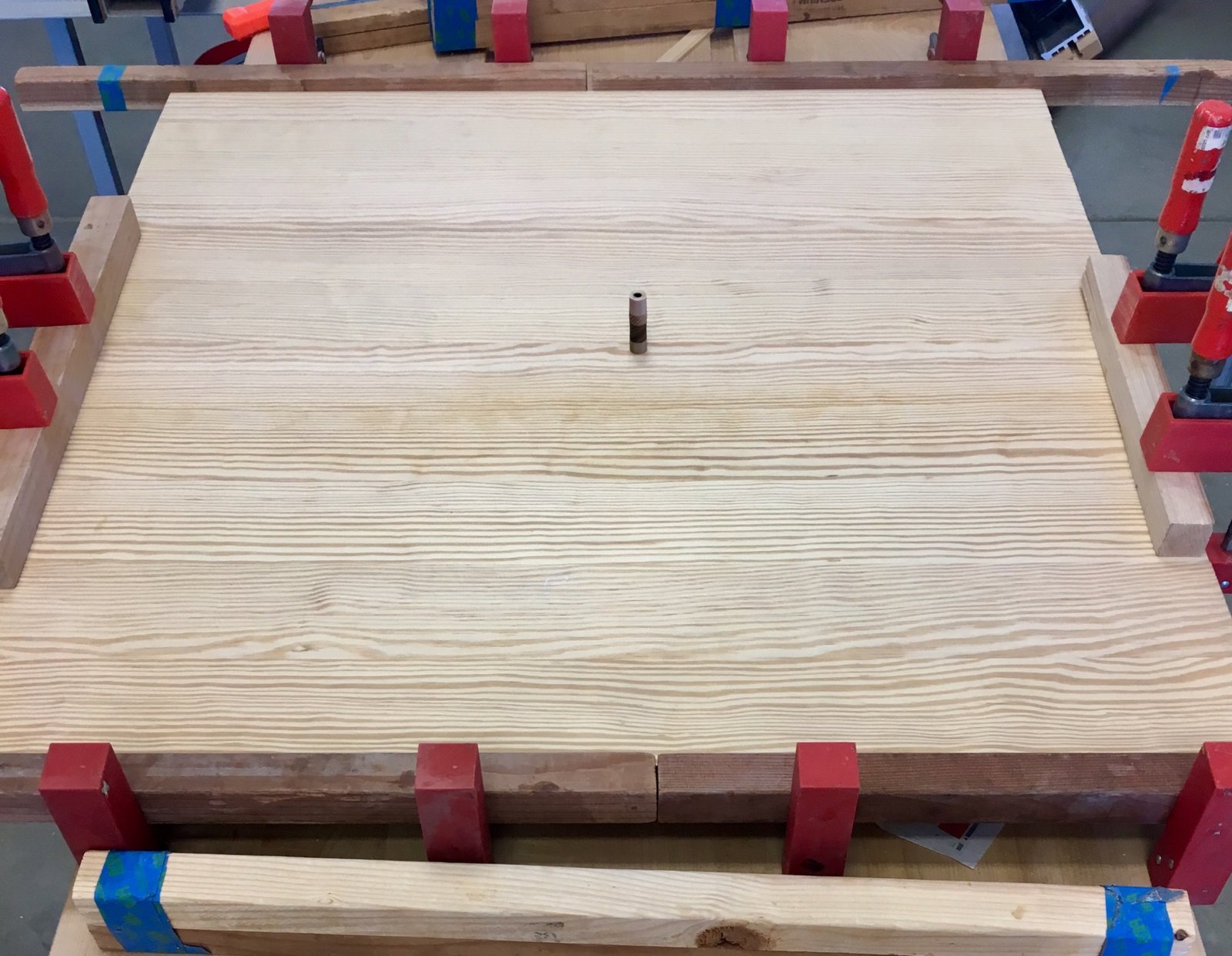

This is a yellow pine table top for a 36" square cafe table for our den/bar. Those are my biggest clamps. It started out as ten 1x4" boards. After gluing up each half I drum sanded them flat and now I have joined them as one top. It will be glued to a 36" square Baltic birch base. Later trim will hide the sandwich.
The tiny object in the center is a partially turned Saturn pen body for scale.

Great work! in joining the individual did you use anything else besides glue - dominos. dowels, biscuits, Kreg screws?
Long grain to long grain with smooth surfaces told me that glue and clamps would be sufficient. The entire pine panel will be glued to the stable plywood too. It is not going anywhere.

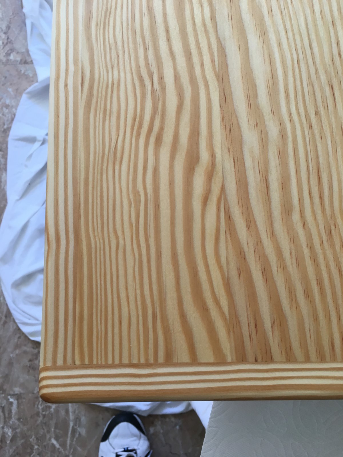

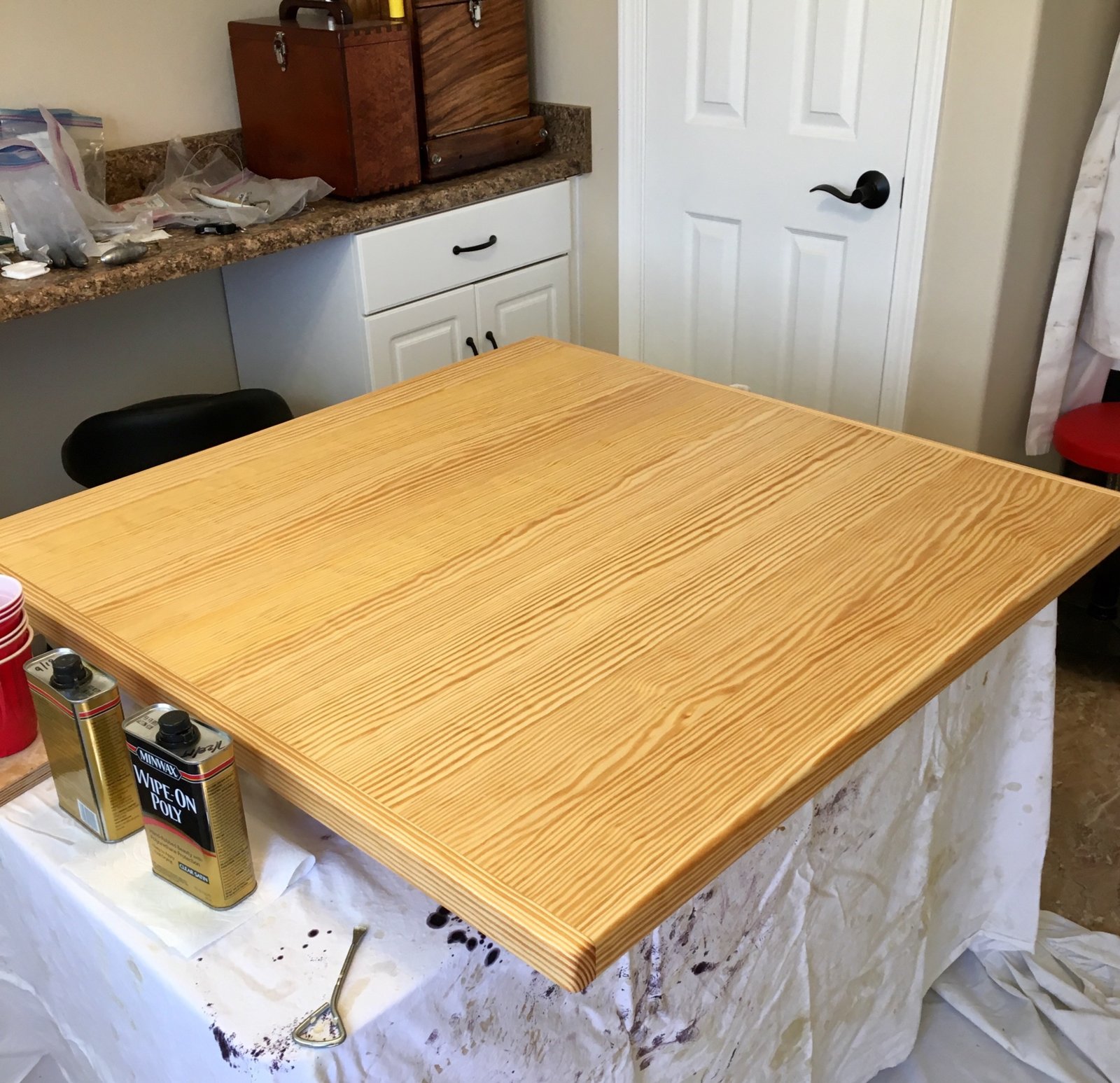

My "doomed" project is in the finishing stage. After four coats of Wipe On poly I'll attach it to the base. I still have hope. All joints are as tight as I can make them.

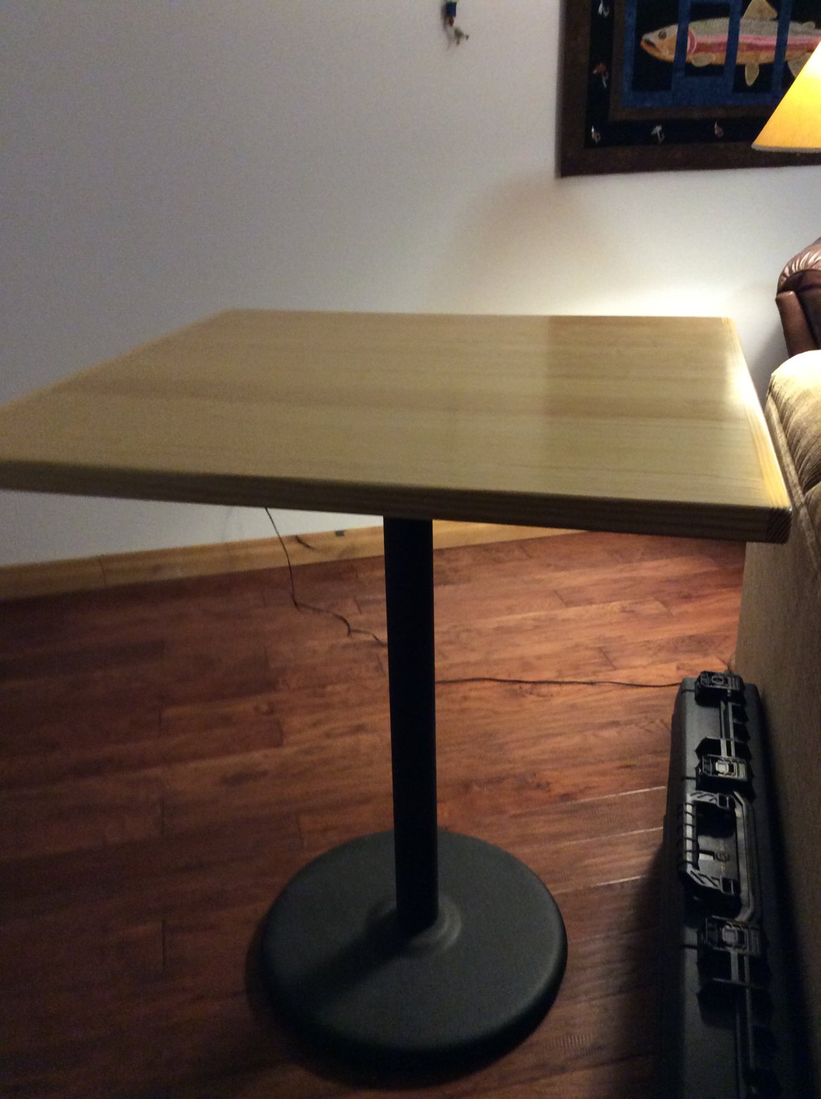

Well, it made it to the finish line. The top is just over 1-1/2" thick and 37" square. Right now it is flat as tested with a very thick stainless engineering rule. Time will tell...
Tall bar stools are being made and will be here soon. Let the football games begin and bring out some beers.

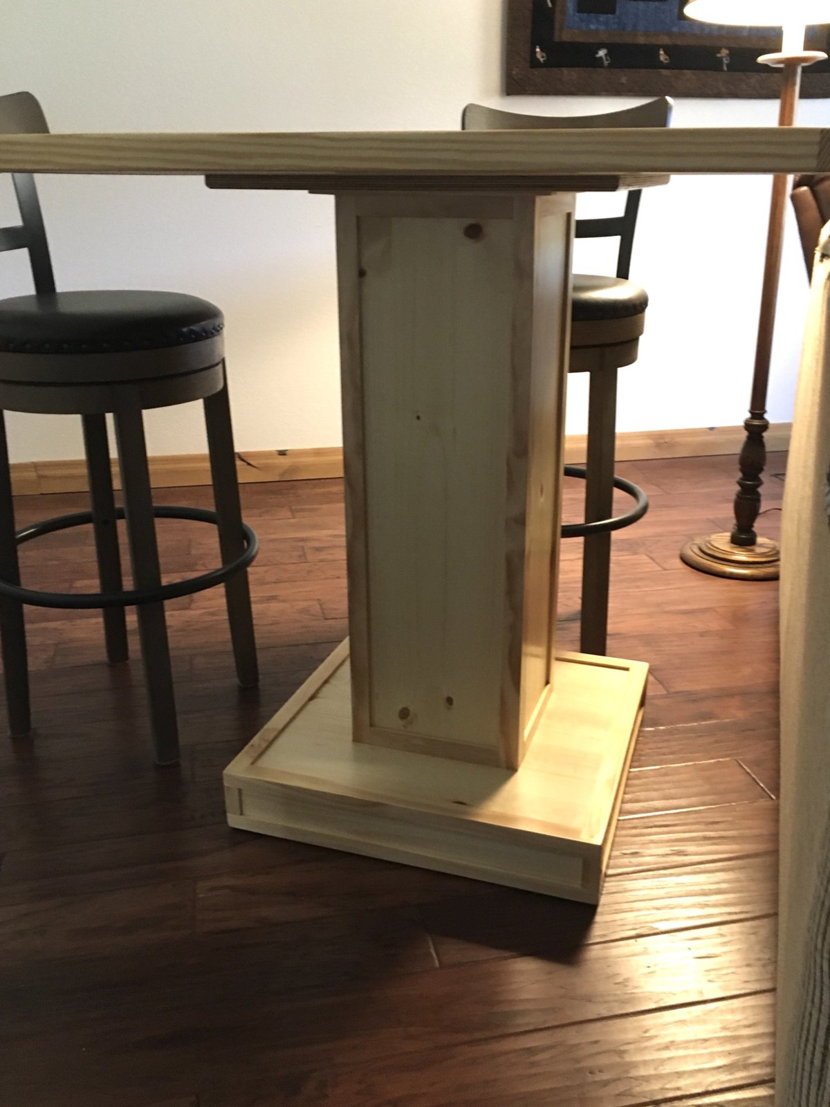

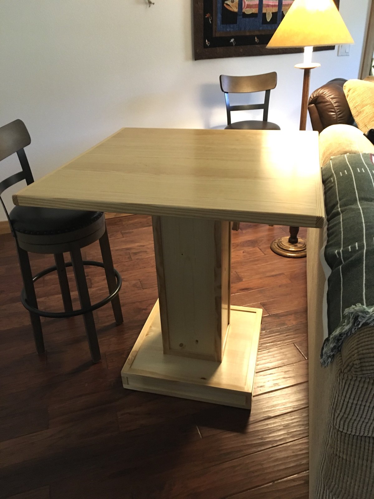

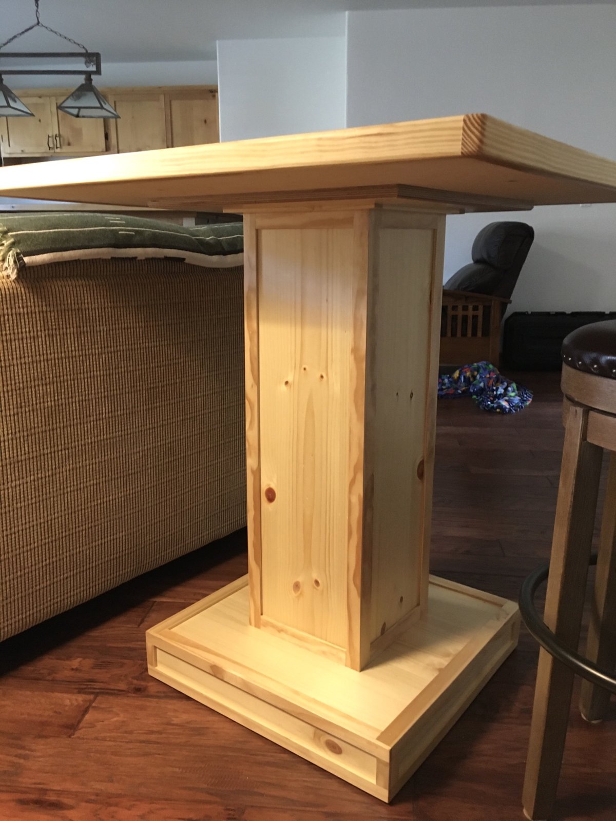

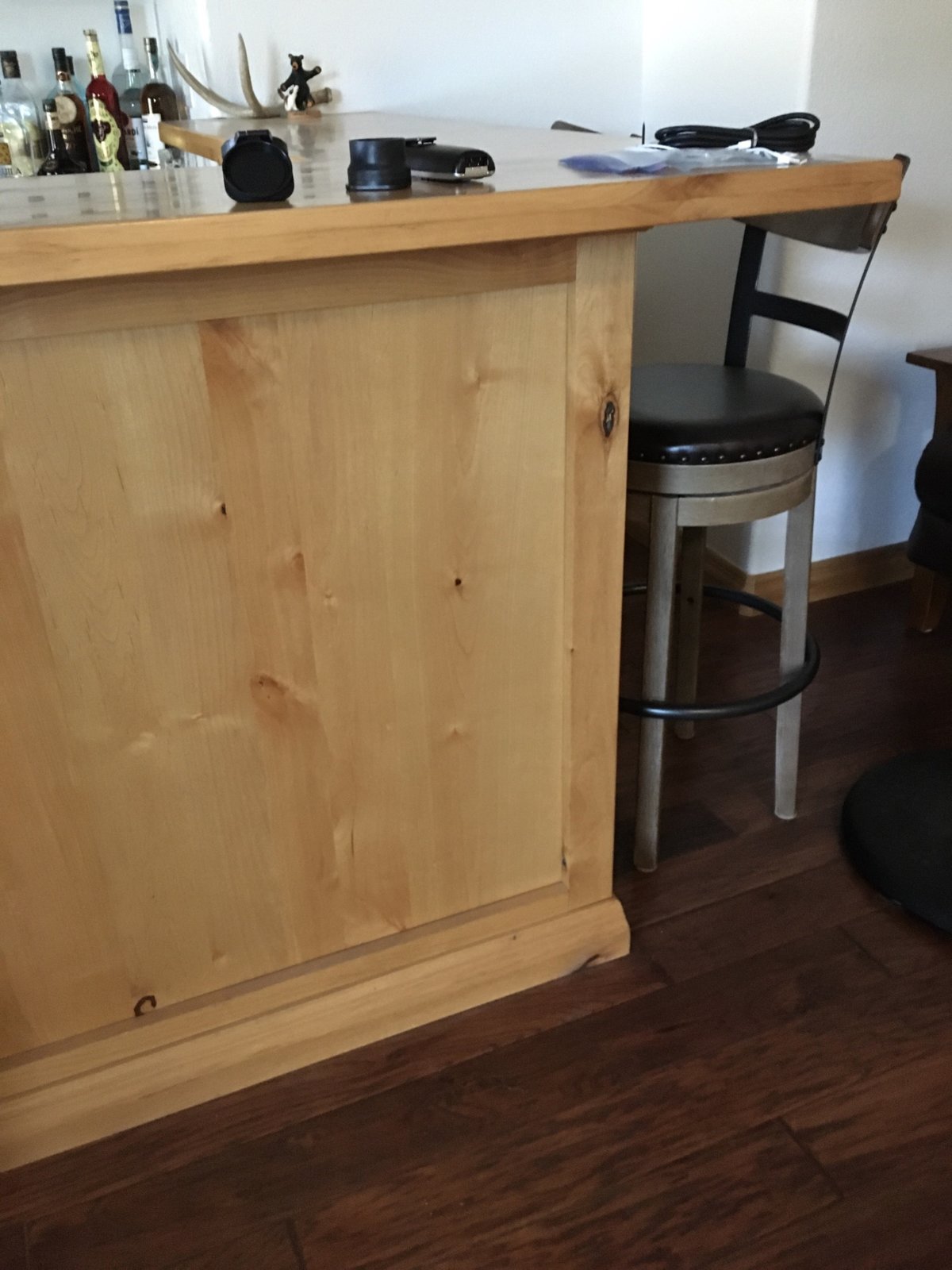

The top has yet to warp, but it has a new base to match the the existing bar/den woodwork. Add some time and the pine will match.

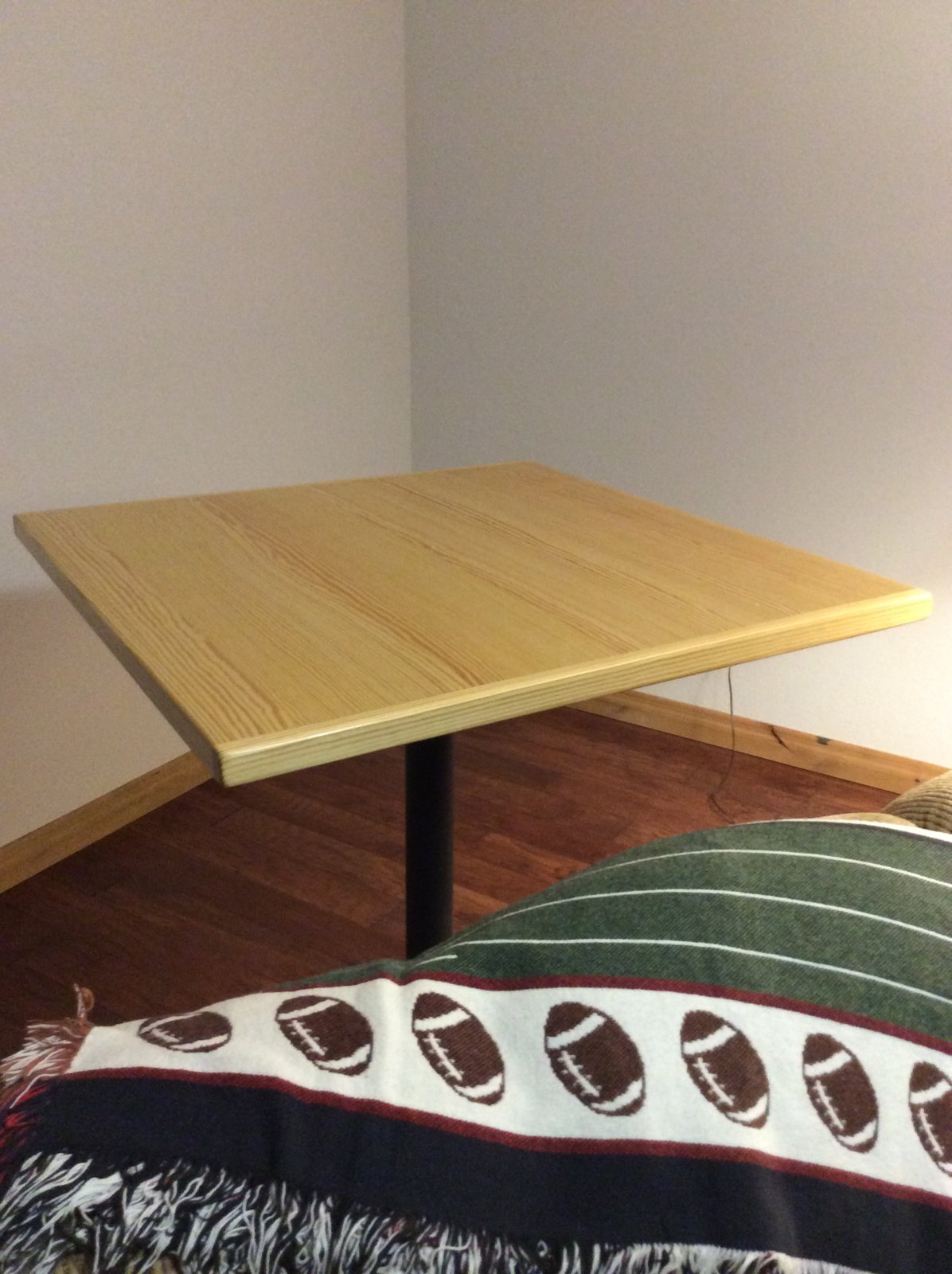

The table was nice and flat yesterday as we (Trojan family) watched USC beat Ohio. At seven years it is not going anywhere…
The key to me was excellent Baltic birch base in one direction and the pine top 90 degrees from that. The thick edges did not hurt either.
