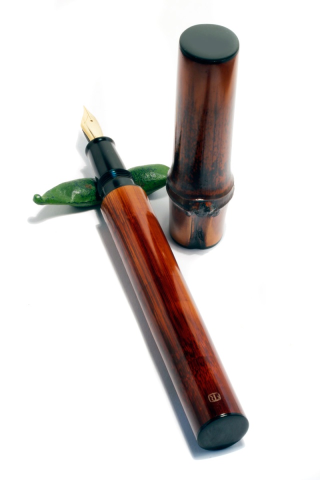

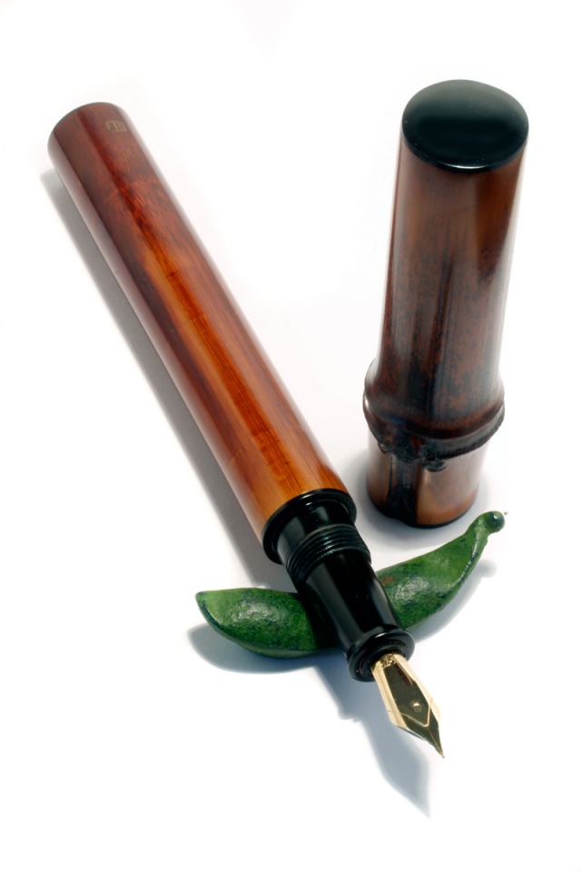

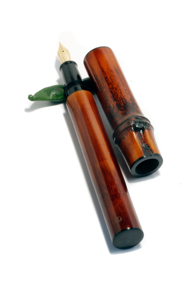

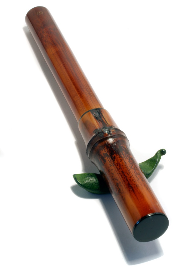

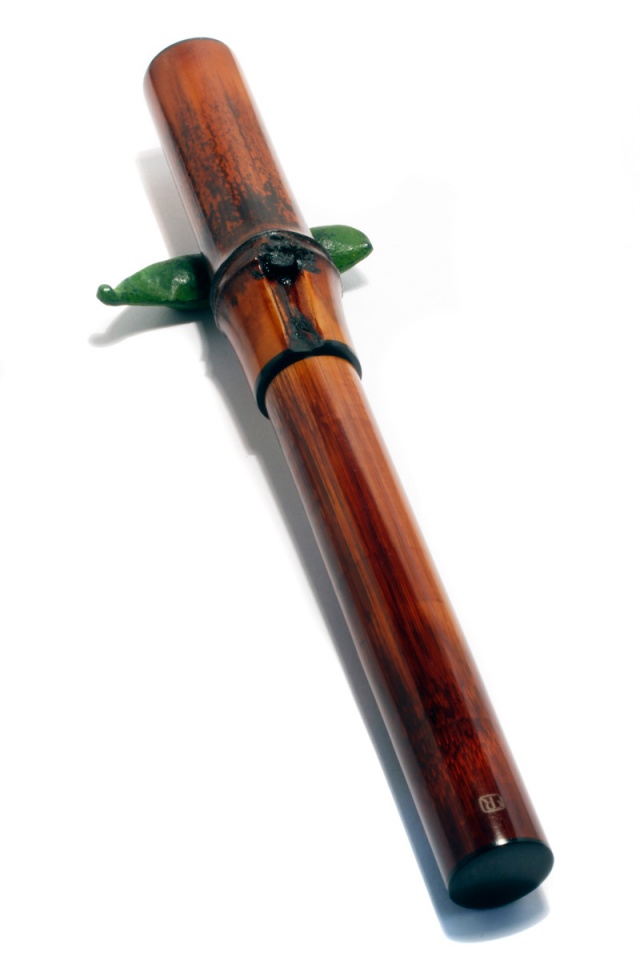

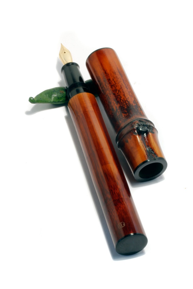

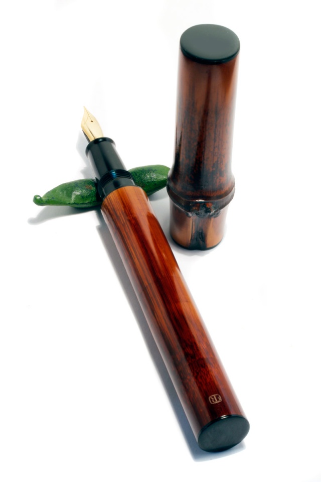

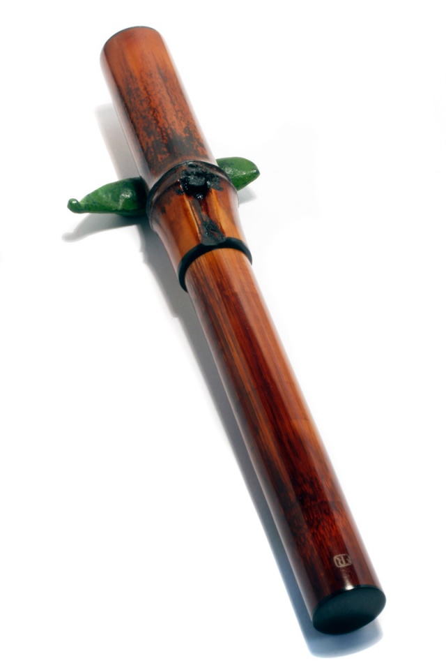

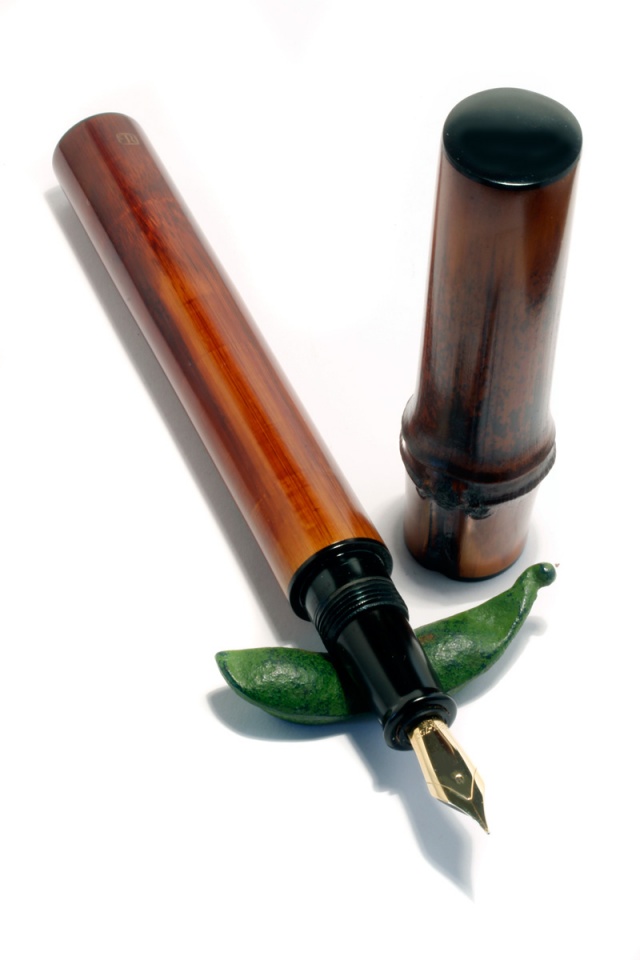

This week I felt like playing around with some bamboo pieces.
It is a pretty large bamboo pen. Section and end pieces made from ebonite. Finish "fuki-urushi" rubbing ki-urushi into the surface.
Best,
Martin

The surface is "sealed" and toned with raw urushi "ki-urushi" lacquer, a process known as "fuki-urushi" in which raw urushi "ki-urushi" is rubbed into the surface, wiped off completely with paper and dried for 24 hours in the "furô", a cabinet with a constant temperature of around 25°C and a relative humidity of 75% to 80%. This process is repeated 6 to 10 times
