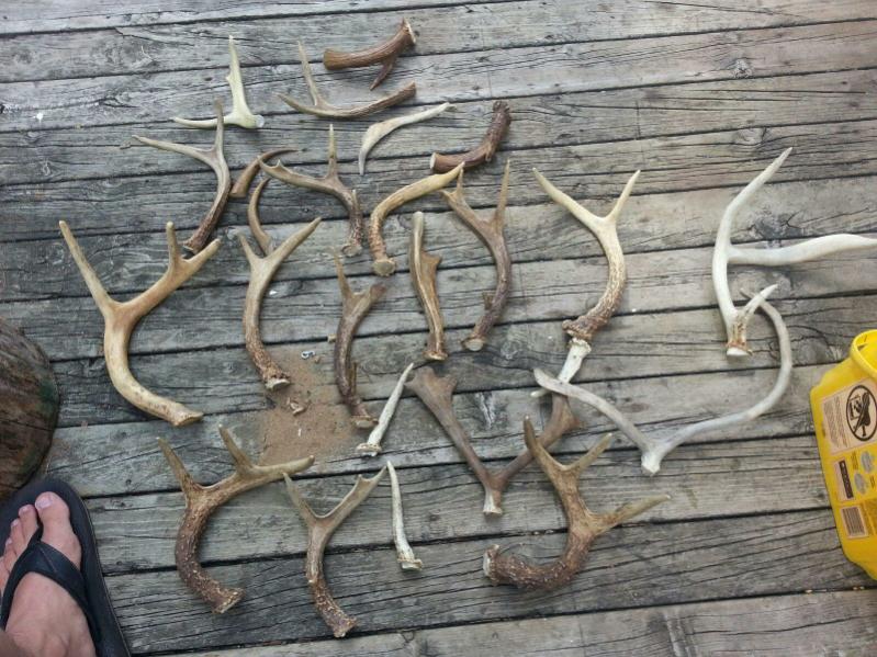

I was offered a bucket of deer antlers from a co worker. He said he will sell me the lot for $35. I have t seen them in person yet but I have this pic for now. Is there anything I should be looking for or asking about before buying these? Any advice would be helpful. Thank you.

I would make sure they are not old which these in the picture do not. Also I find it difficult to use the upper points for pens especially when they get flat. I have been told that you can boil them and straighten the curved sections out but I have never tried it. I am afraid the wife would not be smiling if she found me boiling deer antlers on the kitchen stove. So you should scan over them and try to picture just how much usable material there is. I have been limited to using the base sections for most of my pens. The larger the kits that you use the better the result in my opinion since you do not have to turn so much of the character of the piece away. I do use some of the points and smaller curved sections for key chains. In saying all of this though I must say I have never had to pay money for antlers. I have always had someone offer a few here and there. I normally will in turn make them a key chain or pen but no money has changed hands. If there is a hunting club in your area you can probably get hooked up with an adequate supply for free. Most hunters only keep the trophy racks and discard the rest. Not sure if any of this helps but I hope so.
Look for straight pieces to turn and cracks. Deer antlers are great to turn. I just bought a 55 gallon drum of horns. I have been thinking about cutting them up and selling blanks. Anyone interested?
If you are careful, it looks like there are 25-35 single blanks, so that's about a buck a blank. I shoot all of mine or collect sheds, but that looks like a good deal if you can't. The one looks old and those can be difficult. The rest look good. I say go for it.

I was looking at the foot in the picture and comparing it the board widths. I would think the boards are 1x4's or so meaning they're 3.5 inches wide.
Taking this against the antlers, it would appear you have smaller antlers which result in the usable pieces being about 2-3 inches long for many of the straighter sections.
You'll get several pieces you can use for pens from these if the diameter holds up.
You should get at least 5-6 usable sierra style pens from these. You could sell them for $45-50 each meaning your $25 investment is worth it.

I wouldn't hesitate or negotiate. I would simply say, here's your money when can I get them. In my opinion, the number of "Useable" blanks posted here are way off the mark.
