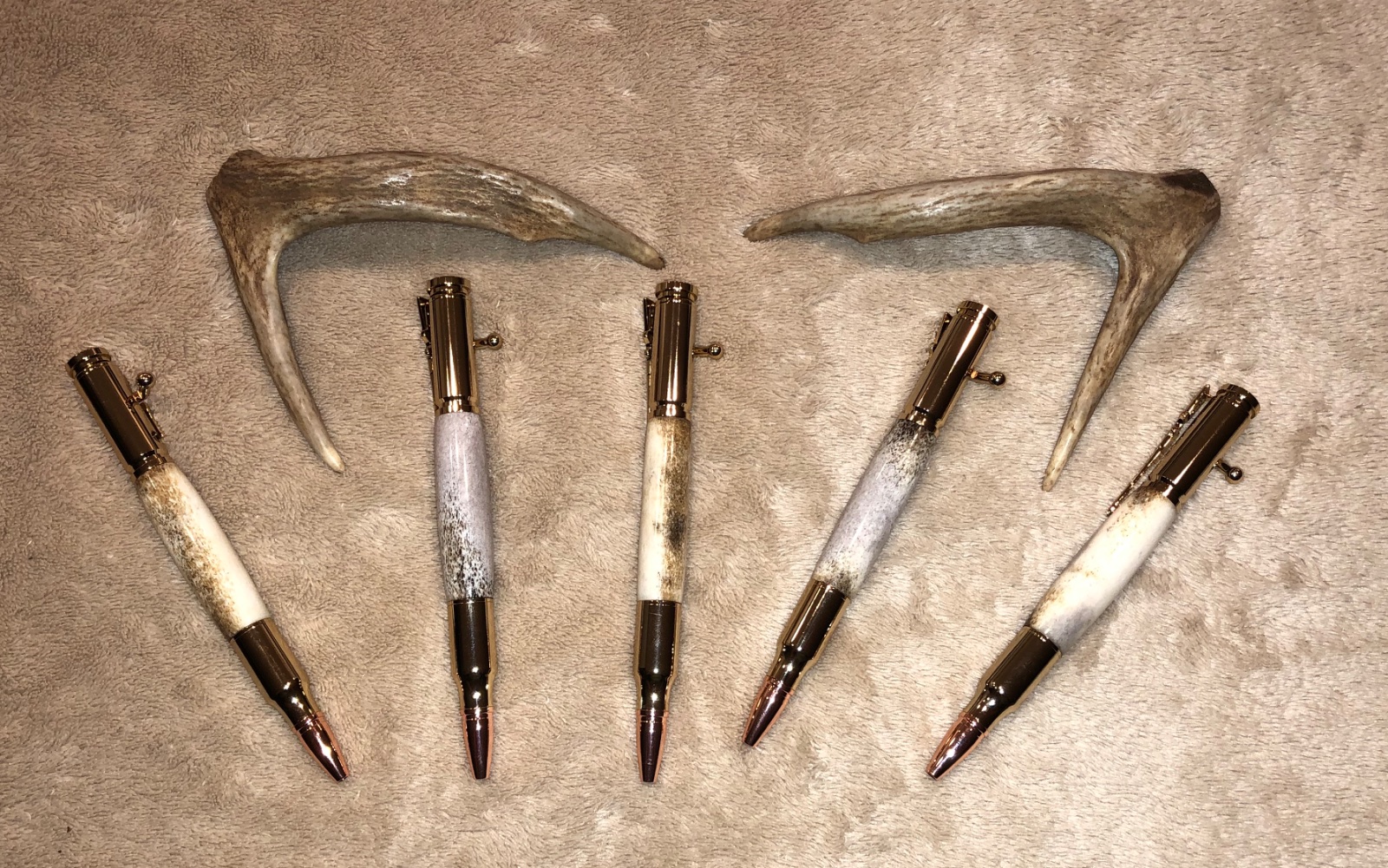

Deer Antler?
Here are some I did a few years ago.

Mortalis, thanks for the information. I have a piece of antler but pondering how to cut it as it is curved. Maybe cut small pieces for segmenting?
Very nice looking pens.
