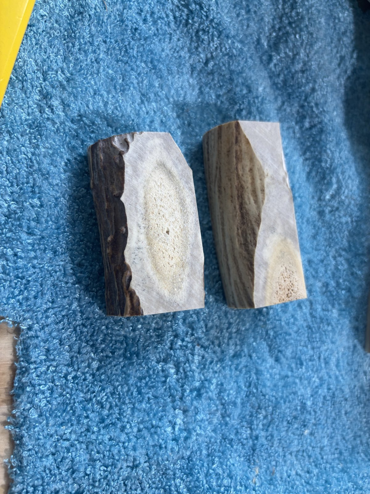

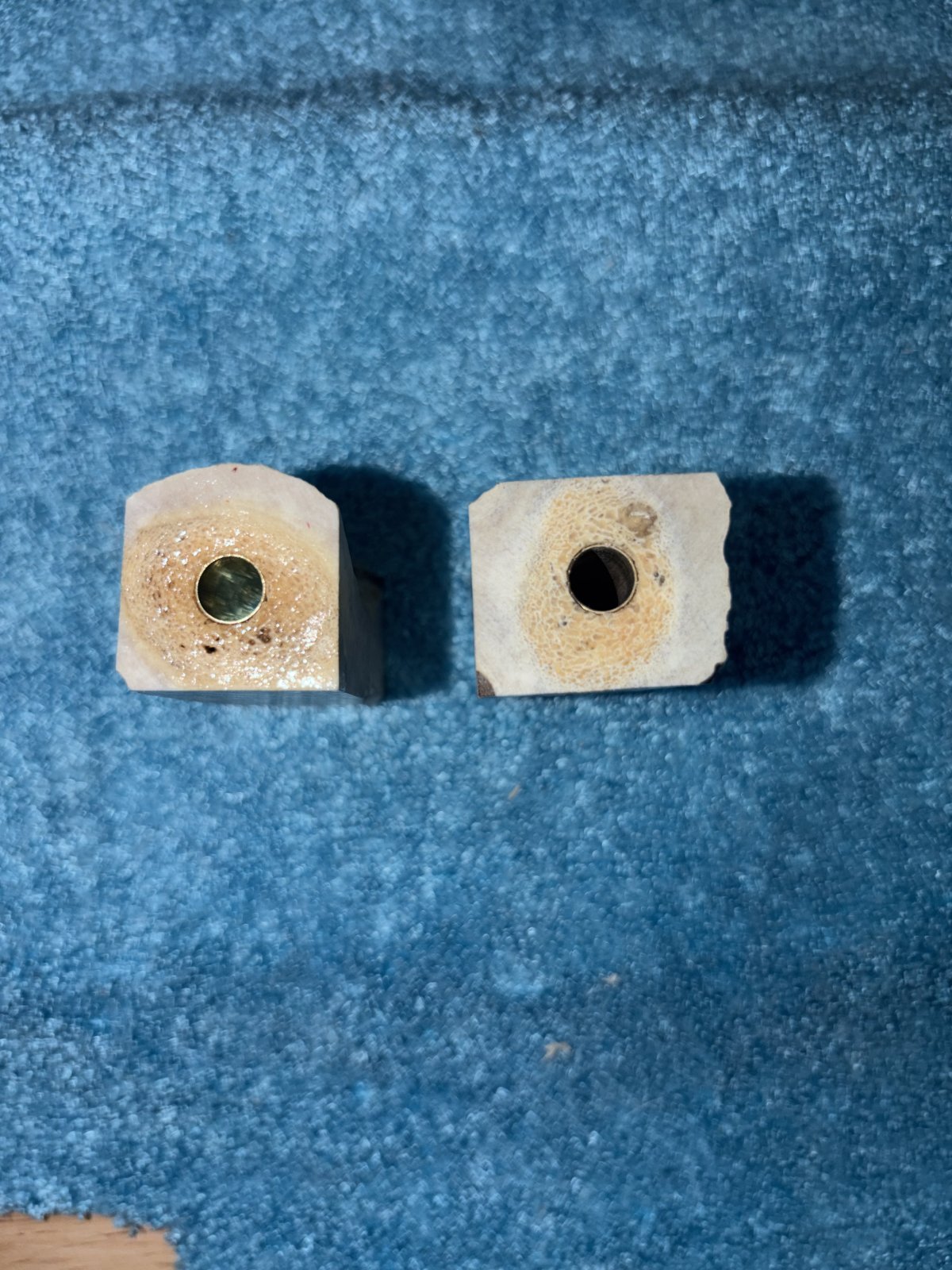

Made some antler blanks today and wondered if these will turn well? With the pitted inner area looking like it will be in the cutting zone, do you think these will work out? I epoxied the tubes in.
Wondering if these will explode?
I've done quite a bit of antler in the past. Thin CA is your friend here. It will firm up the pith as you turn it to size. Take your time, wear a respirator and have fun.
So if I understand you correctly, I will CA now, turn a little and CA again as I approach the size I want? Thank you!
Also Rob, any tips on picking a spot on the antler for best pieces? One was from the base of the shed and the other was from a tine. I thought the tine would have less pith.

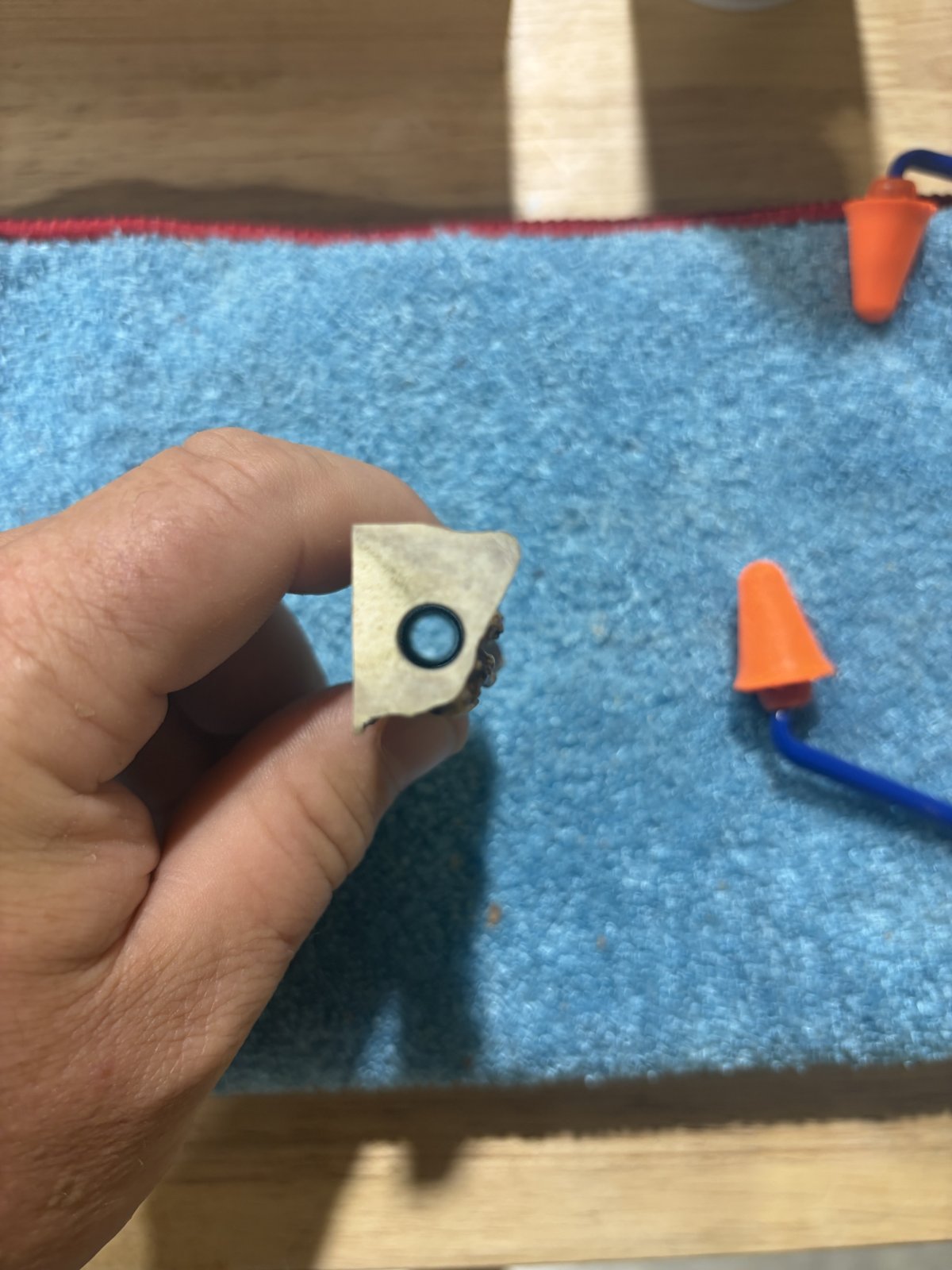

Mark I do want to use your technique to hopefully retain some of the bark sometime. I did buy those rubber gripped vise grips to use like you are doing. With these pieces I chose to square them on my table saw and put them in blank jaws for easy center drilling. I was surprised to see how much of the marrow area showed up. I feel like the outcome will not be as nice with the pith being so big.
I will give it a go tomorrow and see how it turns out. Thanks for the video.

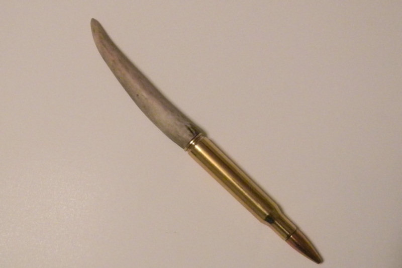

I have made many antler pens for hunters. My offer was give me a tine/end and the shell you used and I make the pen from that. I turn down the tine to match the end of the shell casing leaving the tine mostly untouched brown bark. I apply a solution of potassium permanganate and the white turns a lovely brown shade. The turning STINKS, LITERALLY!!!
That has worked well for me in the past. The CA fills the pores in the pith/marrow making it solid as you turn. The tine has less pith, but antler has quite a bit of color, from whites, to blues to grays. Each one is unique, it's like deer burl!

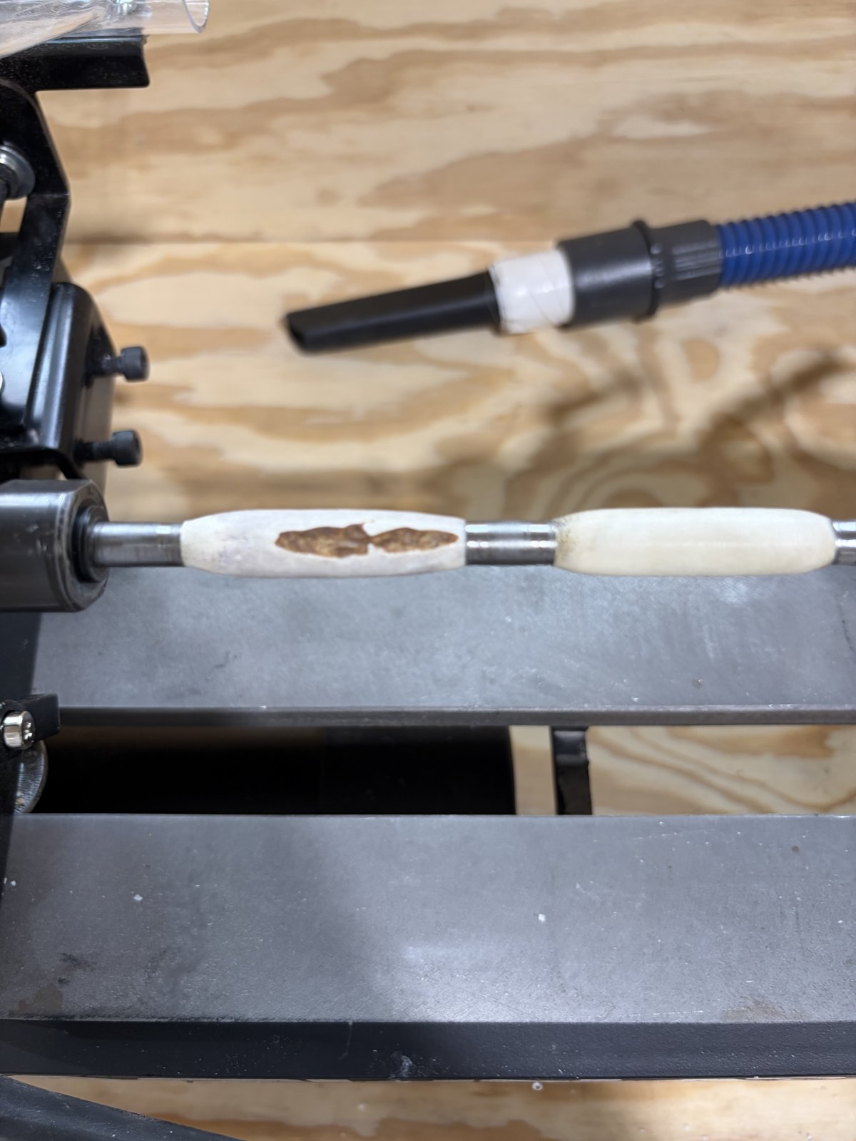

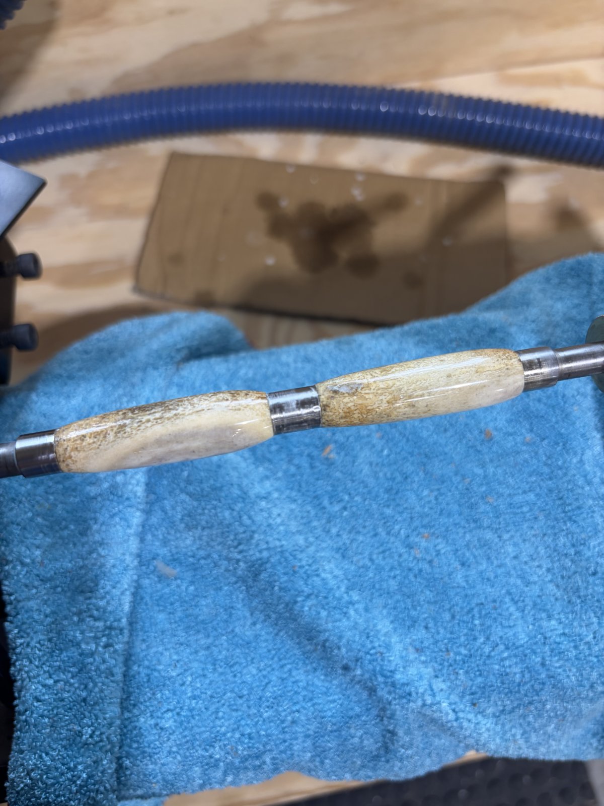

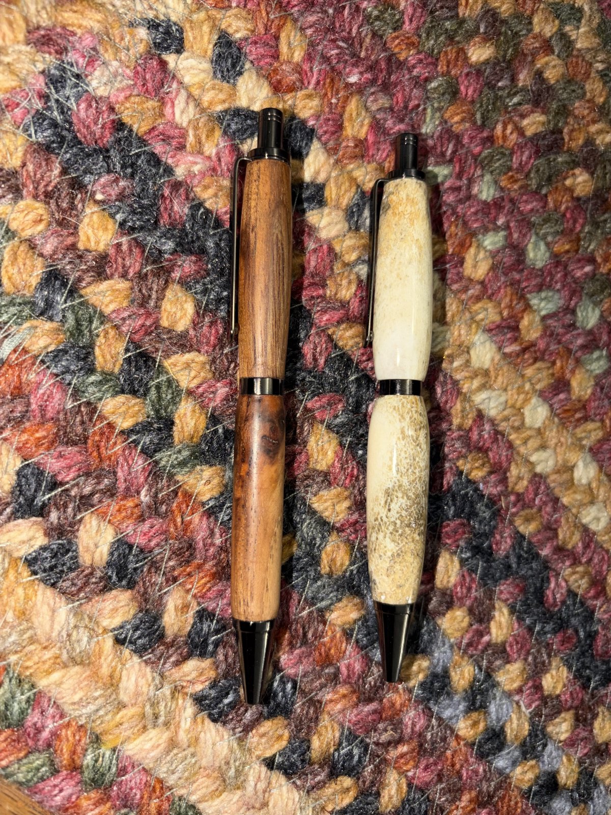

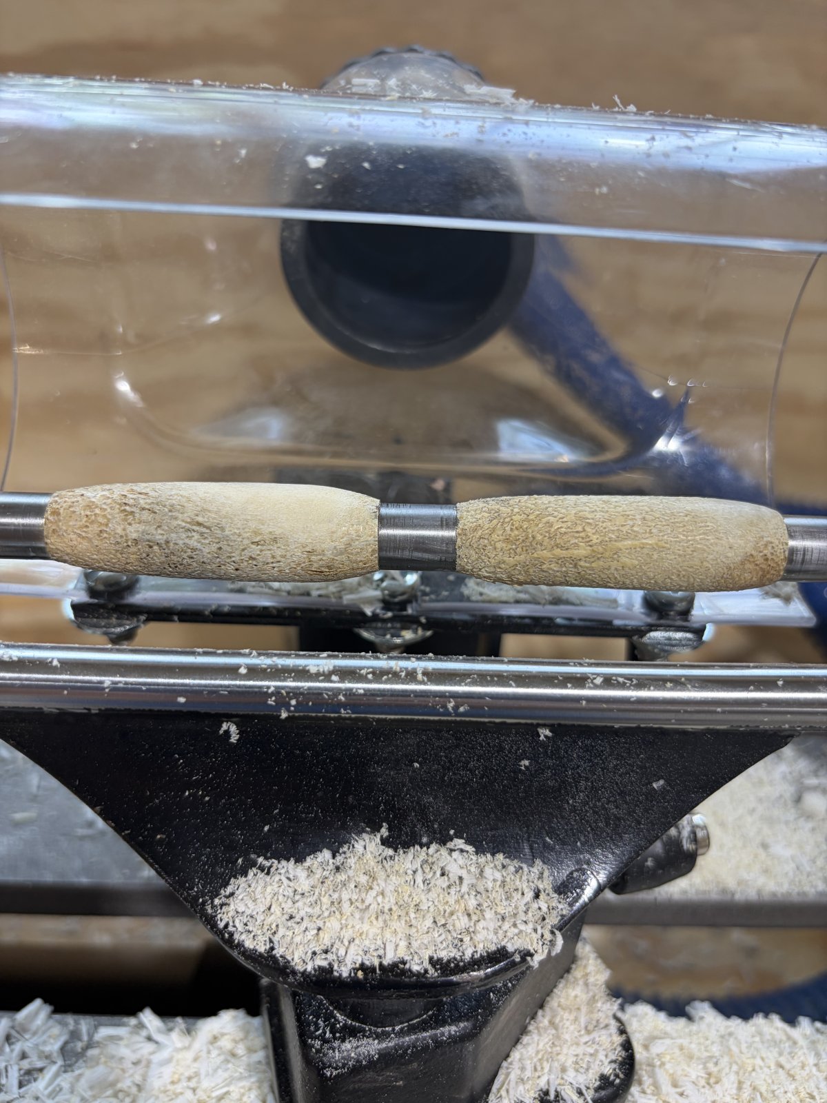

Here is how it went. Thanks to all the experienced turners here, I followed everyone's advice and was really happy about this pen! This was too much fun! Thanks for all the help.
-CA glue for filling in the marrow area like Rob suggested.
-sanded with 600,800 and then a few coats of thin CA
-sanded with 1500 and then built up a CA finish
-wet sand through the Micro pads
Some pics from the process. My son did the Hickory.

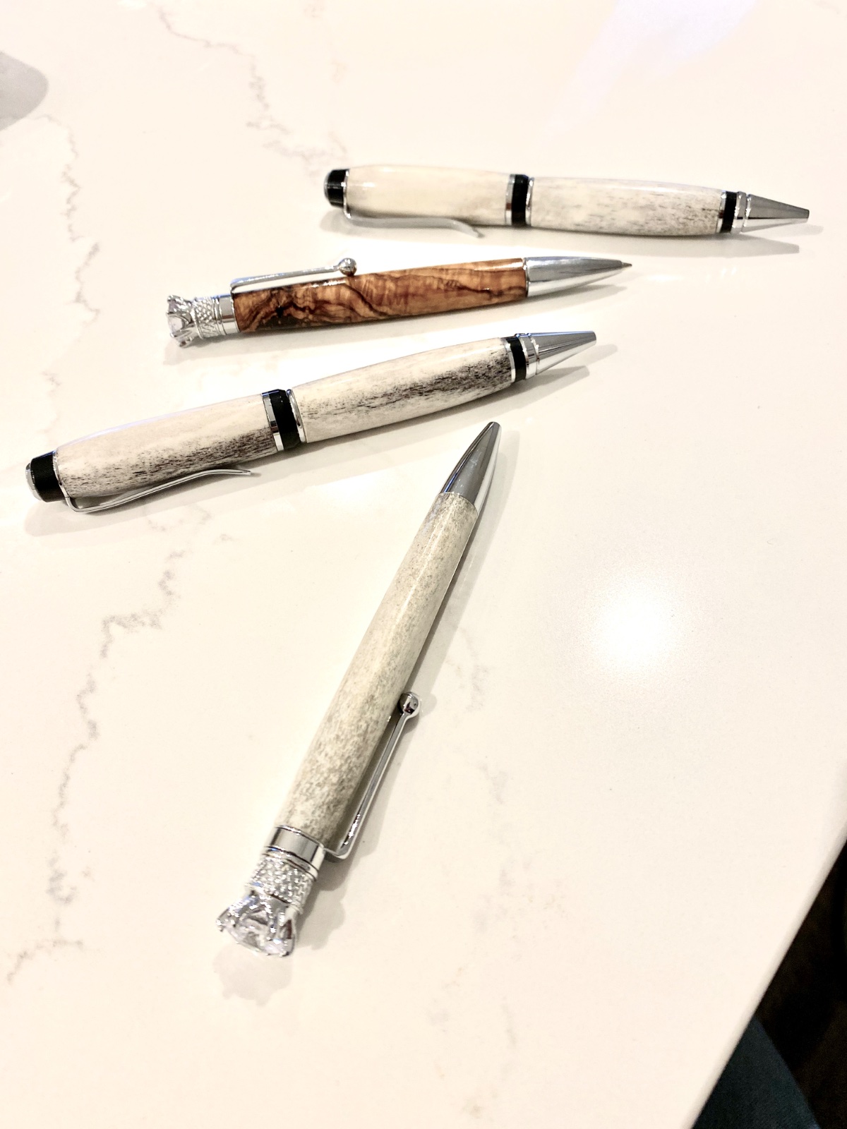

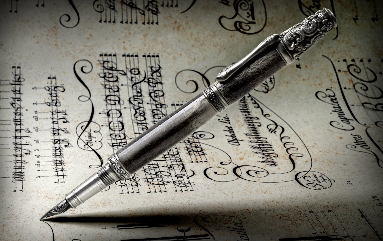

Congrats on making your first deer antler pens. They are true keepsakes. As far as the smell goes, Anson from Springfield pens (he does a great job making bespoke fountain pens) says that when you turn deer antler your workspace will smell like someone has been making bone broth for days!😂. here are a couple of antler pens that I have made…..one from the more medullary antler, and a couple from the more cortical antler.

Thanks Dave. The music/fountain pen is great! They're all great looking pens but love the darkness of the fountain.

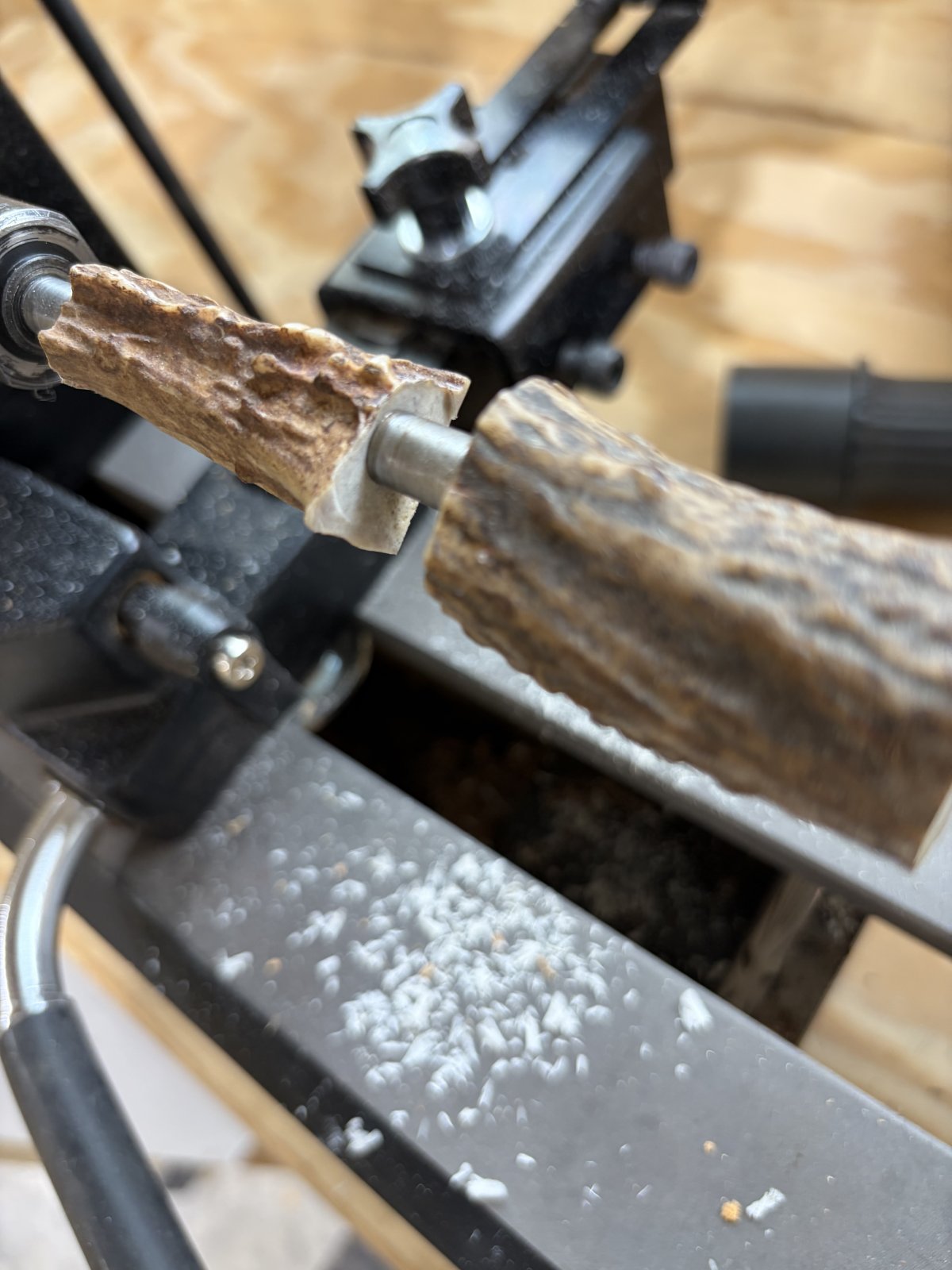

Trying another set and this time drilling close to hopefully retain the bark of the antler. I got somewhat of what I was shooting for but then I tried to do some coats of CA and it didn't look good. So walked away and will try to work on it some tomorrow. This is before glue finish:
OPEN FOR SUGGESTIONS ON HOW YOU WOULD FILL THE VOID/bark recessed area. I think I have messed it up with thin.
