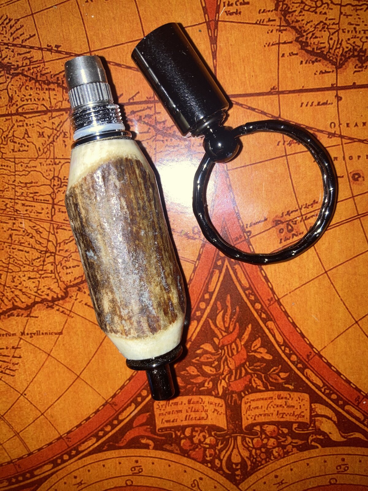

Had some shed antlers. No deer was harmed. I turned down the ends about 1/4" so as to match the bushings. I left the center natural as rounding it would remove the bark making it appear to be bone. I also like that the shape is natural.
Only one problem that's insignificant but angered me. I like perfection. I've made these before but on this one, the plunger to eject the hole cut from the cigar wouldn't press in all the way. I use a 1/2 ton arbor press, and used a lot of pressure. Any more would have destroyed it. So, there's about a 1/32 inch gap between the plunger and the antler. Not a big deal. I made it for function and it works great. Must be a defective kit, as there is no plausible reason it wouldn't go in further.

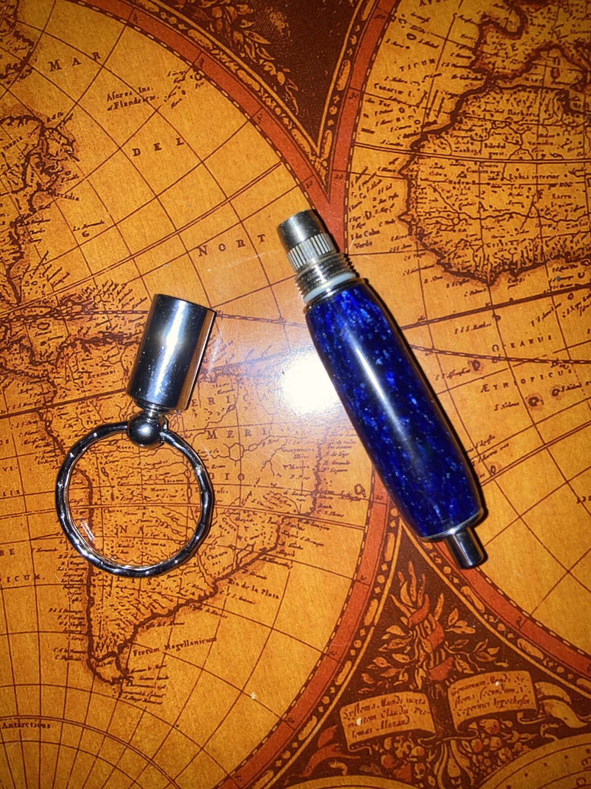

If you prefer, WOODTURNINGZ has the bushings for this kit. If I remember, they have the punch kits in 3 or 4 different finishes. I smoke cigars everyday also. Here's another I made from Kirinite.

Other plausible reason is the cut face of the antler where the plunger pressed in was not perfectly flat or had a burr. It works to have a very slight recess in towards the center of the hole so the edge of the pressed piece meets when fully seated. Seating a finial on a lid is similar but the recess is usually made towards the tenon on the finial.
Thanks. That's a definite possibility. I've turned several of these before. This is the first time it's not fully seated. Only off about 1/32nd if an inch. Totally insignificant but I tend to be a perfectionist. Your answer is very likely to be correct. I can't think of anything else. Thank you for your reply.
