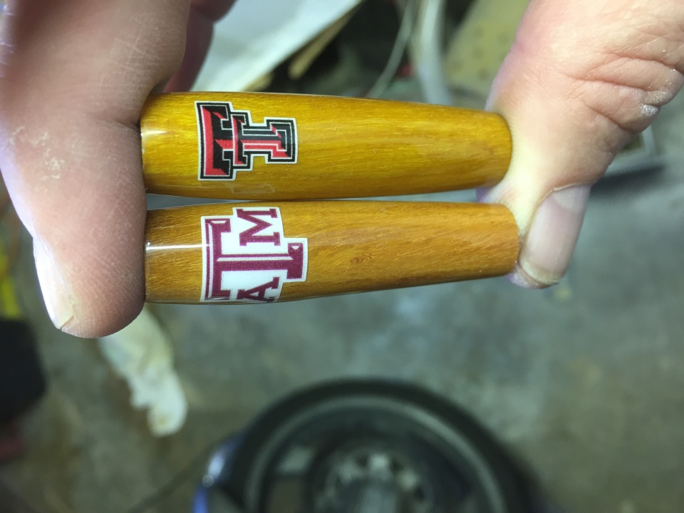

I ended up putting on the decal and dripping on the decal some thin CA glue. Let it dry and then dripped some more CA glue on the decal. Both times without the lathe running. Wiped off the excess that gathered on the bottom each time. Let it dry. Then I put 10 coats of thin CA glue on the blank. Then 3 coats of medium CA. Think my medium CA has gone bad because it chipped on one end on both blanks. Sanded the blanks down smooth and the end with the chips until it was smooth. Then went back with 5 more coats of thin CA glue. Sanded to 12000 with MM.
