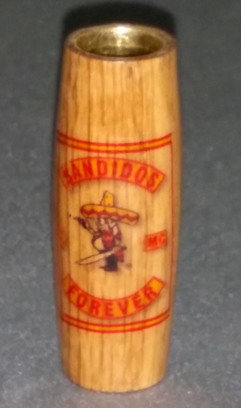

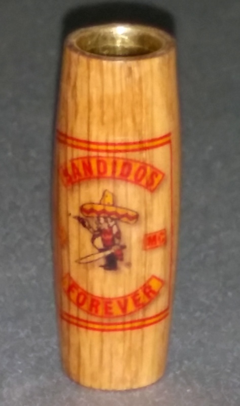

As already posted, it works flawlessly. CA then decal then CA.
