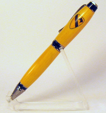

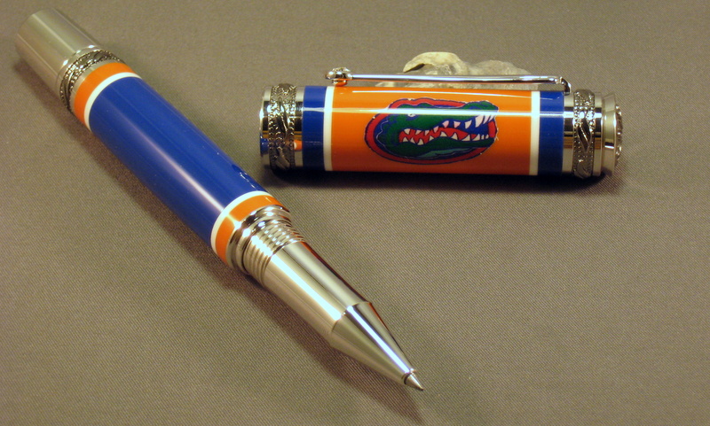

The yellow pen is Osage Orange. I used clear decal paper with it. This pen turned brown when its owner left it in his truck. The CA cracked too. I made him another pen using yellow acrylic blanks. BTW, there IS a tutorial on decals, if you look for it in IAP library(I think)

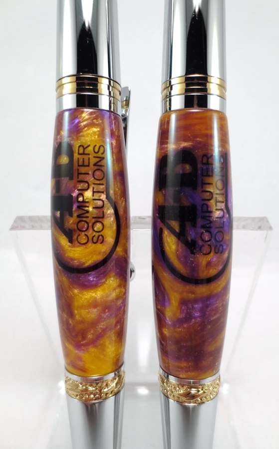

Here's an example where I had to use a colorful acrylic blank chosen by my customer. I made a few different labels for their selection and they chose a clear label with black lettering and loved it.
