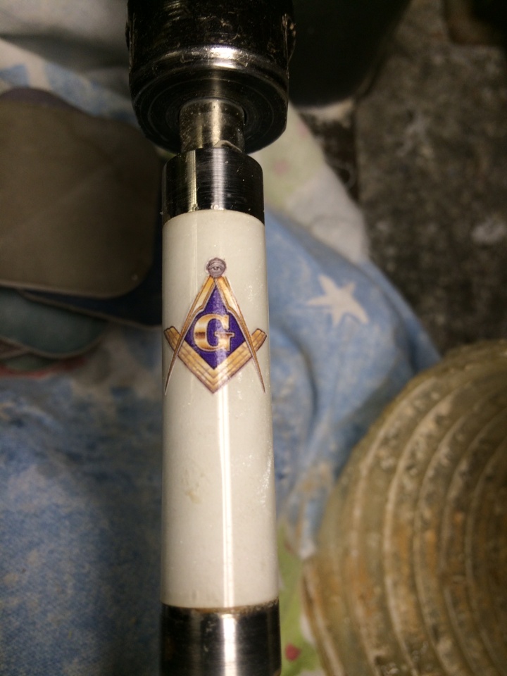

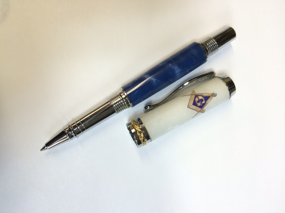

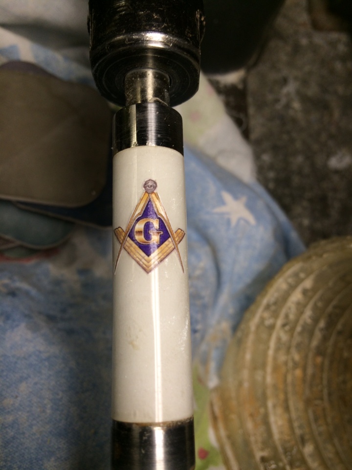

Update
Based on suggestions above -- Especially JohnU.
Reprinted with the printer set to Photo paper
4-5 coats of Kylon
And Q-tips for the application - What a great suggestion!
It applied without the smearing.
I attribute the success to all of the suggestions - not just one.
Many thanks - sorry for the iPhone pic.
