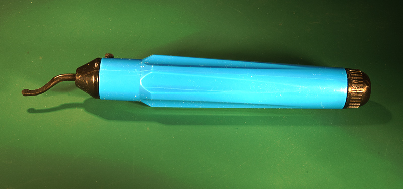

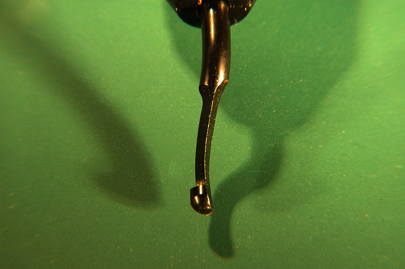

Well - I received my Sealey deburring tool this morning and have spent happy times drilling a myriad of holes and then deburring them!
All that everyone has said has proved to be absolutely true! It deburrs perfectly holes and flat plates in metal and, if used delicately, Acrylics.
I am very pleased with the design and manufacture of this Sealey one which cost me £12 off Amazon uk. It has a swiveling tool insert that is knife edged and also has a spare blade in the handle.
Many thanks to all of you that supported this thread with you approval comments which tempted an old fool to try a newfangled gadget!
