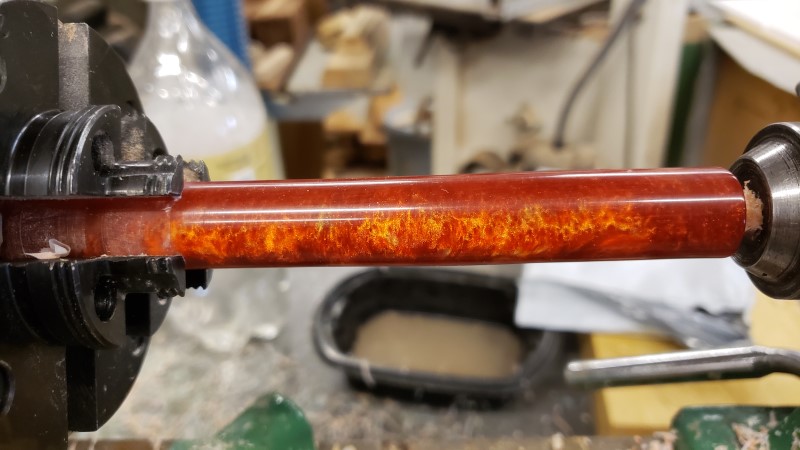

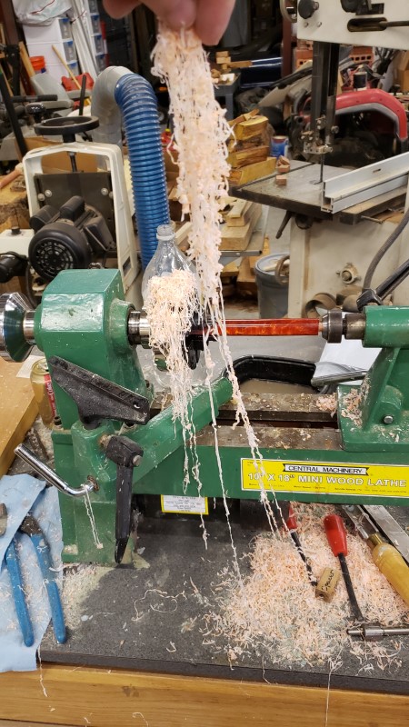

In case anyone wonders how it turns, on a fast lathe with sharp tools it shoots looong streamers. IMO it polishes nice as well.
I turned this to see what it was gonna look like inside so I could figure out what pen to put it on. Polished to 4000 then hit with Meguiars 205. No other top coat.

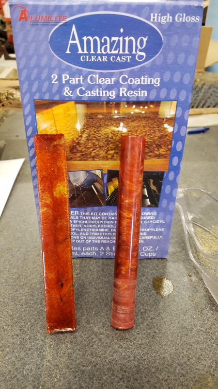

Here's the whole recipe :)
They were a 2 color pour. I used liquid dyes and mica powders. The liquid dyes I use are epoxy dyes by Let's Resin and the micas are no name or Let's Resin, both off Amazon.
I made the 'Continents' blanks and a few others at the same time so it was a 26oz batch of resin mixed and degassed 5mins.
For these, 5oz in a cup and 1oz in a cup.
In the 5 oz cup enough Ruby Red liquid to give a light rose color then an unmeasured amount of orange mica powder + and unmeasured but roughly equal amount of pearl orange-red color shift mica. I use popsicle sticks to dole out mica so I know how much I am adding relative to how much I always use but I've never measured it.
In the 1oz cup a few drops of liquid lemon yellow, then Fantasy Yellow mica powder and roughly 1/8 that amount of metallic gold mica powder
Poured in half the orange then used a popsicle stick to drop blobs of yellow throughout, using half the yellow. Gently poured the rest of the orange on top then dropped the rest of the yellow.
Used a dental pick to drag the yellow blobs across the blank after pouring only dragging across, not along the length.
Let it set up overnight and demold.
