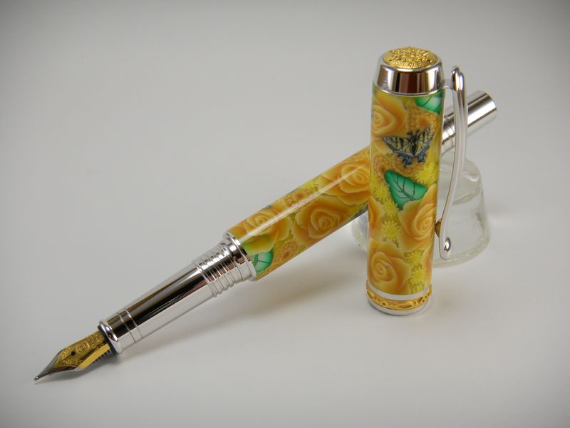

Earlier this year I made my wife a Jr Statesman II FP from Toni's Yellow Rose blank (for mother's day). She has been complaining that it is "scratchy". This A.M. I pulled the nib, flushed the feed and replaced with a Guilded Bock #5, I'm sure she will like it - it writes great. Upon inspecting the feed that came with the kit and the nib I found the following. The feed had a "8" embossed on it and the nib said "DAYCOM GERMANY". What does the "8" signify and any idea the maker of the original nib?
Thanks for the help.

Most component (kit) fountain pens come with a nib stamped, "Iridium Point Germany", or just "Germany". It seems like this should mean that the nib is made of iridium and that it was made in Germany.
In fountain pen terminology, though, "iridium" actually means any hard material on the very tip of the nib. Once upon a time, iridium (or a compound containing iridium) was used, but today there are many different formulas. They generally don't contain any iridium, but the name "iridium" is still applied. There's no particular quality advantage to using real iridium, either.
So, "Iridium Point Germany" really just means the tipping material (probably not iridium) was made in Germany. The nib itself may have been made anywhere, with most being made in India or China. Some are even actually made in Germany. Although German manufacturers usually have better quality control than Indian and Chinese manufacturers, any manufacturer can produce a good - or bad - nib.
As to the # 8 most likly the # the manufacturer uses to signify either size or vendor.
Not sure if the 8 signifies anything, but the kit nibs can use a little finessing from time to time. I've had some come out of the package and write very smooth while others need a slight tweak to the alignment.
I'm still new at FPs myself, so others will hopefully have more information for you.
The #8 represents the number in the manufacture line of the feeds. Generally there are 12 in a line and they use the number on the feed so that if a cutter goes bad when creating the fins they can address the specific cutters in the line.
