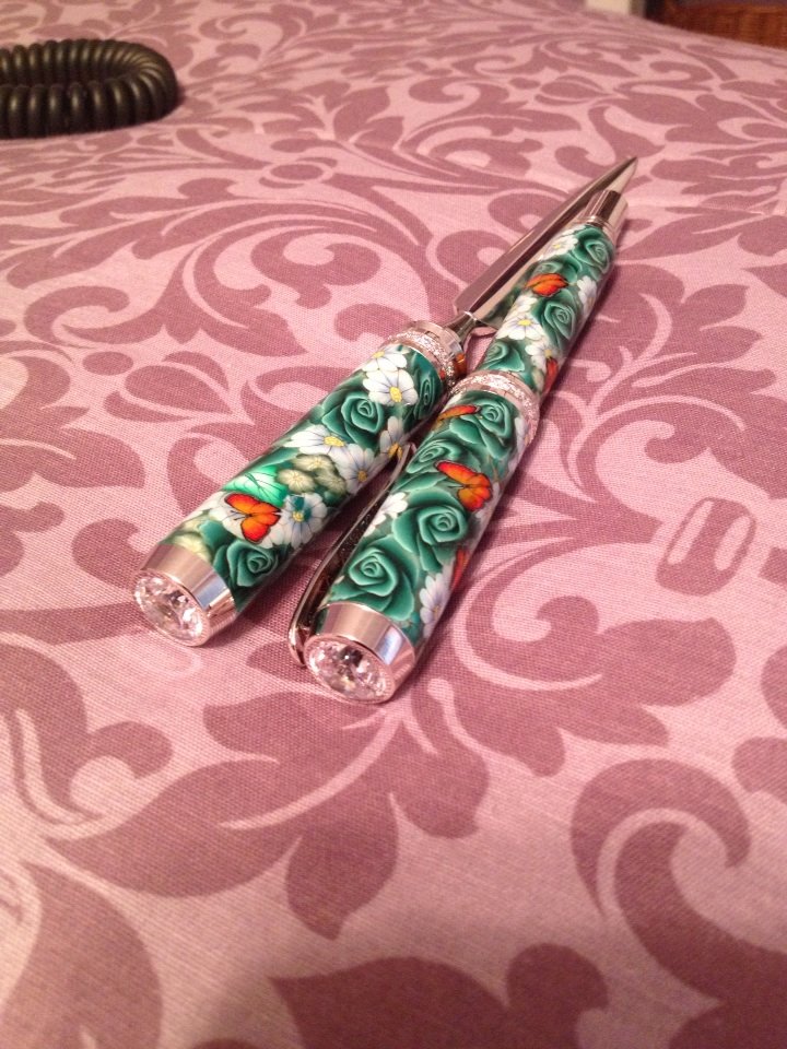

Sometimes, just sometimes you have to just do it.
attachment.php
attachment.php
Ok, maybe I'm missing something, but I don't think so.
The Venus, Jr Statesman and Jr Gent all use the same tubes. Rather than having to make a MOQ of 500 pieces and waiting 10 weeks ( yes, Chinese New Year REALLY slows down shipping from Taiwan this time of year) WHY NOT get a few Jr Gent or Jr Statesman NON postable sets in the same plating? The only part you need is the non-postable finial.
Simply replace the finial from the Gent or Statie with the postable Venus. Some time ago the non postable Jr Statesman had an embellishment on the finial. This embellishment was the same size as the crystal in the Venus. With a punch, the embellishment could be popped out and the crystal glued in. I HAVEN'T MADE a non-postable Jr Statesman in sometime, and I seem to remember that the embellishment was no longer there, but instead simply smooth. If this is still the case, you could use the much less expensive Jr Gent finial end.
I just looked at the Jr Statesman non-postable photo on CSUSA website. It shows the embellishment still there, but it looks larger.
This is still not a problem as you can buy virtually ANY SIZE crystal you need from Hobby Lobby, Michaels, et al. The jewelry supply stores online have numerous sizes of Savroski Crystals CHEAP!

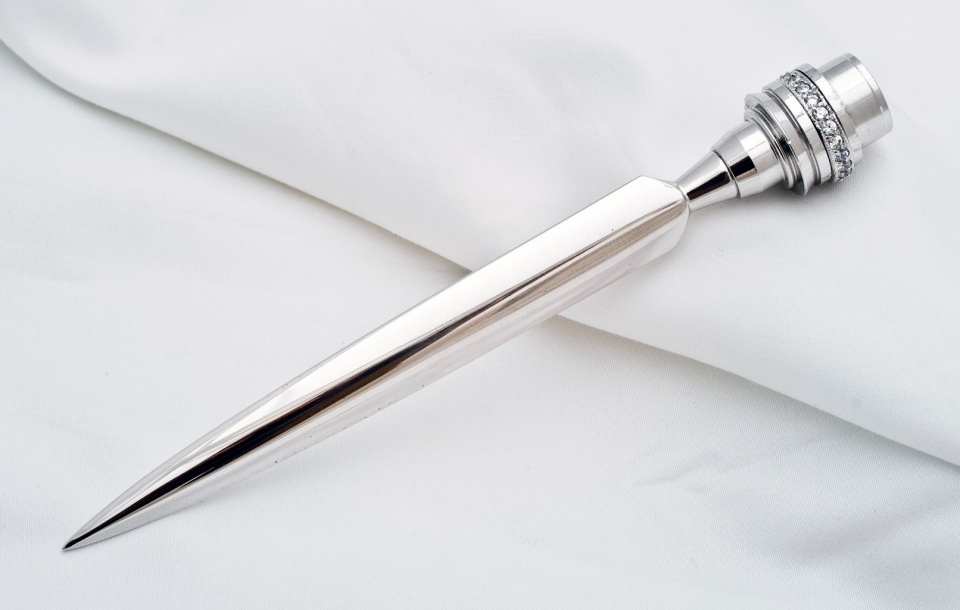

I do believe the non postable end of the Atrax could work with the Venus. If not a simple fix would be to use the smallest bushing of the Atrax with the Venus bushings to get the right fit.
I'm not 100% sure if the Venus and Atrax bushings are the same. But i have turned and completed both the Atrax and Venus and both pens taper to a smaller bushing at the end of the pen.
Worth a try, only thing is that you'll be wasting a basically complete Atrax kit to complete the Venus. You could buy the Atrax (which comes non postable) then buy the postable kit that Ed at exotics sells.....then use'll have that non postable end free to do what you please with.
PS: Ed-nice letter opener, but parting out a Venus kit for only two parts is kind of expensive in my opinion....nice, but expensive.
