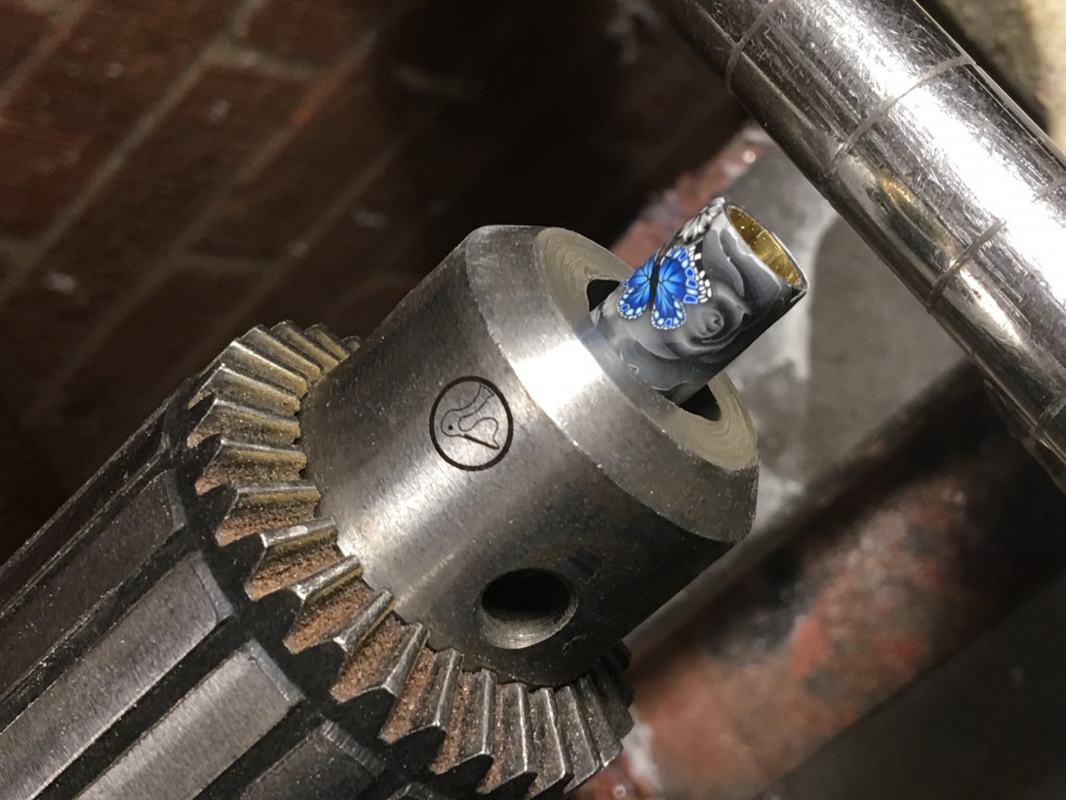

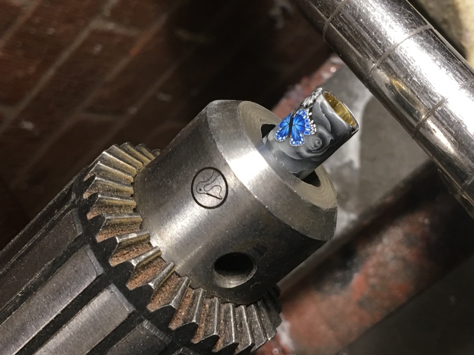

Step 1) put the tube inside a drill chuck on the headstock as shown.
attachment.php
Step 2) take some novus #3 and a paper towl and POLISH the inside of the tube where it makes contact, you want 1/2 to 3/4 of the inside done.
Step 3) test fit the lower to the upper, if it goes in smoothly then your done, if it's still tight then do more polishing.
The tubes are extruded with no cleanup work done. The design of this kit dictates you have some cleanup work to do so do that.
As for the glue option, that's not that good advise to use. Try this. Take the transmission off, unscrew it. Note there are ridged tabs on the sides. This is to grip to the tube for support. You can also search in the archives for bad transmissions and yes you will have to change them over time and if you glue it in then that's not coming out easy. Overall it's best NOT to glue.
