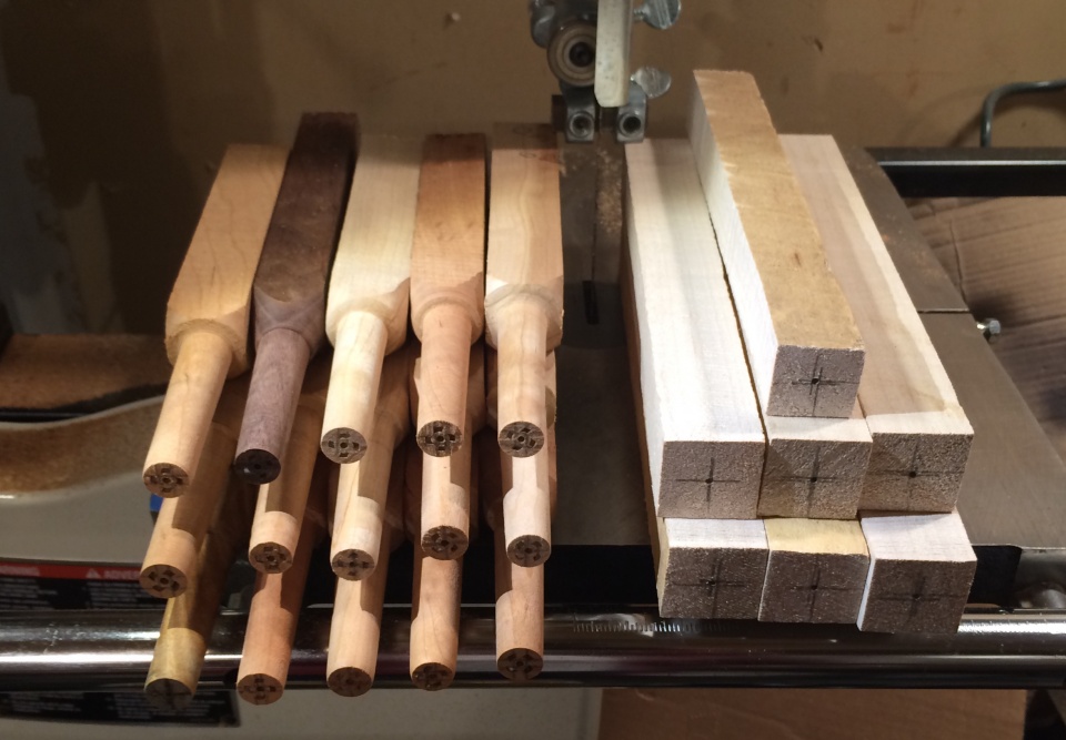

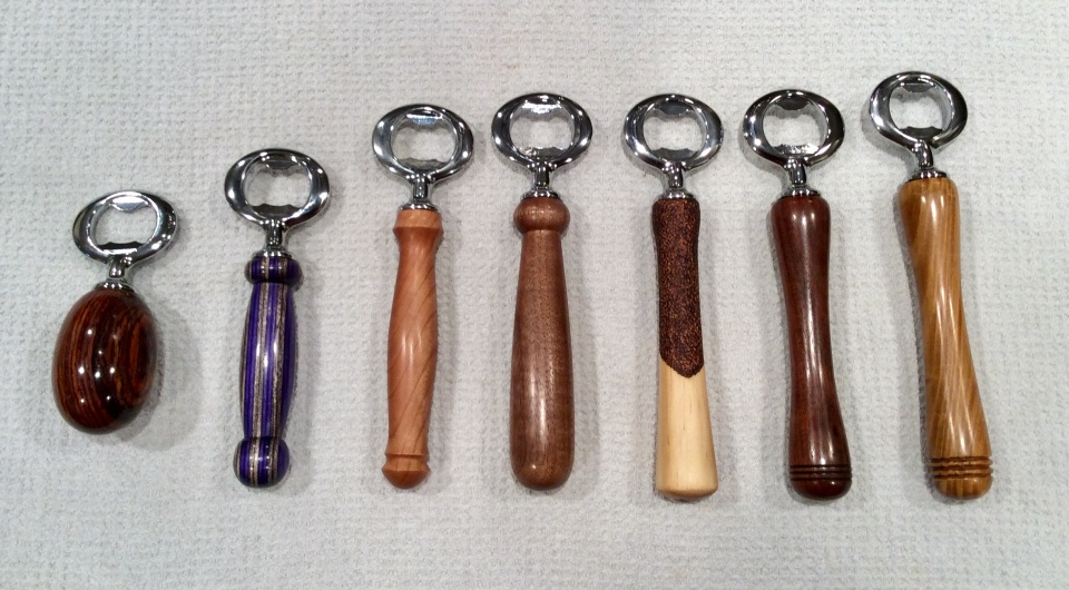

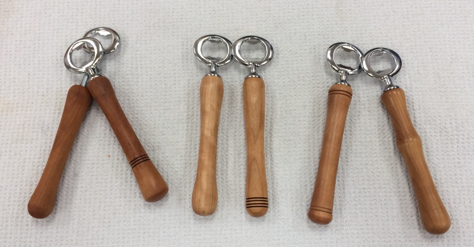

Last night was Date Night at our local Woodcraft and I was the instructor.
We had three couples and turned bottle opener handles. While prepping for the class, I asked my contact at Woodcraft if they had mandrels such as bottle stopper threaded mandrels....No.... I asked if they had chucks with pin jaws...No....they have six chucks with #2 jaws.....and they have one chuck with Pen jaws..no help.....six mini lathes, a scheduled project and no method to mount and turn one inch square stock for the bottle openers....time for a solution.
The solution: I cut longer cherry stock for the handles and turned a #2 Morse taper on each blank with the hole drilled and tapped in the other end. I also had some maple learning blanks for them to turn between centers and get familiar with the spindle roughing gouge and spindle gouge.
I did a quick demo and got the group working. Two guys and one of their wives had turned just a tiny bit but that was a help. Well, I was super busy with all six by myself (Wifey was at a quilting event), and time went more quickly than planned but we did make it with six finished handles and six happy campers!
Here are some pics. One of sample openers I turned, a pic of the blanks I prepared and a pic of their finished handles.
Thanks for looking!
