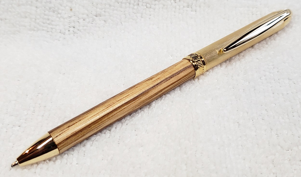

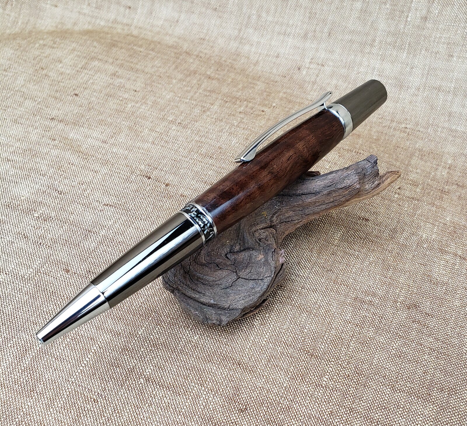

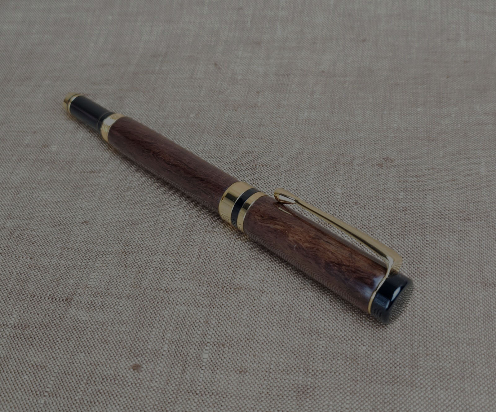

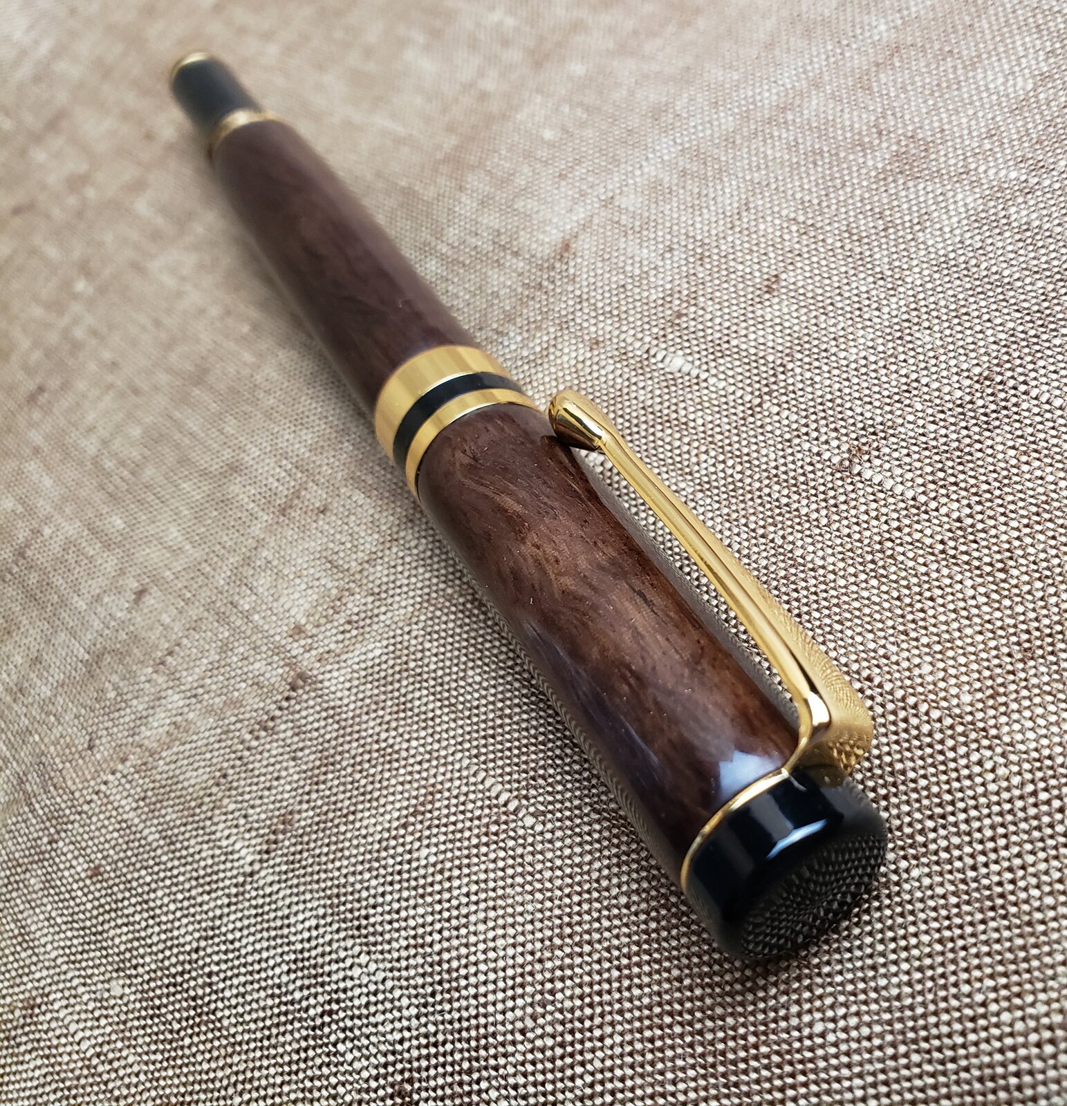

I've had a really hard time showing off grain on dark woods. This curly Katalox is a great example. The grain is gorgeous, but how can I show it off without zooming in on a specific section? With a high gloss CA finish, the light reflection messes with the exposure.
I'm using my Samsung Note 9. It does take pretty amazing pics. I have a basic understanding of aperture, ISO, and exposure, and can manually adjust them if needed (I'm sure it's all digitally adjusted as there really isn't a moving aperture in the lens). Typically, I photograph using a natural colored cotton muslin as I don't want to distract from the pen with fancy props, but did find a darker fabric that helps a little. I have a softbox light and use a reflector (aluminum foil on a piece of cardboard, but have also used white art/craft board) to balance and reduce shadows. I found a darker cloth to use that helps some, but still can't get the grain to pop.

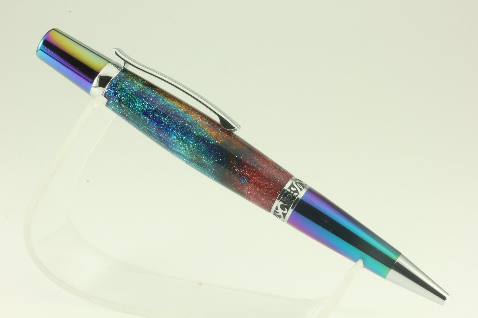

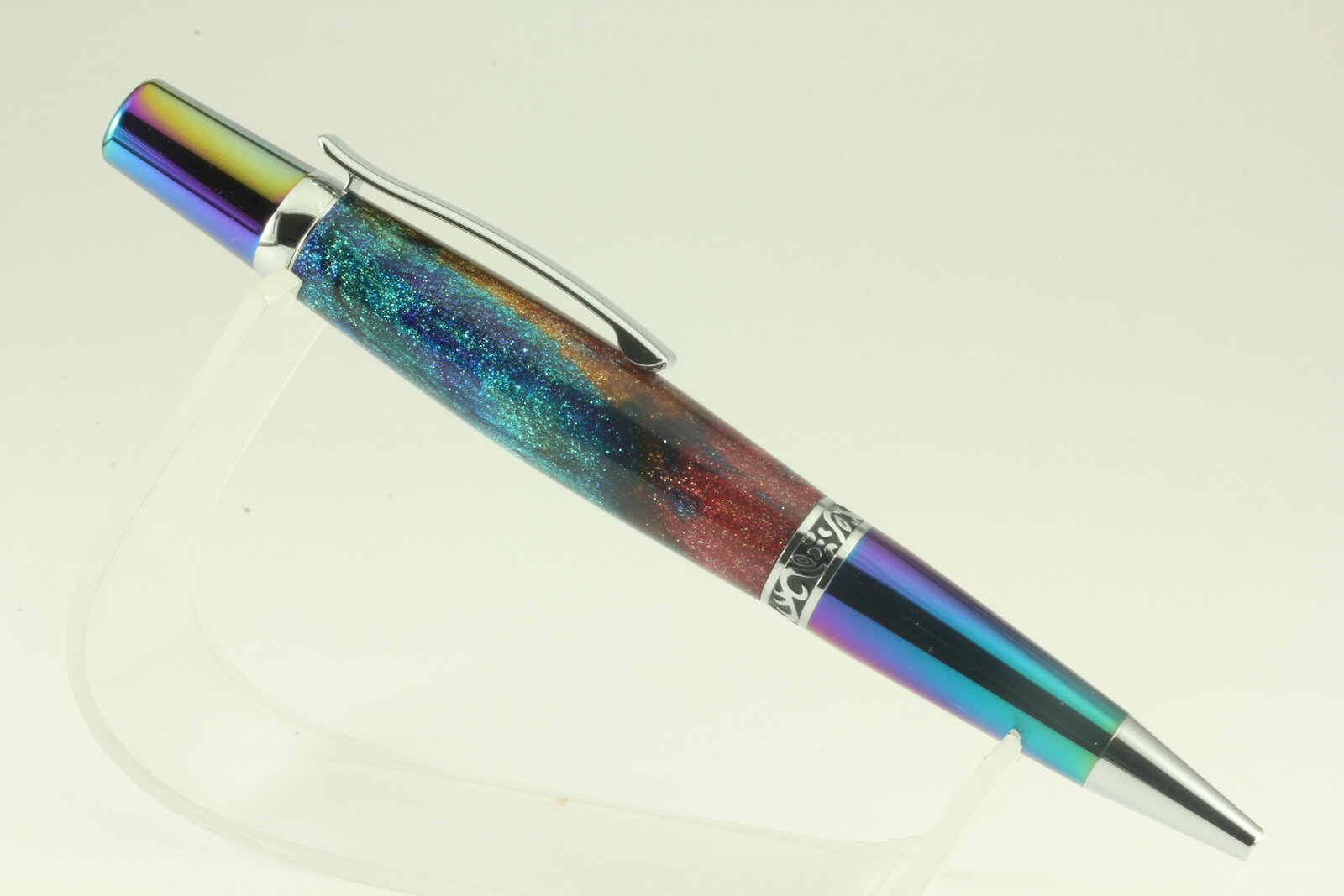

I use a Canon 60D, for a lens I use the EFS-60mm macro. I use a very heavy tripod. I have a homemade lightbox. I manually set the white balance to the color temperature of the lights. I focus manually. Fix the ISO at 100. I like keeping everything in focus so I keep the aperture small, f22. Then I set the shutter speed to get the exposure meter 1 2/3 EV over to compensate for all the white in the shot. My old camera is a DSLR, so I set it for mirror lockup. I use an external electronic shutter trigger. Even after all that, I get frustrated because It is really hard to make a photo look as good as real life. I suck at post processing, so I don't do it.
Example follows, it's a nice photo hardly does the pen justice.

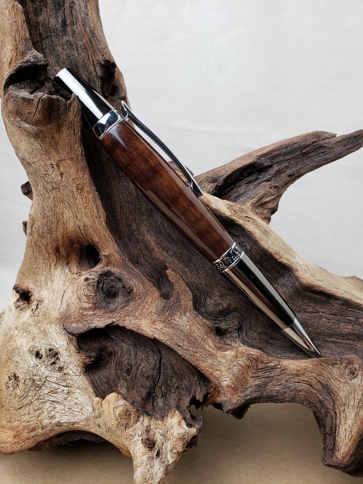

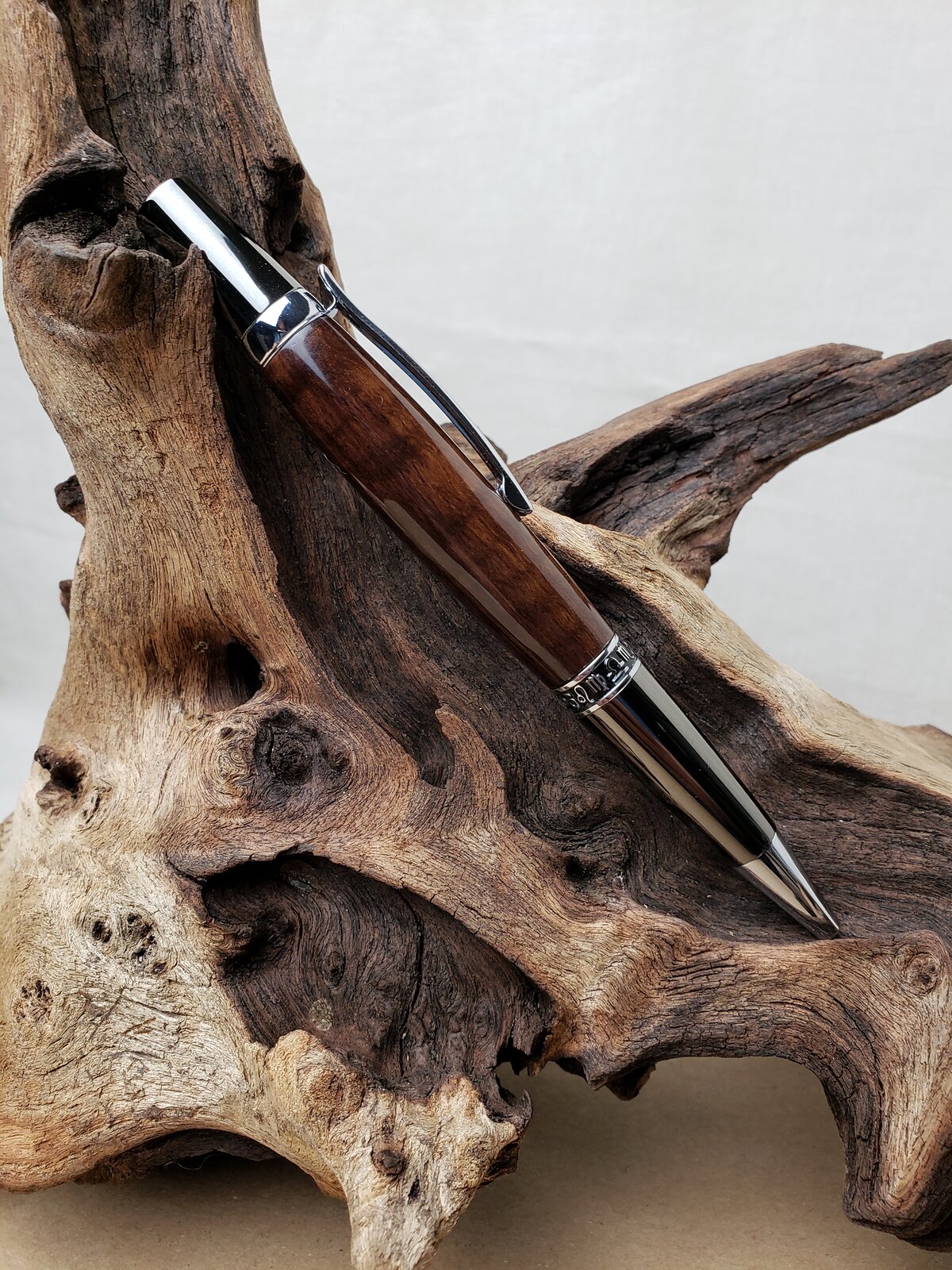

Nope, no nerve struck. I agree with you and I'd love to get a DSLR, but I don't sell enough on Etsy to justify it. Generally speaking, my pics look pretty good compared to a lot of the ones I see in other listings. It's just these darker woods where I really want to highlight the grain that are challenging. I'll definitely play with the props a bit for the 3D as you sugggested. Here's a pic of another pen made with the same wood. It looks just the same side by side with the other pen, but looks totally different in this pic. Although the grain stands out better, especially the spiral look from the chatoyance, I feel that the prop is distracting.
By the way, I love that pen and the picture is definitely beautiful.
I think your pen looks great! Getting the subtle curve in the body to match the kit. It's a nice photo too. I love the driftwood, great composition.
The only trick might be to try different lighting angles. Once you figure it out, let the rest of us know!

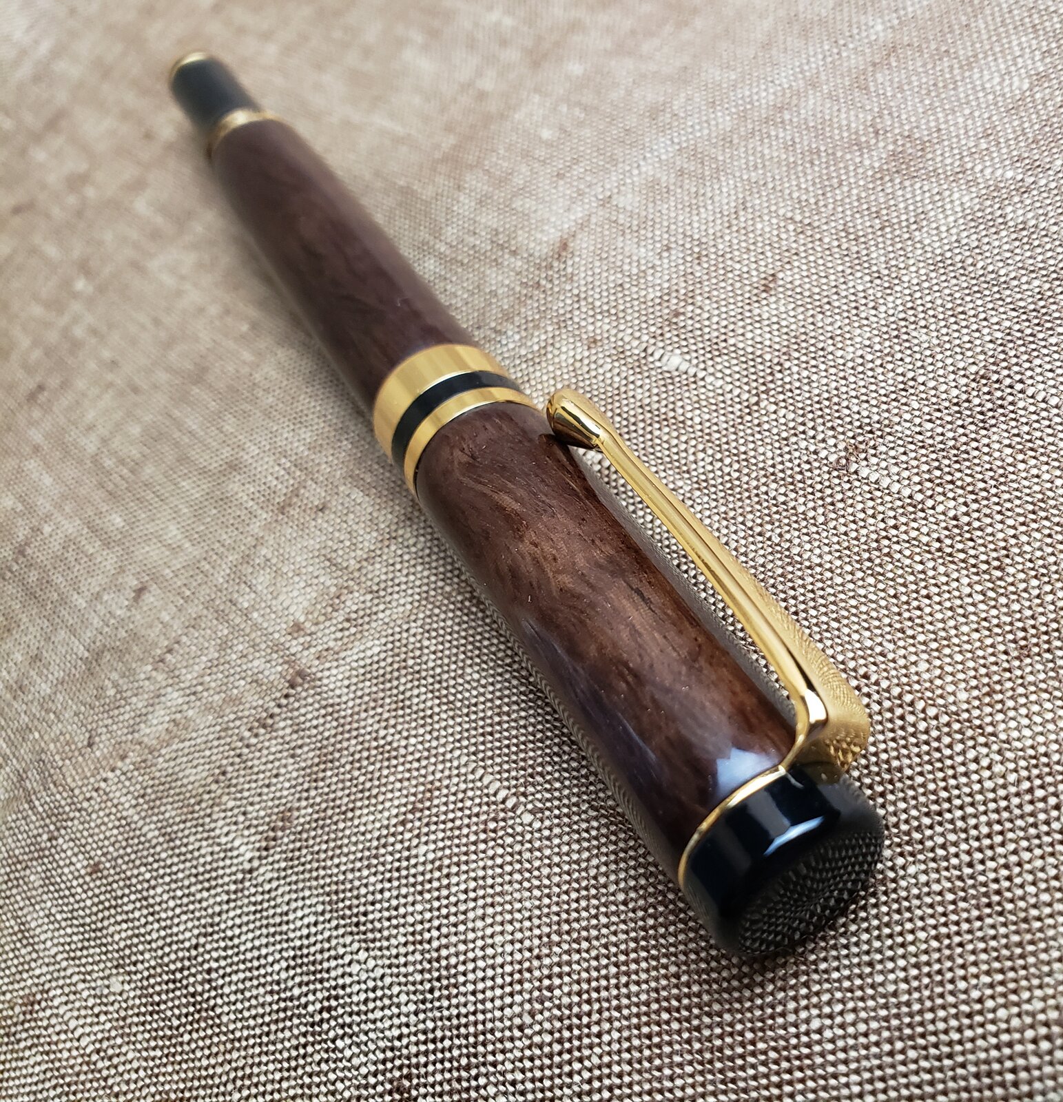

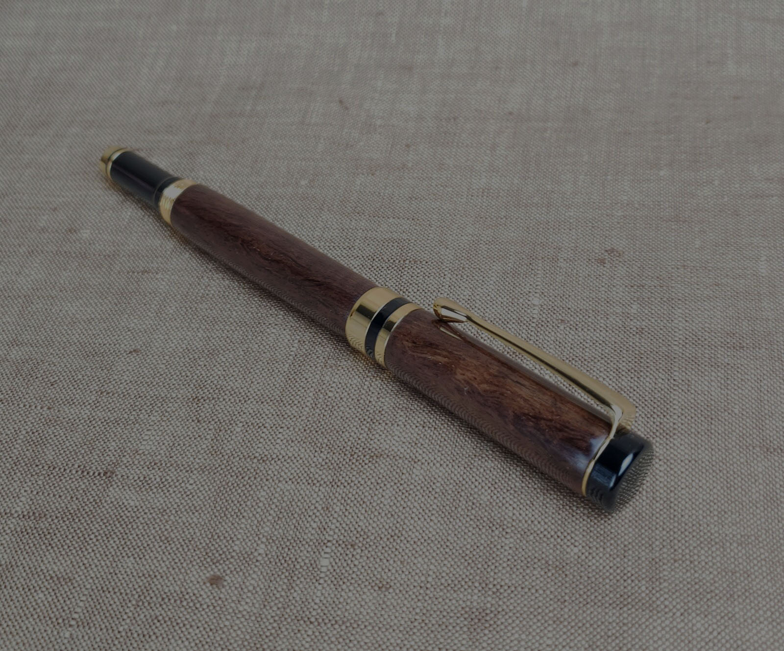

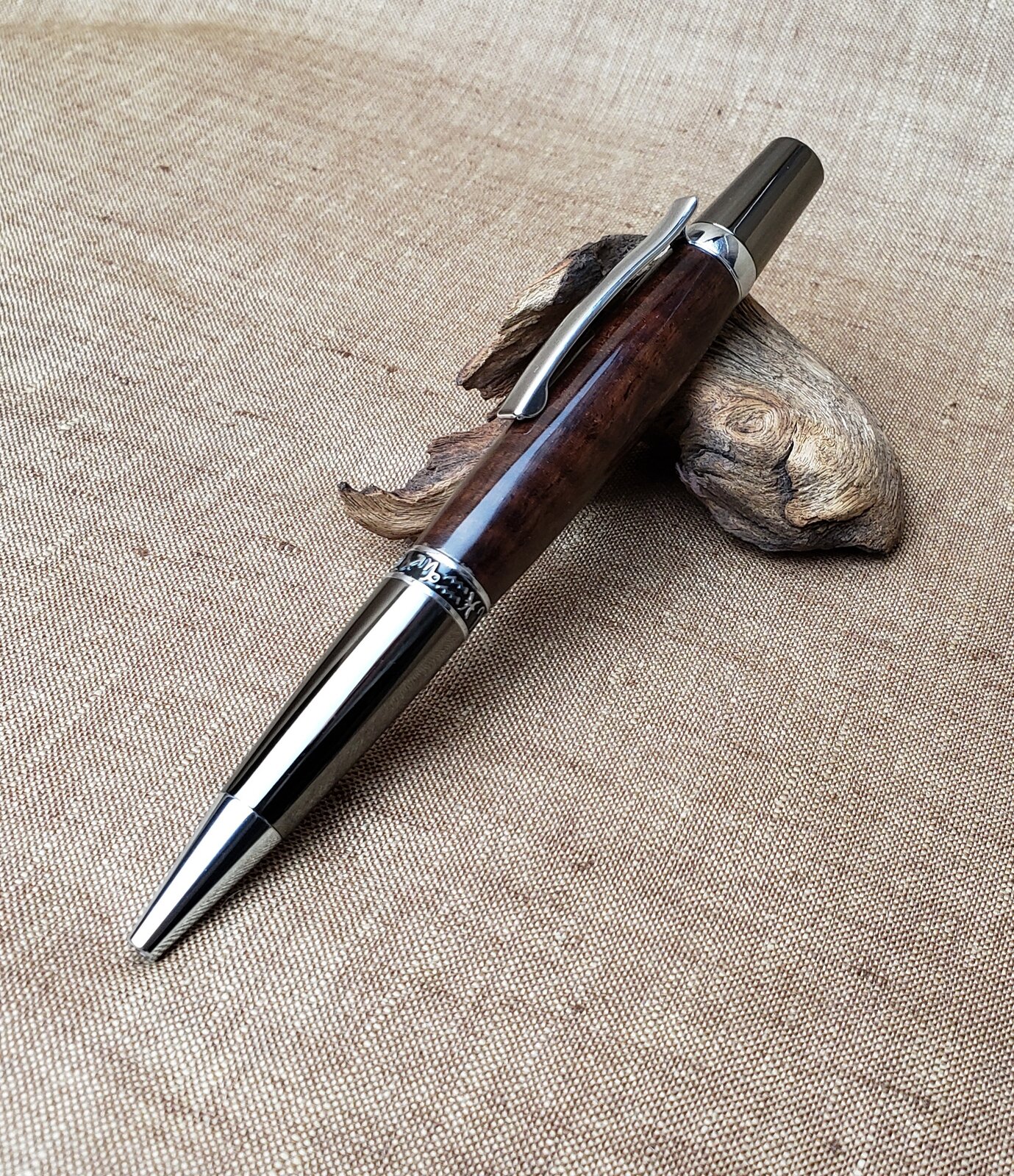

I haven't even started messing with the rollerball, but am making progress with the Sierra. The lighting is tough to get right.

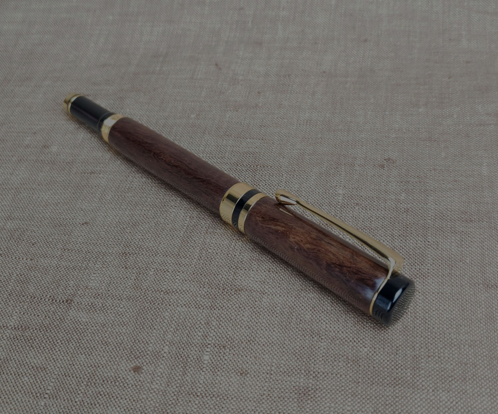

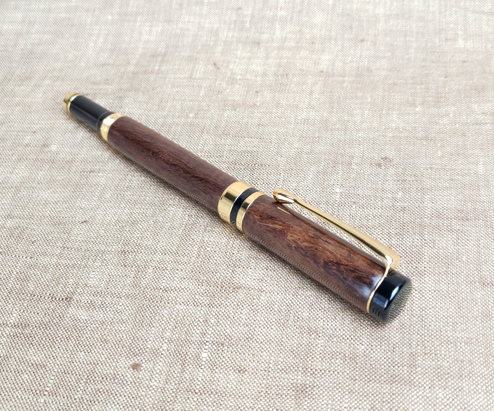

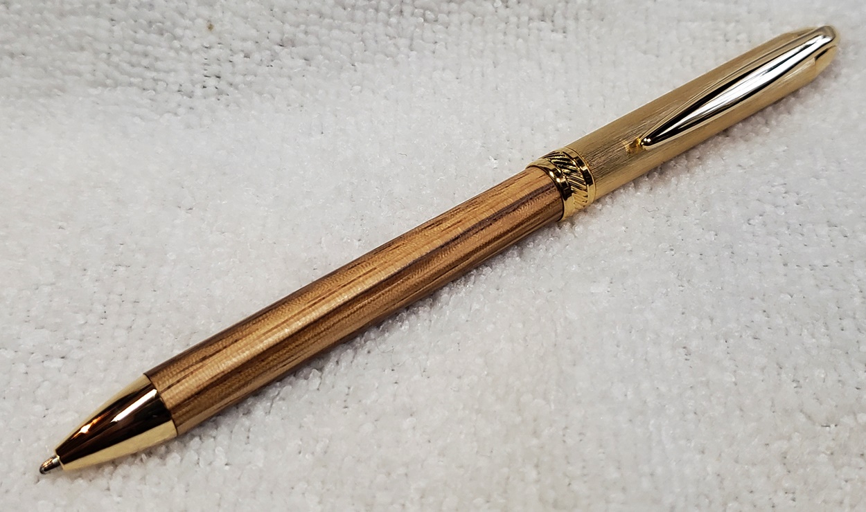

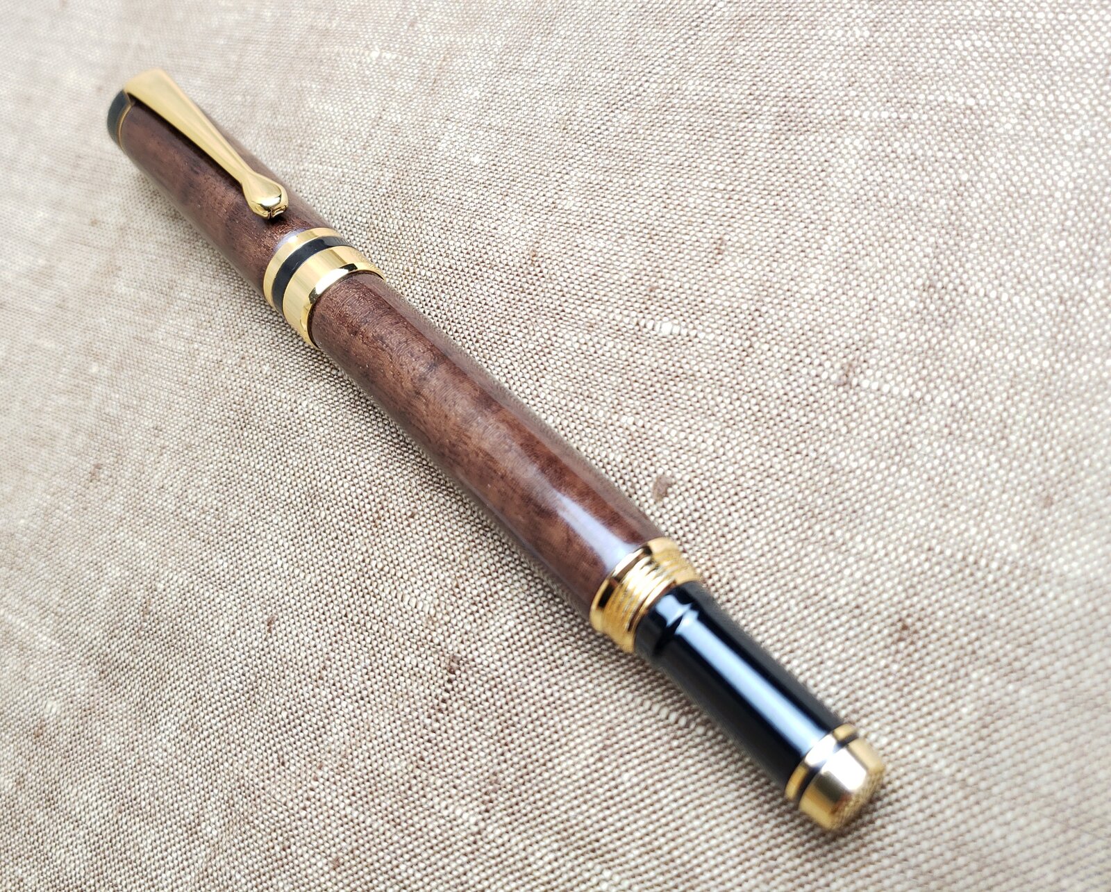

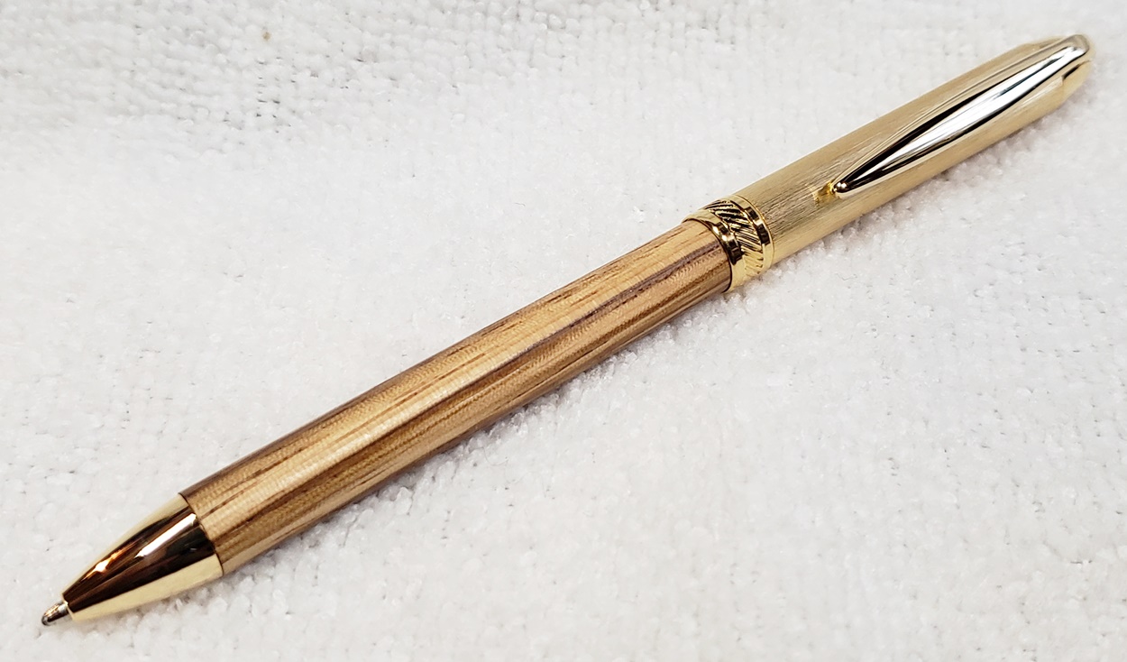

You can also edit and adjust the exposure with editing software. I use a free program called PhotoScape that works well for me. Here are before and after photos, that I edited in PhotoScape. With some pens, there is a more dramatic difference. Might be something to try. By the way, I use a Galaxy S9+ for my photos.
