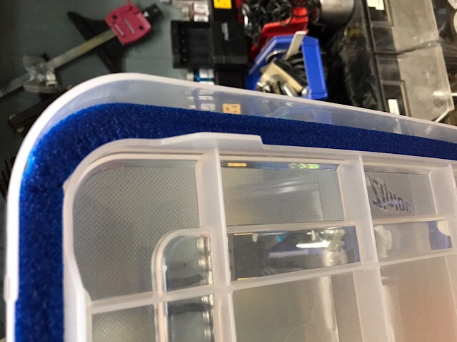

ZipLoc Weather Shield storage container available in various sizes. This one may larger than needed but it was on clearance. Key is, it has a foam seal to keep humidity out. We use them to store Christmas cookies.

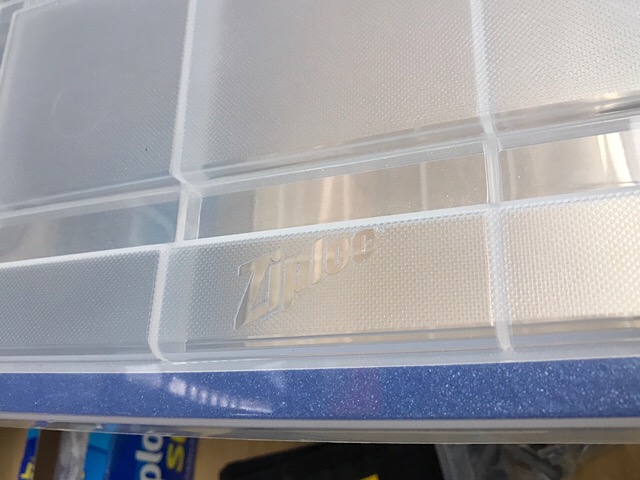

Exterior view of lid seal
Interior view of lid seal

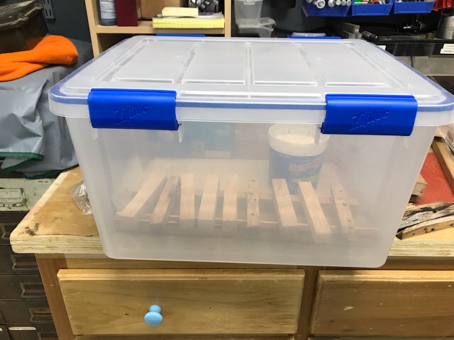

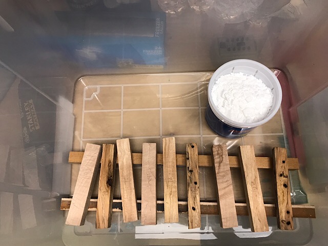

Basically arranged a variety of jar and soft maple blanks on supports or "stickers" as if air drying normally. Placed DampRid in container and sealed it up.

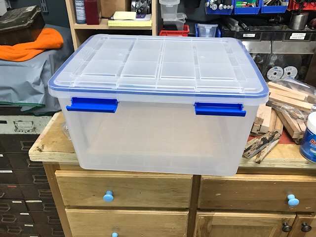

View of closed container.
I took initial moisture readings on each blank then checked them all at random intervals.
