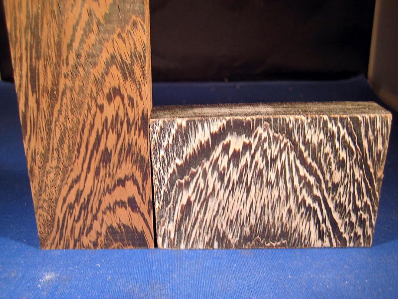

A while back I read on the forum about soaking the wood Wenge in Chlorox to make it change. Recently I had a chance to pick up some Wenge from a local hardwood dealer and so tonight I cut a small piece to try the bleach.
Well, I was not expecting such results. This is the damnest wood. I can't wait to turn pens, bowls and make other flatware projects using this wood. Take a look at what 1 hour in Chlorox has done to the wood on the right. The other piece is how it was bought. Take a look, it is very interesting.

Now that is cool looking. Cann't wait for the pictures of some finished product.
Exactly what I was thinking. I don't recall the original post and I understand your picture was just a test; but it is entirely possible that the Clorox soak will have to be done after the piece is turned to final size and shape or the effect may be milled off of the blank??

It may not be that white all the way through, but I bet it is white very deep. I have a wenge board 2" X 3" X 18" inches and that thing is porous!

For those who asked, the penetration of the bleached color is very slight. A good sanding and the original brown color returns. I have just turned a Wenge blank and the tubes are soaking in chlorox now. The tubes were sanded to 8000 and will only need finishing when they dry. I'll post a pic of what the pen looks like.

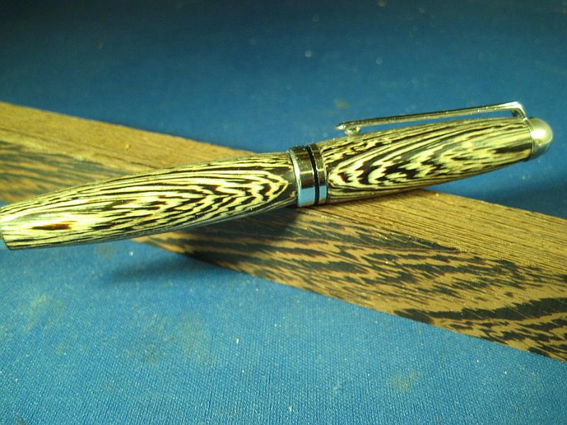

Here are some more answers.....The pen was turned to final size and given a polishing to 8000MM. Then a CA/BLO finish. This wood doesn't take a really good polish but the CA finish helped a lot. The soaking of the turned blanks did nothing to the glue or the tube. The wet blanks we allowed to dry in the sun for an hour and then assembled into a chrome RT Euro. Everything went together as normal. Only difference was the lightening of the wood. The Wenge pen I made that was not soaked only got darker with the CA/BLO finish and lost most of it's character. The grain was not prominent and it might as well have been Ebony. The one soaked in bleach has a color and grain that just pops!!
And here is the finished product.

I have done this process and it works best to turn the pen just a hare Larger than you want.... soak in the bleach for the coloring you want. rinse and let dry then turn to size and finish. it is a stunning look , I think worth the time and effort.
