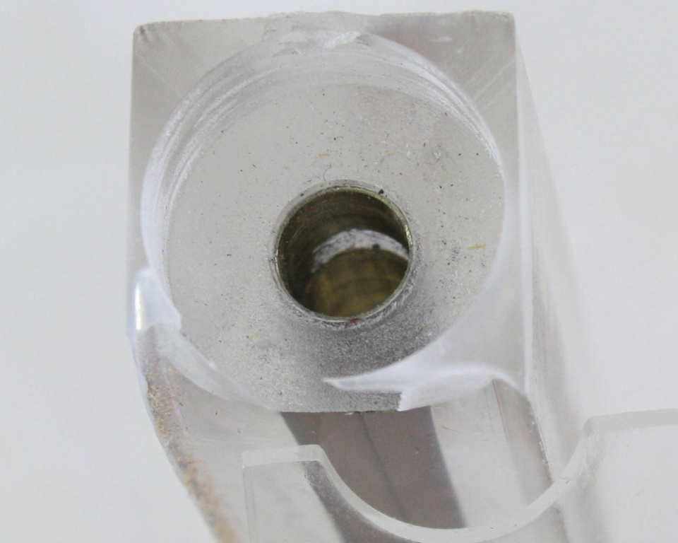

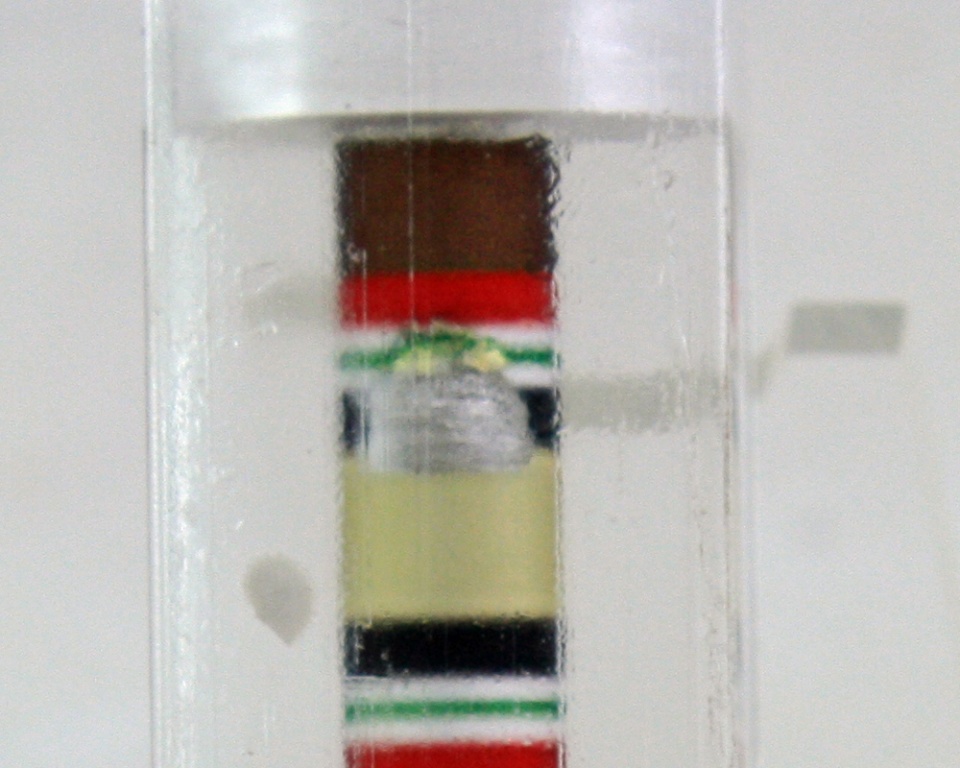

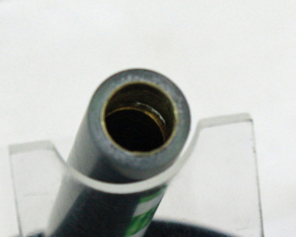

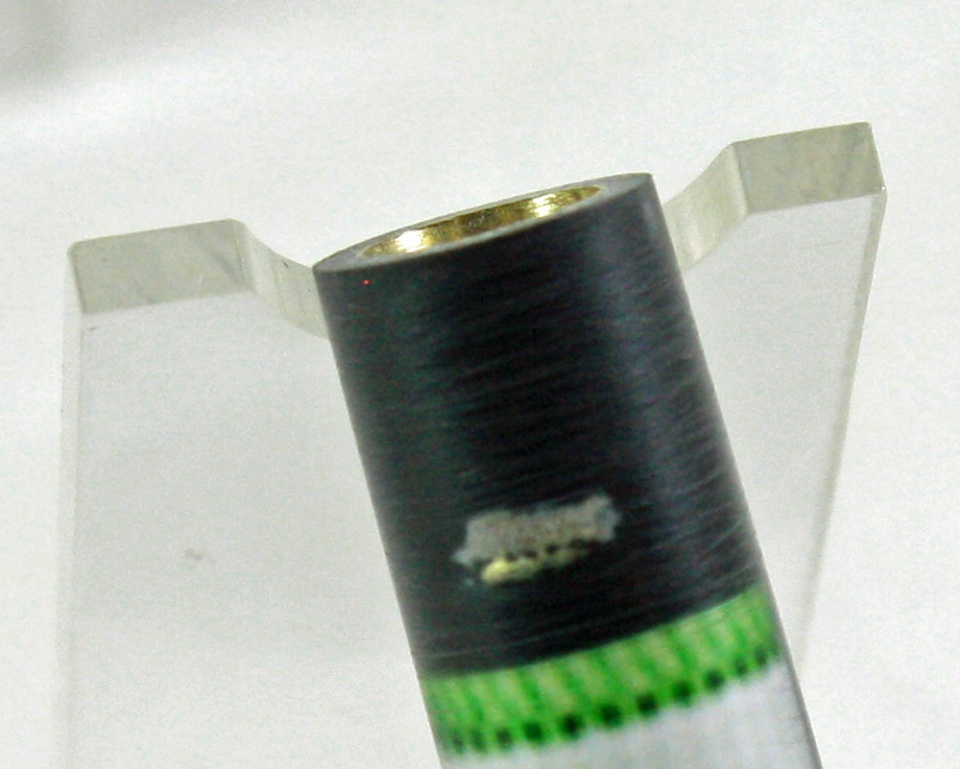

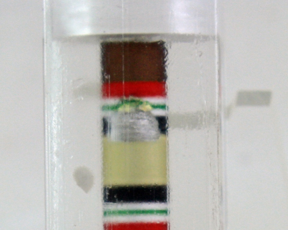

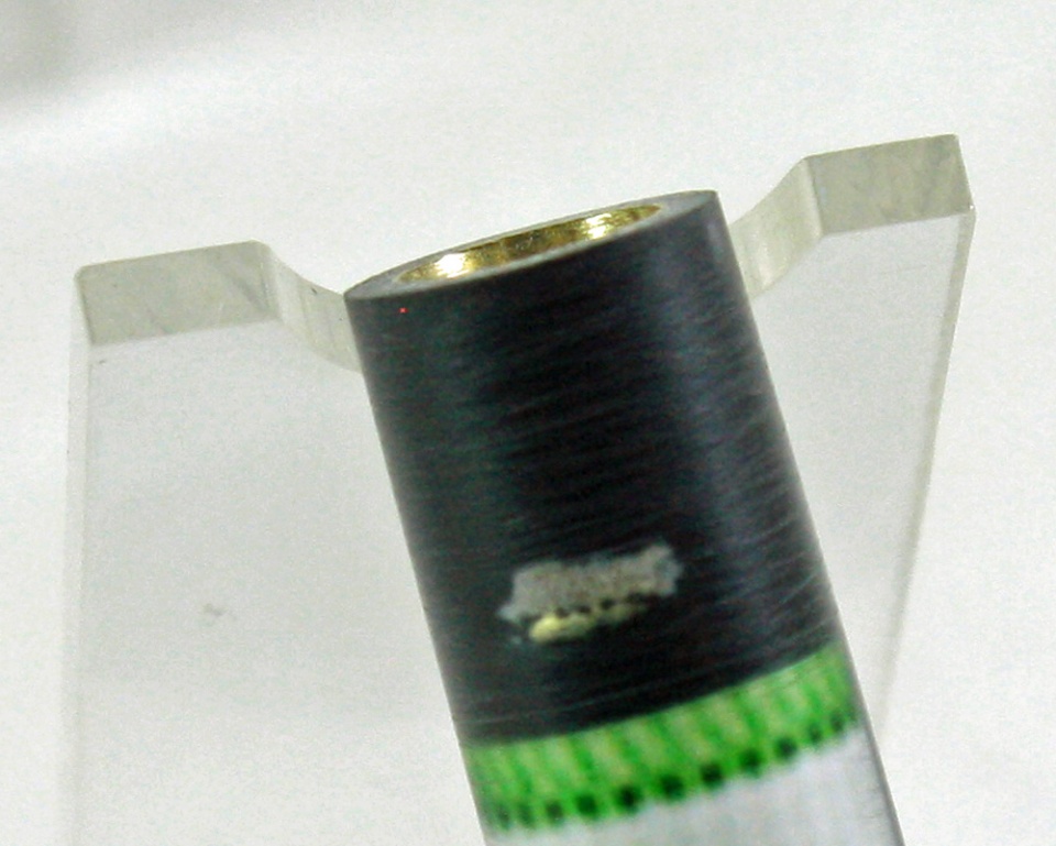

I received these blanks in the mail today from a customer. I am not going to make a lot of commentaries because I do not want to sway or influence and responses. I will, however, give the best description I can.
These label blanks were cast on 8mm tubes. Both ends of both blanks have been milled. Damage occurred on one end of both blanks. A small portion of the interior of the tube was cut away to the underside of the label. At the side of the damage that is farthest inside the tube, there is a shoulder of brass where it was pushed up. There are circular striations, running down the length of the tubes.
What caused this? I would like to identify as many contributing factors as possible. Any possibility is on the table.
I realize that this may somewhat duplicate this recent thread by NewfoundlandLaw. I didn't want to encroach on his thread and I am hoping to have these particular blanks addressed.

Give them replacements in order to keep them happy but square it first. Pen mill damage and trying to explain what happened may be taken as criticism and may not go over well. Let them know that you won't replace another if they do it again. They may still blow up the replacement when they attempt to turn it. You might want to turn it round just to minimize that possibility.
As per Sylvanite, the end of the shaft cut into the tube.
The pen mill was already turning, (as in a hand drill or a chuck in the headstock), when the blank was put onto the shaft of the mill. The tube in the blank was not positioned parallel to the shaft of the pen mill. Since the pen mill was already under power, circular striations would occur as the blank / tube was pushed down over the spinning pen mill. Since the blank/tube was not at the correct angle, the end of the mill shaft would dig into the brass tube and push up a ridge while cutting that part of the tube down to the label. There is probably a limit as to how much of the inside of the brass tube can be cut away based on the maximum angle that the pen mill shaft can be out of line with the inside of the tube.
The same situation occurs if the blank is spinning when the pen mill is inserted into the blank at an angle.
Couldn't tell from the pictures if the ends of the blank were milled square / perpendicular to the tube.
Very good, except that I found my error and damage would occur on insertion (wouldn't try to hit a hole with a spinning bit) but on retraction.
Insert shaft into blank, apply power to square end and, under the premise of cleaning the tube, remain under power on extraction of shaft from tube.
It is a rather natural act of the hands to separate in an arc, not a straight line, causing the flutes end of the pen mill shaft to catch the brass tube near the end of the removal.

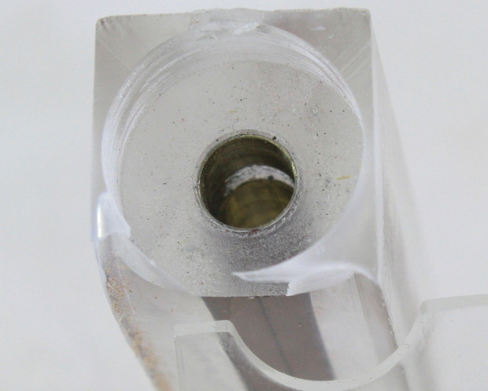

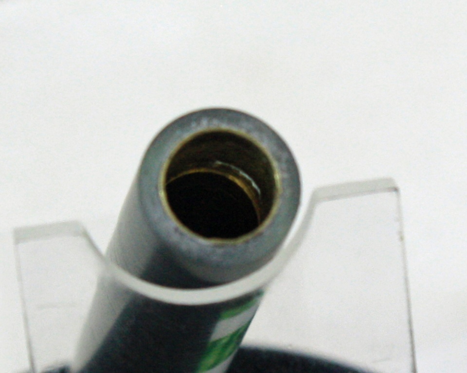

As to the blanks in the photos, I've made similar looking marks by using a barrel trimmer in a vise on a drill press when re-inserting the spinning bit. Ruined a few very nice pieces of wood that way. Switched to a jig on a sander, no problems since.
