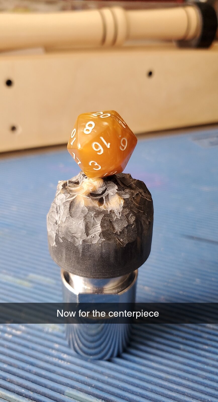

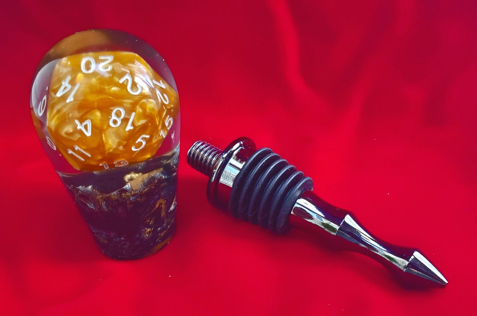

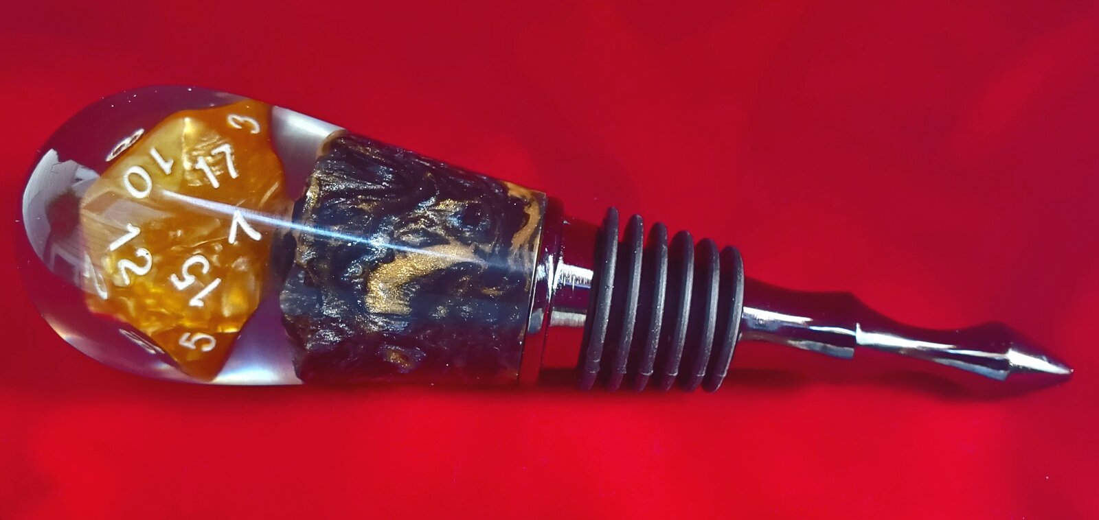

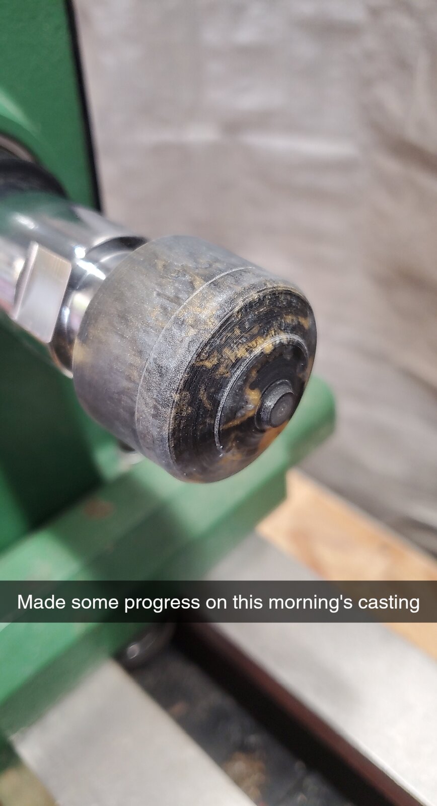

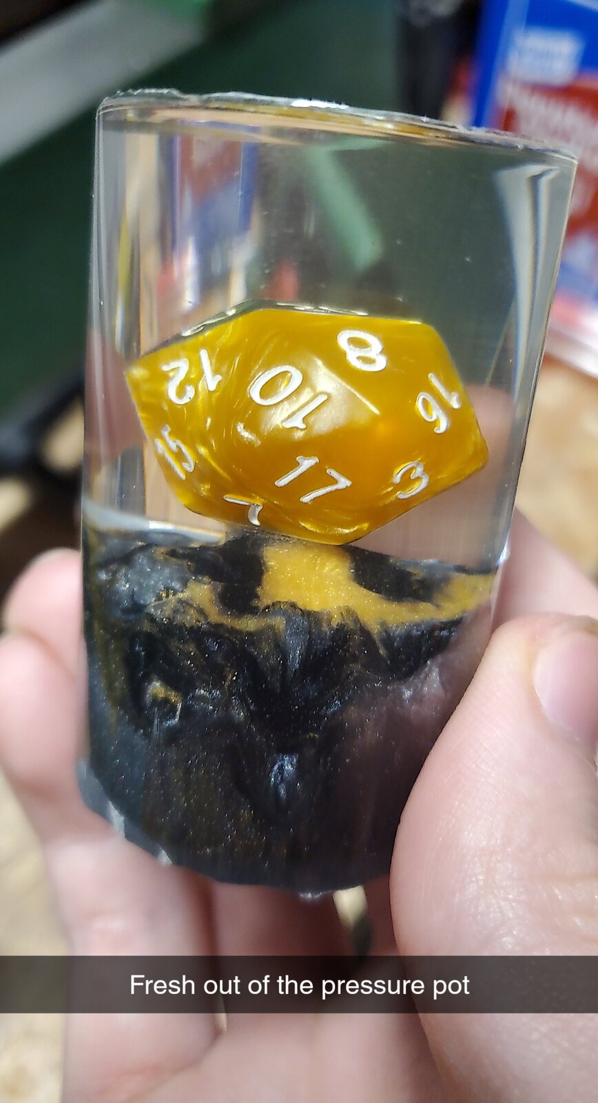

I had a customer request a Dungeons and Dragons themed bottle stopper for her brother-in-law. I casted a base with black/silver/gold resin, and then carved some texture into it with the dremel before gluing down a D20 die (the most used die in the game) in the center. I finished the blank by re-casting the piece in clear. I just pulled it out of the pressure pot this morning, and I'm very pleased with how it came out.

You could also try using Liquid Diamonds resin. It's extremely thin when mixed, and is advertised as not needing a pressure pot. I've always pressurized LD just cause I already have a pressure pot. But I've also casted without pressurizing it, and had no bubbles. For this application, I'd recommend using an epoxy resin instead of Alumilite. The kind of plastic used in the dice doesn't adhere to Alumilite very well, and can lead to weird voids around the die in your finished casting.
