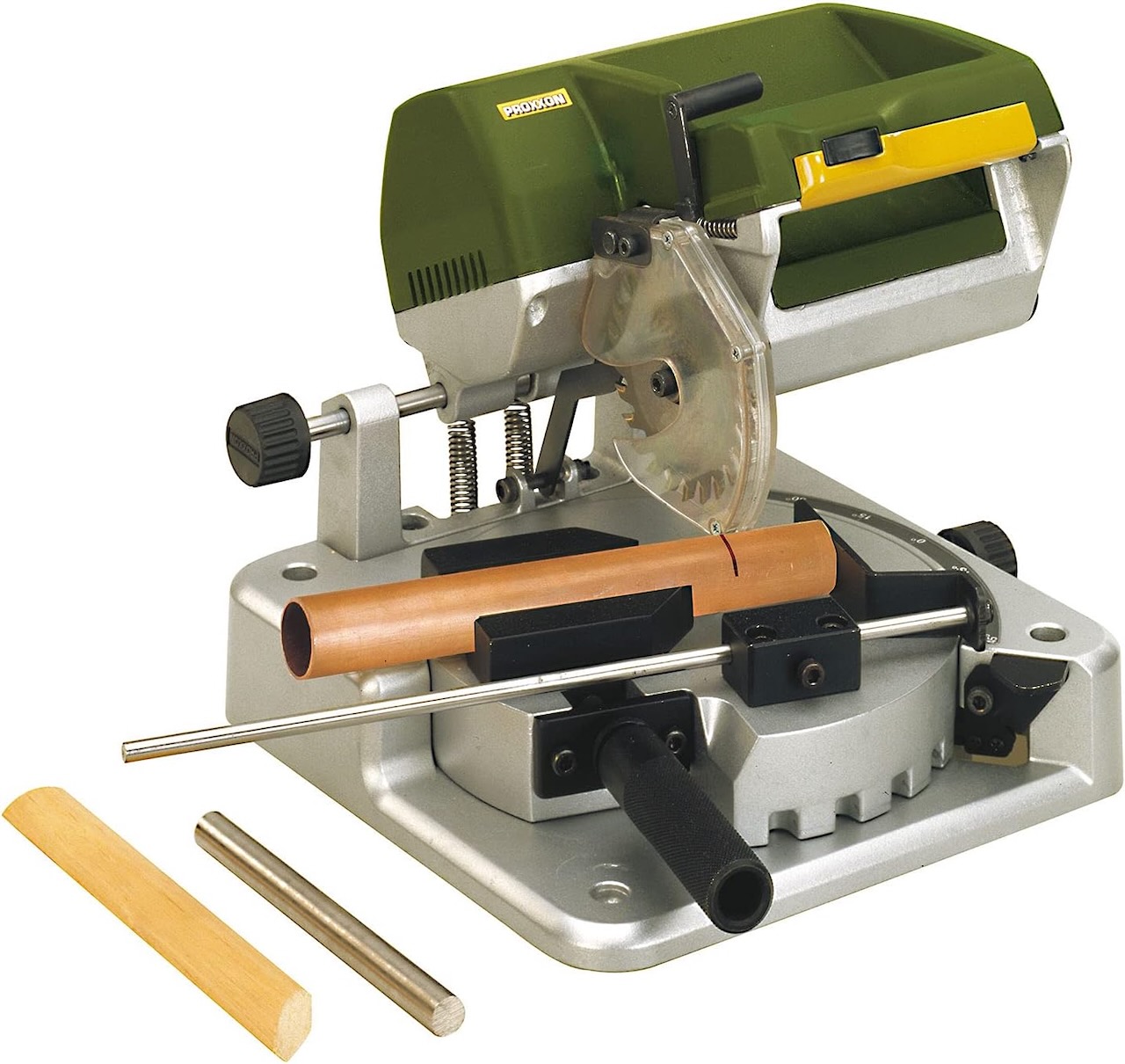

Proxxon ... I love the mini chop saw. Small. Lightweight and powerful.
I also have a Wen from Home Depot.

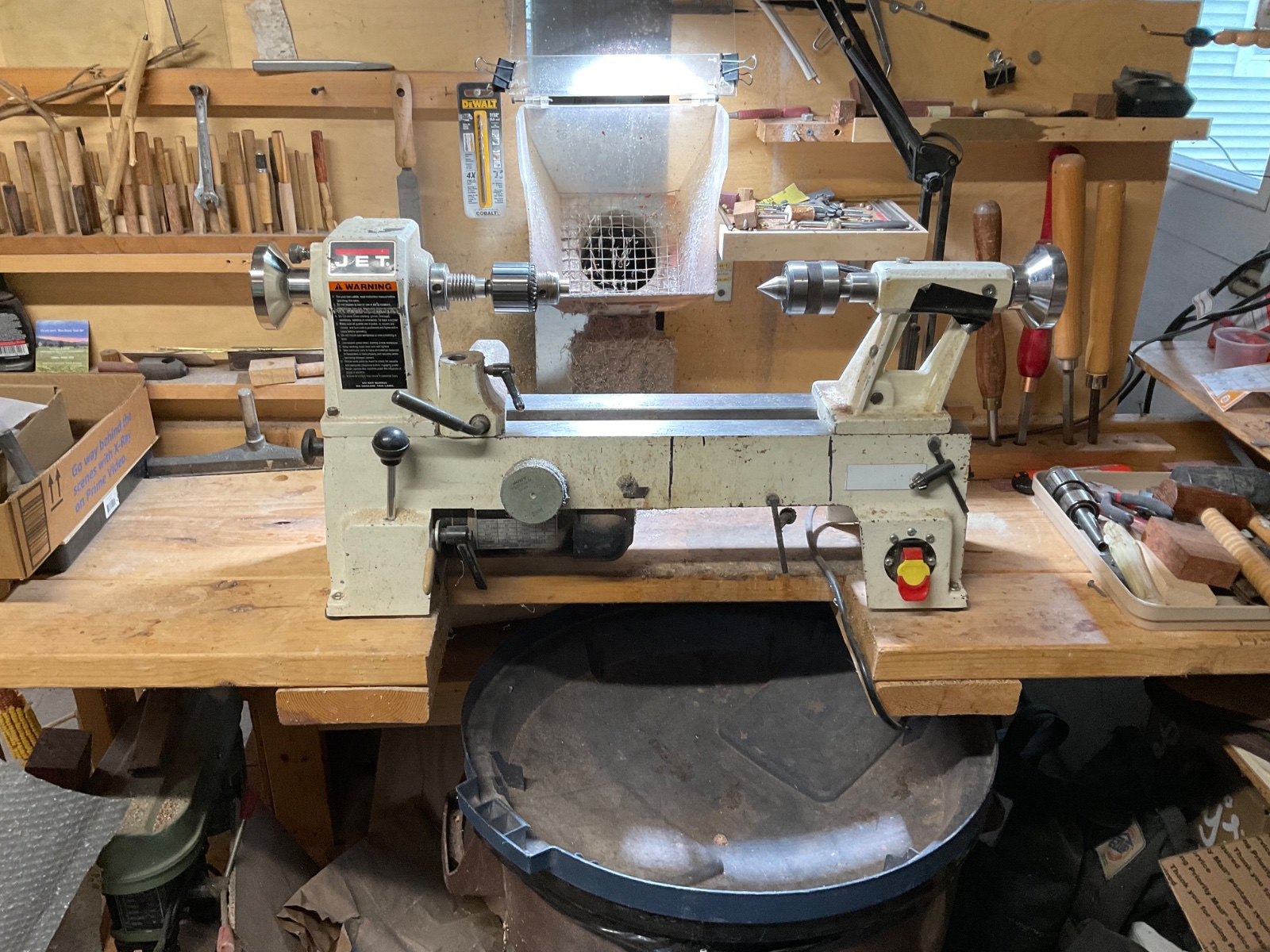

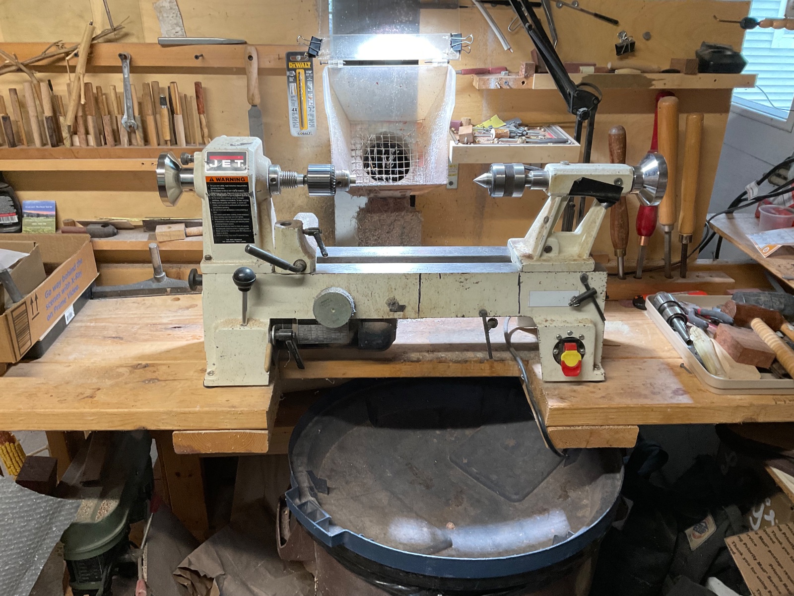

This is my lathe setup. T
