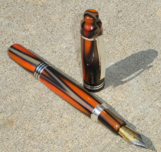

Yes, Butch, I agree about keeping within some standards. I should clarify that what I said is what can be done and not necessarily what I do...easy to get confused. I practiced cutting threads for a while and quickly learned that I can cut a million thread sizes and styles with just a single cutter. I switched out to a specific cutter tip for .75, which will only cut those threads, because that is the size I chose for my couplers. Now I do not have to worry much about diameter. If I cut a thread, I can duplicate it over and over again, just buy measuring the OD of the threads. This does make life easier for me.
For a nib feed, you can shave off the threads on it and slip a threaded insert over it, and the housing can also be shaved down and a new one slipped over that. Don't worry about the taper, the plastic sleeve on an El Grande has a taper, but can be turned down and straight. You also have the option of buying Lou's nibs and he has taps that fit his nib housings. His housings are straight and can still be added on to.
This is an El Grande. The housing was shaved down thin and a new housing was made and slipped on with some epoxy.
