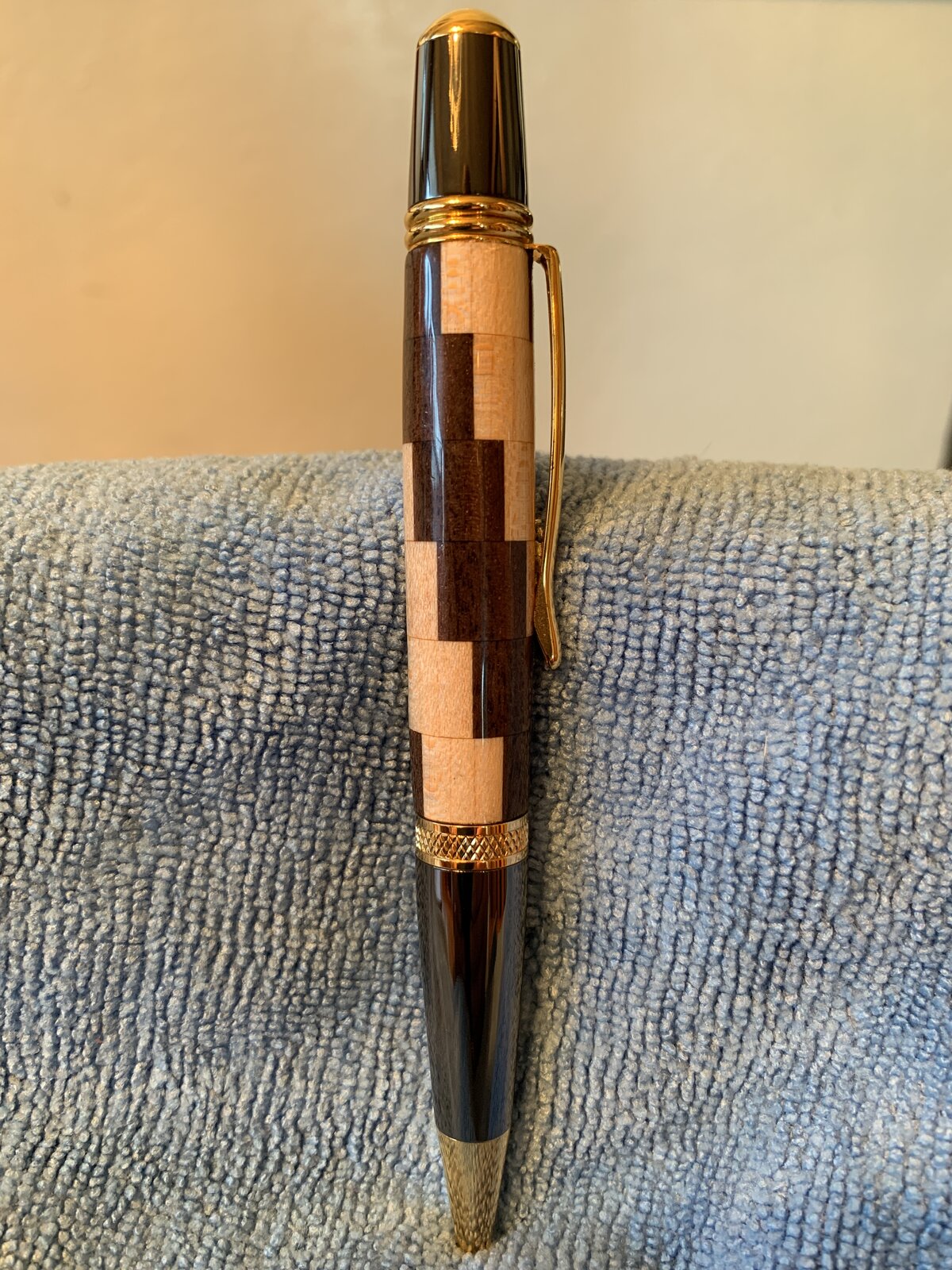

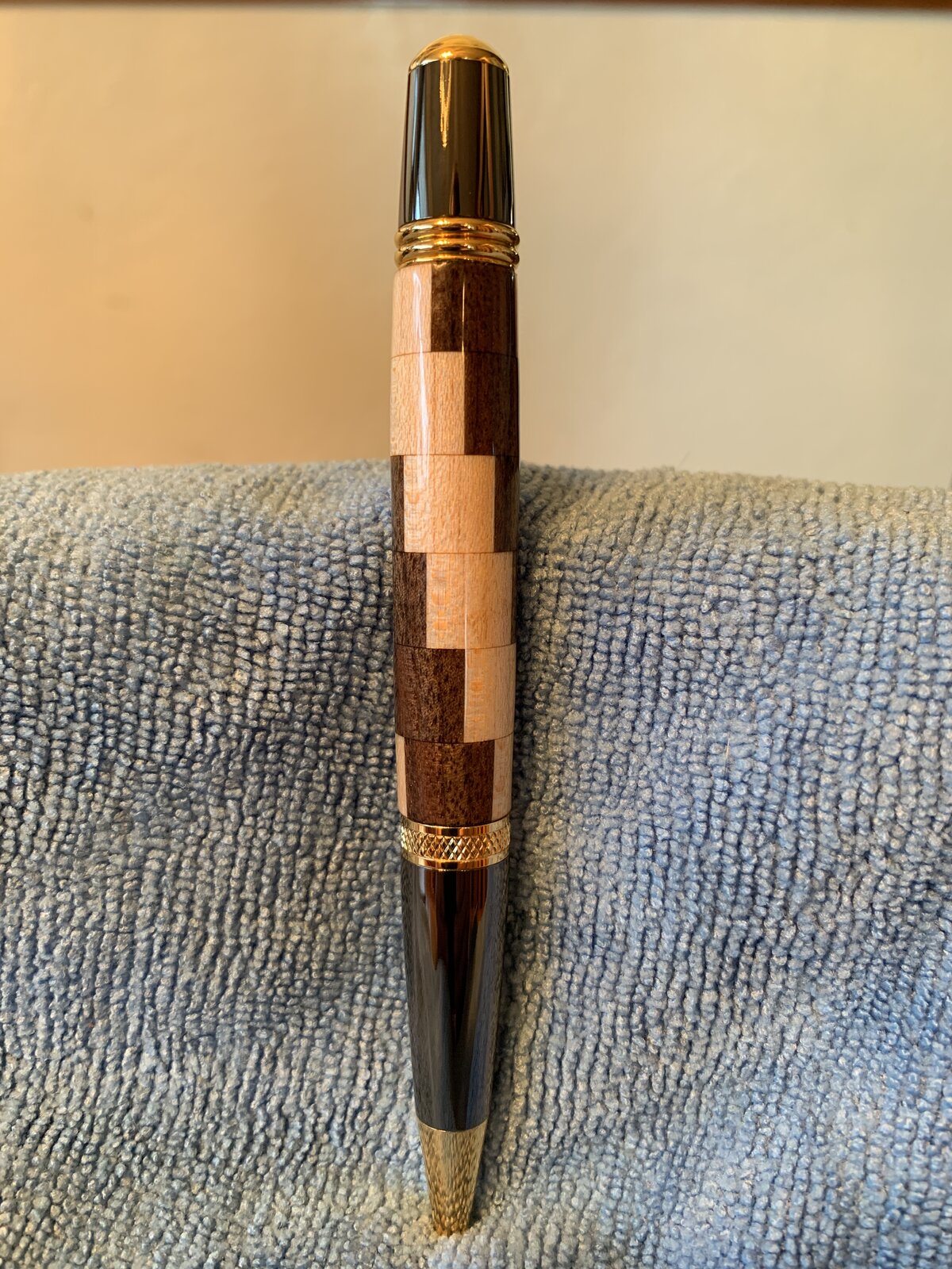

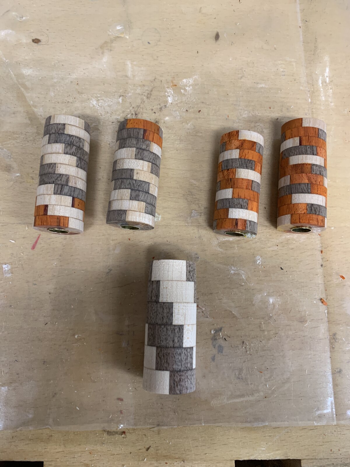

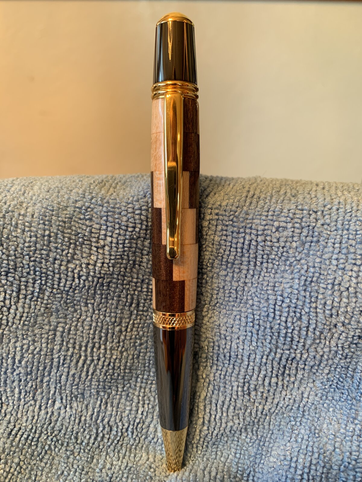

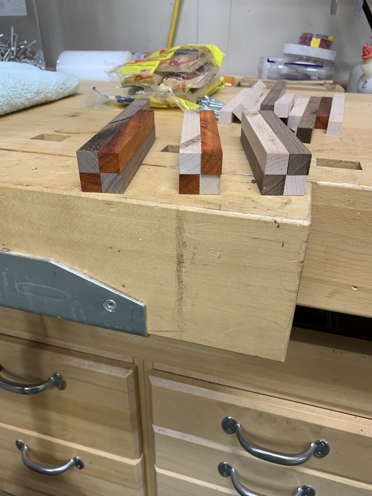

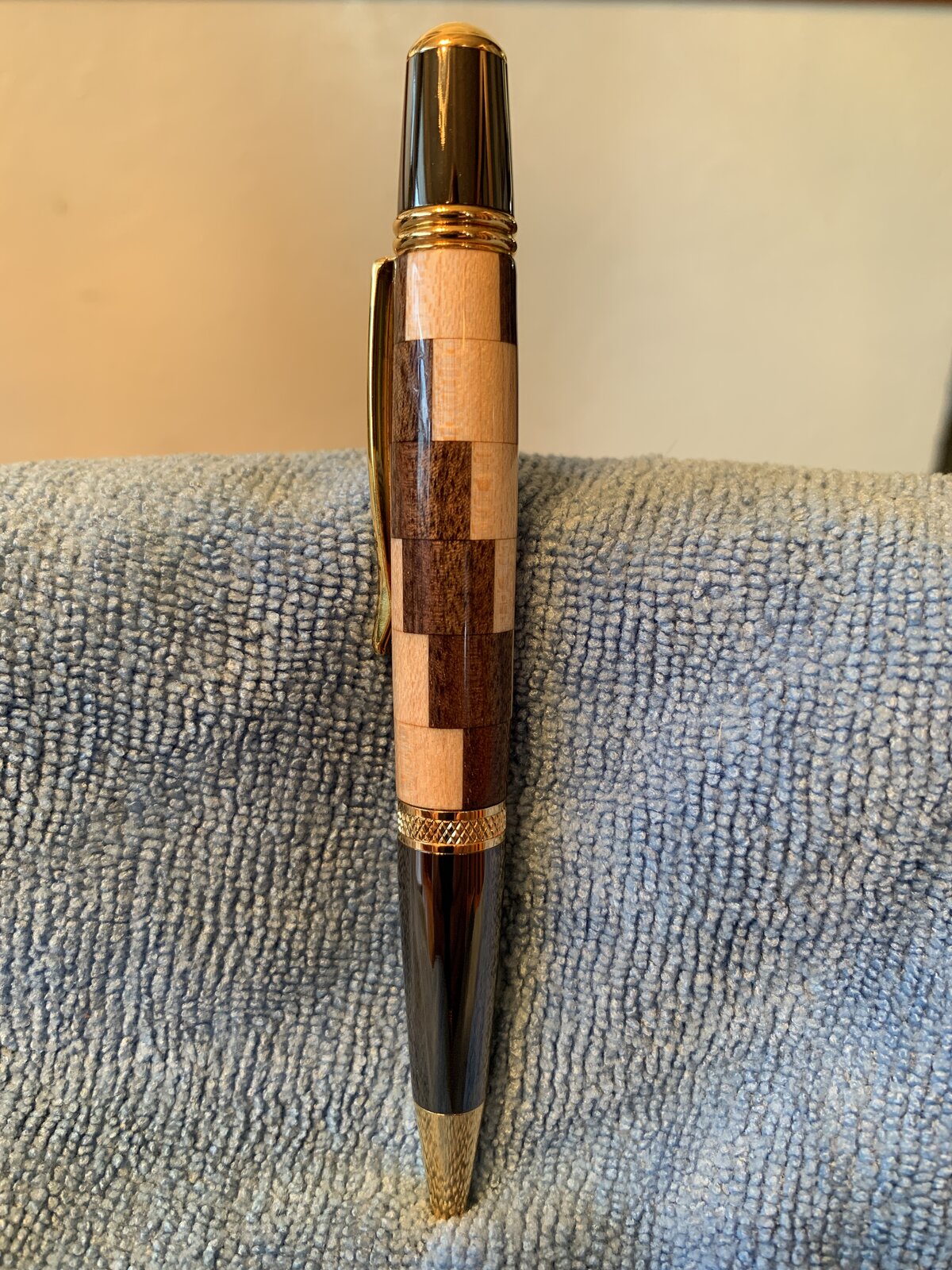

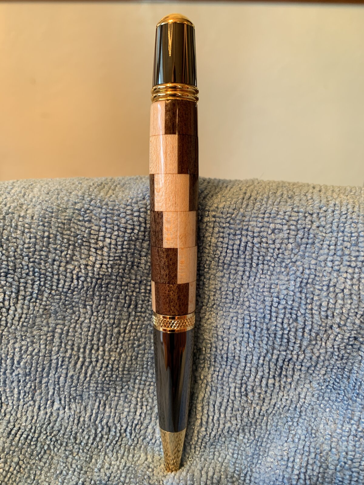

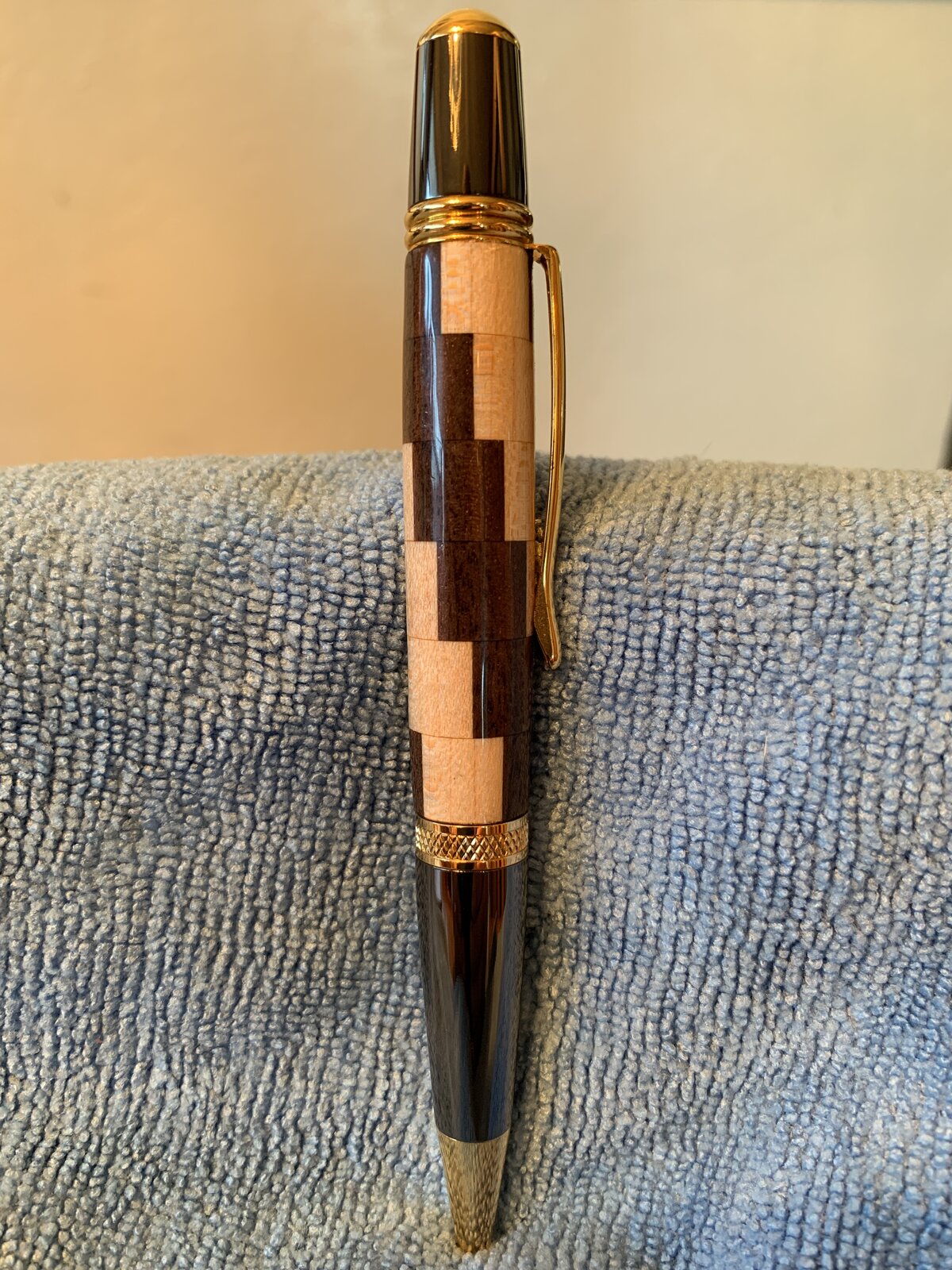

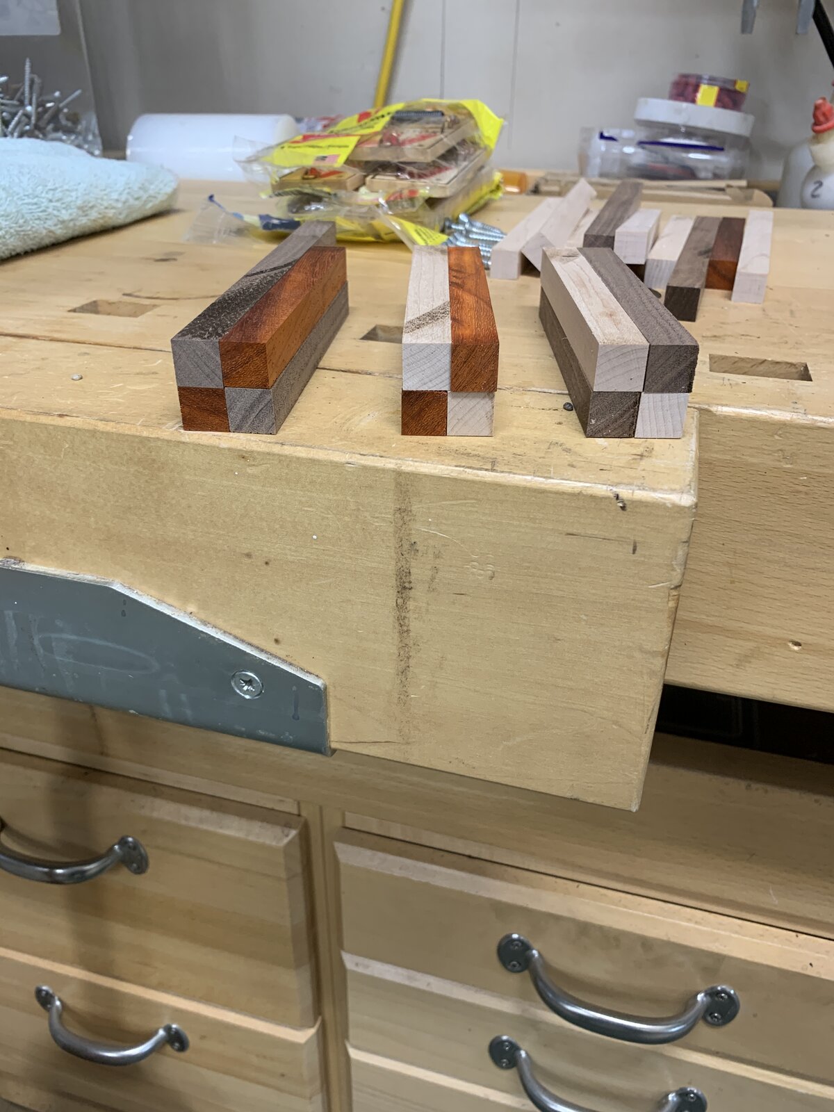

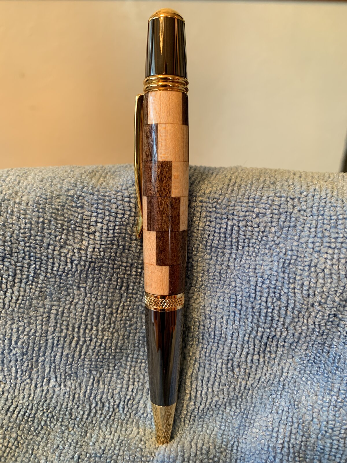

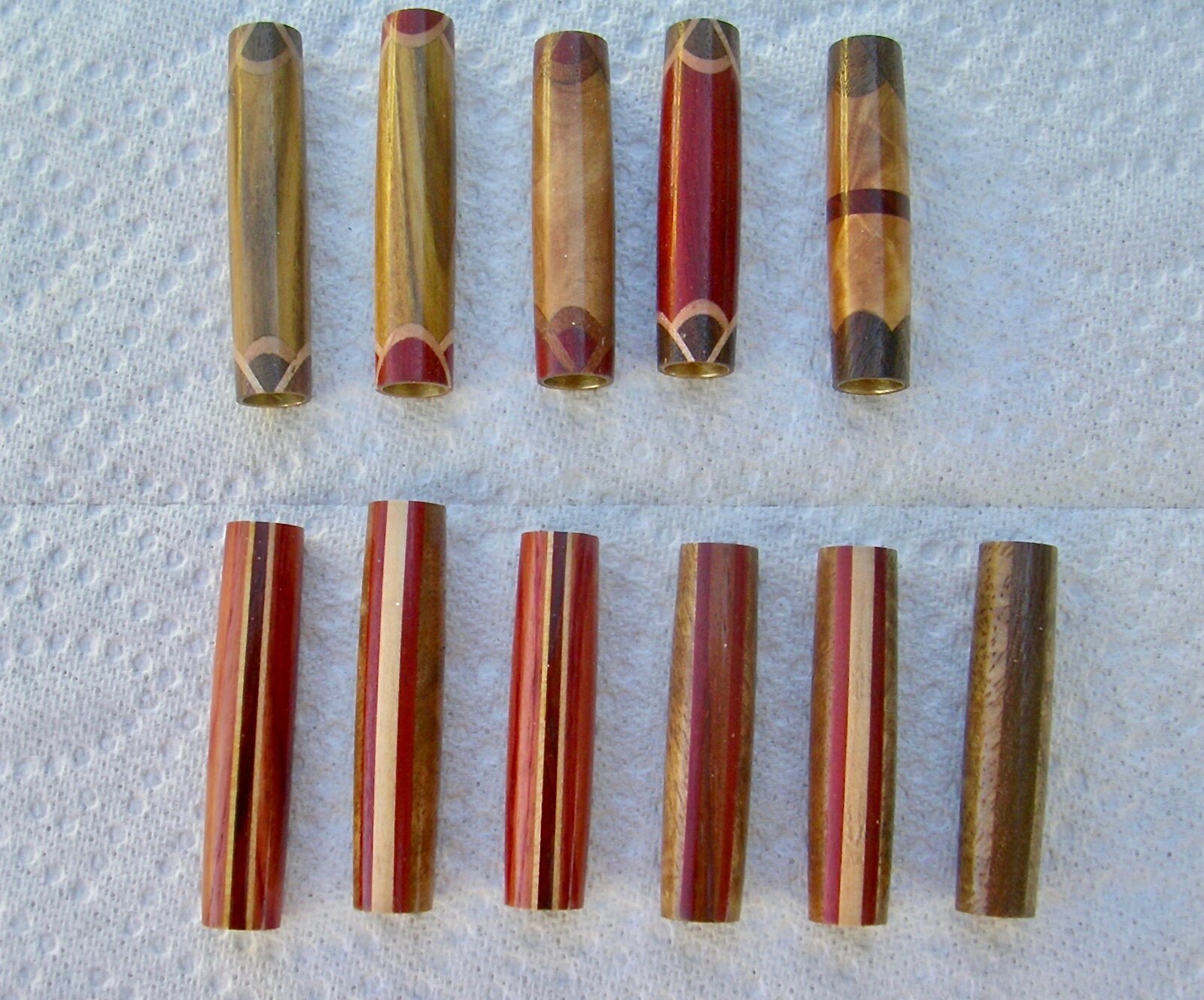

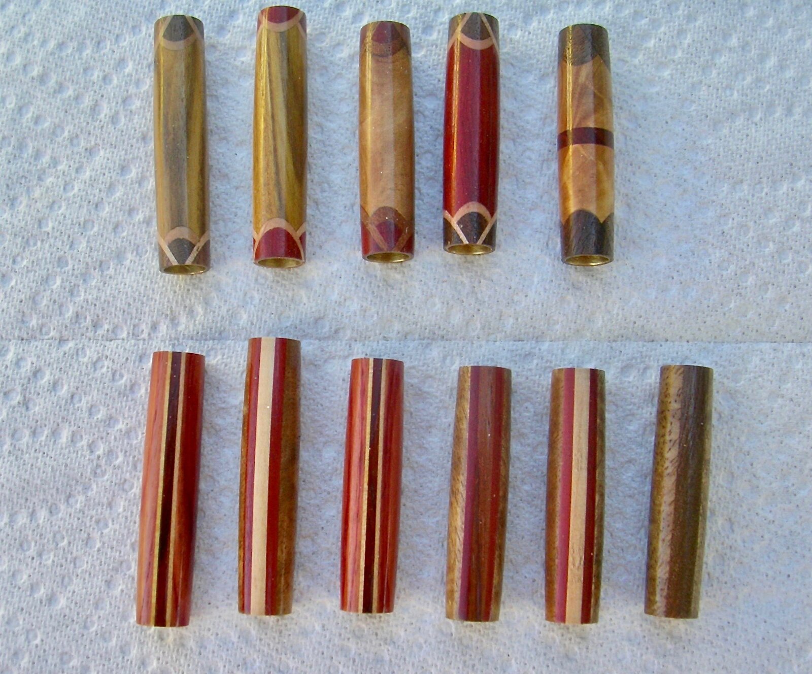

I have finished a couple of segmented pens. They were composed of four 1/2"x1/2" squares glued into a 1" square blank, turned round for a 7/8" collect for drilling, cut, and rotated. Cutting the initial 1/2" square stock on the table saw was not a comfortable process. I would like to cut 1/4" x 1/4" square stock but need a better grounding in saws and jigs.
Thus the question; Is it preferred to cut segment stock on the table saw or band-saw? What is the preferred blade for the saw of your choice? What is the preferred jig?
Please feel free to send pictures.

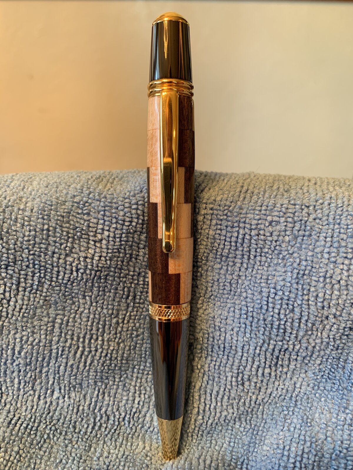

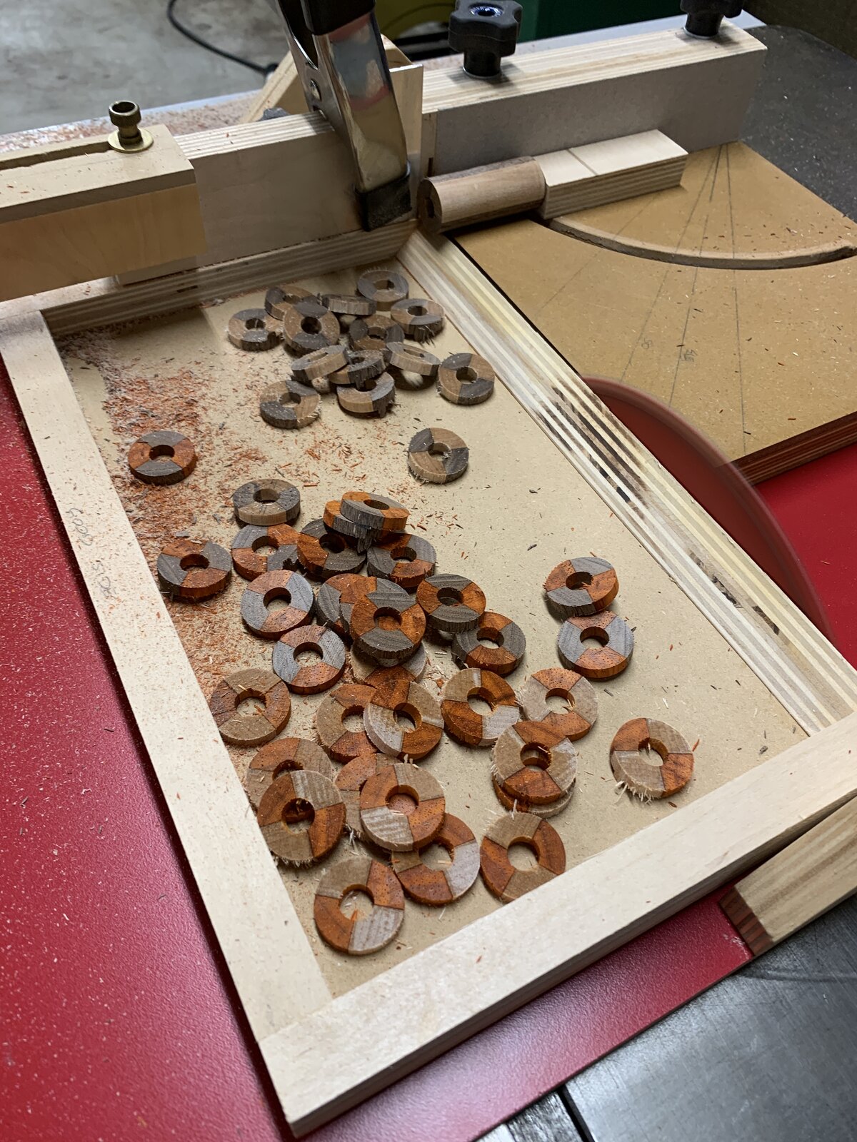

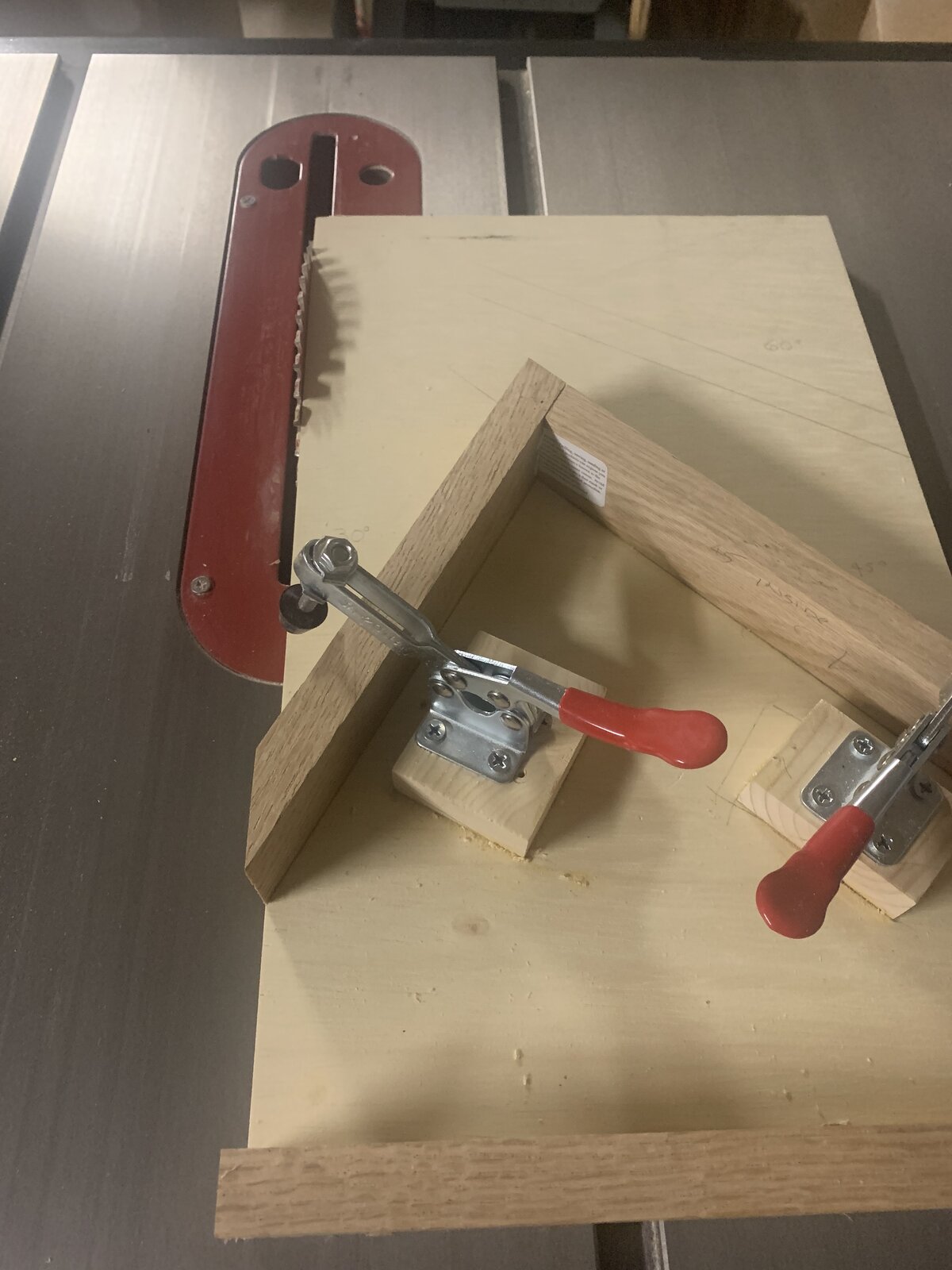

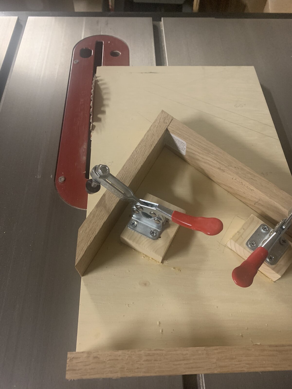

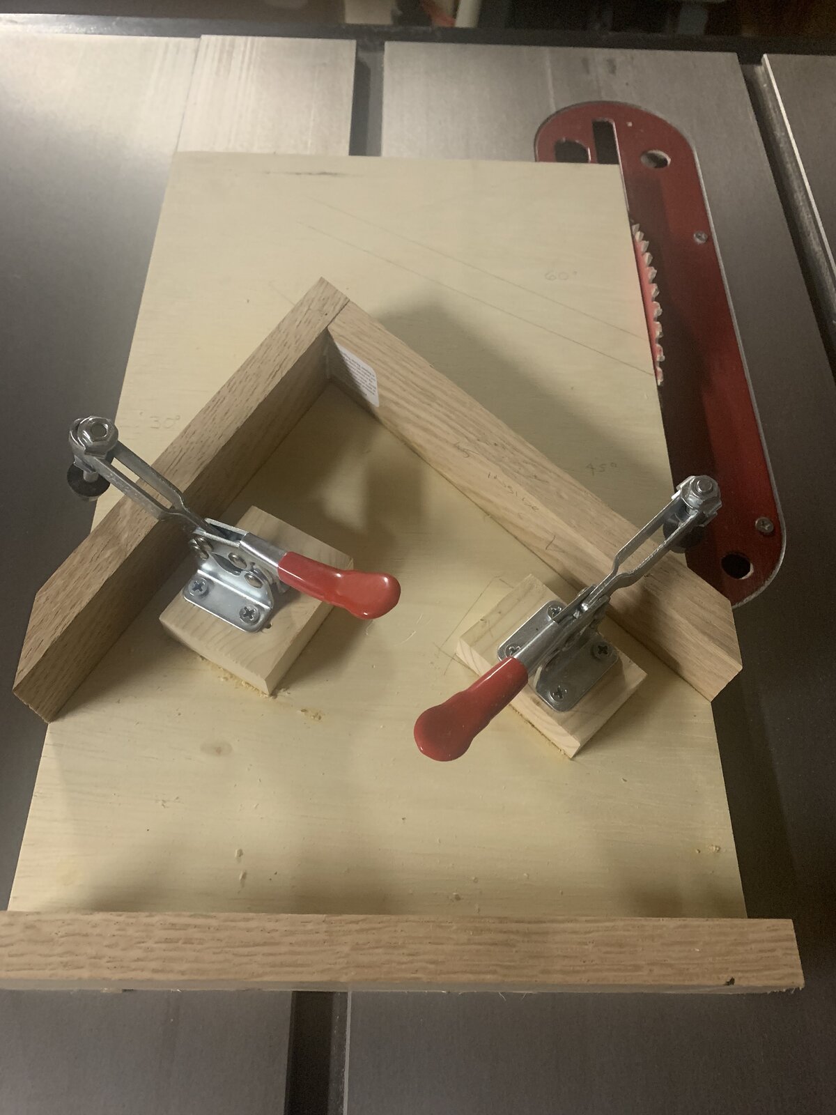

I don't really buy special blades. My table say has a thin kerf Diablo 40 tooth combination blade. Kerf is .102. My bandsaw has a Timberwolf 3/16 blade, couldn't even tell the tpi, the kerf is approximately .040. I have many many jigs that I use. You can't be as precise without them.

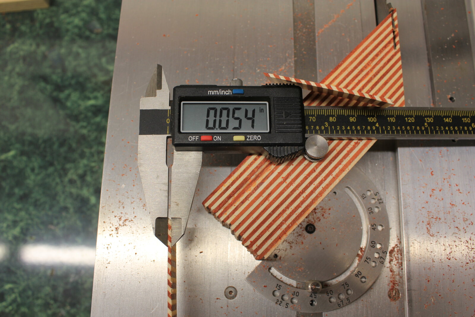

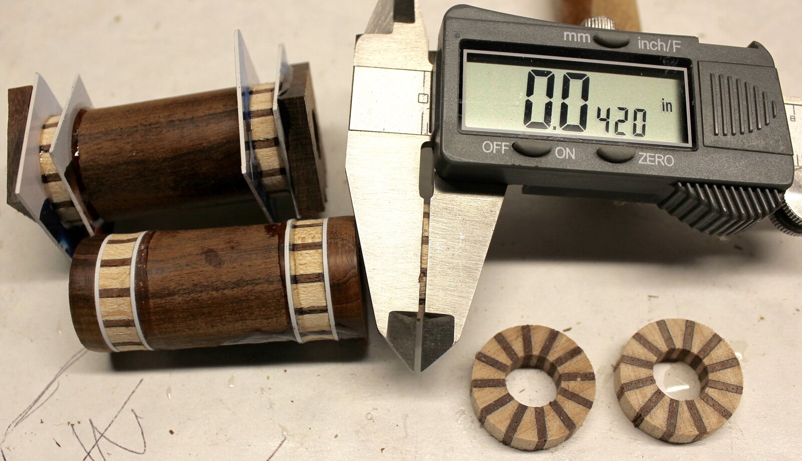

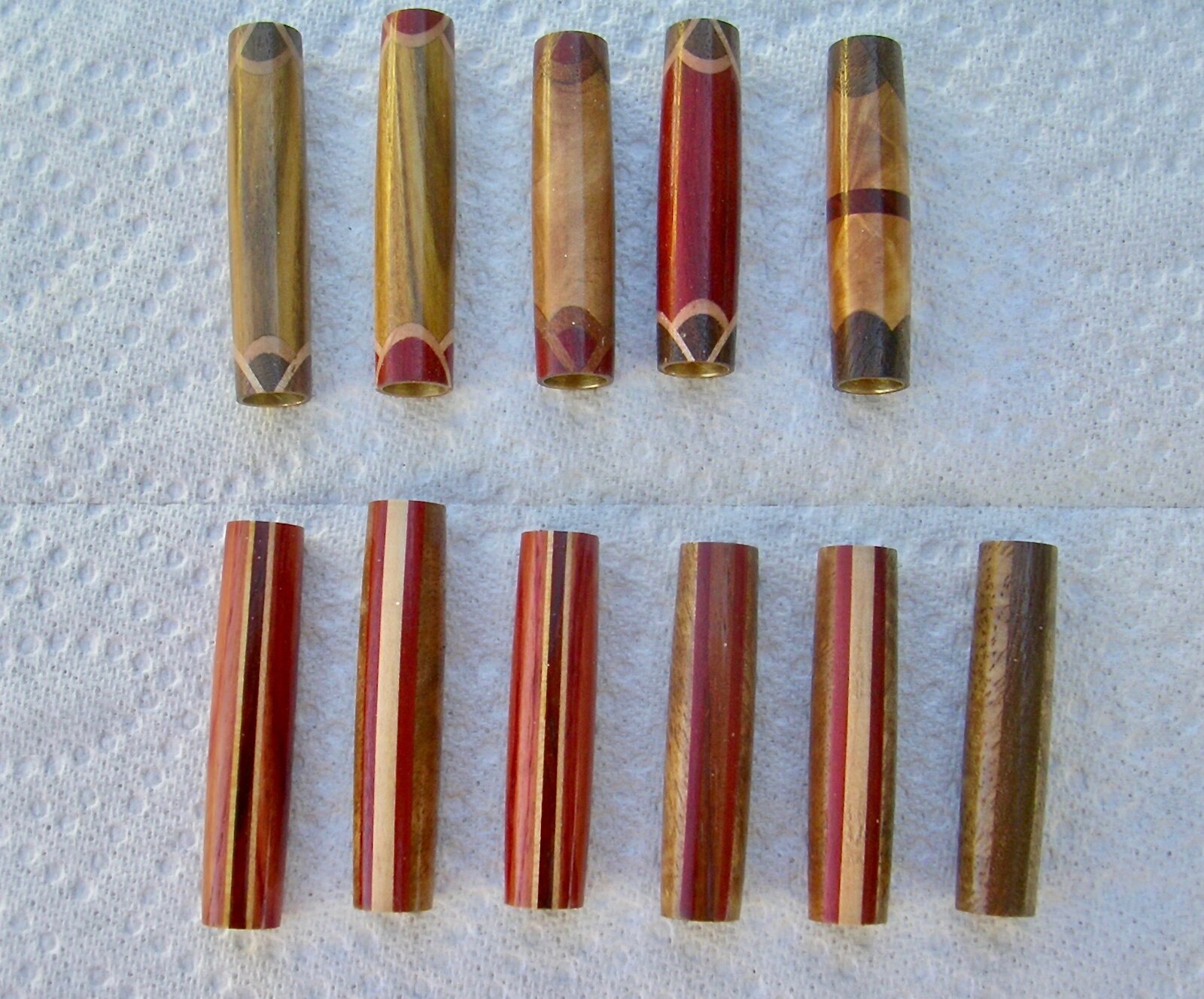

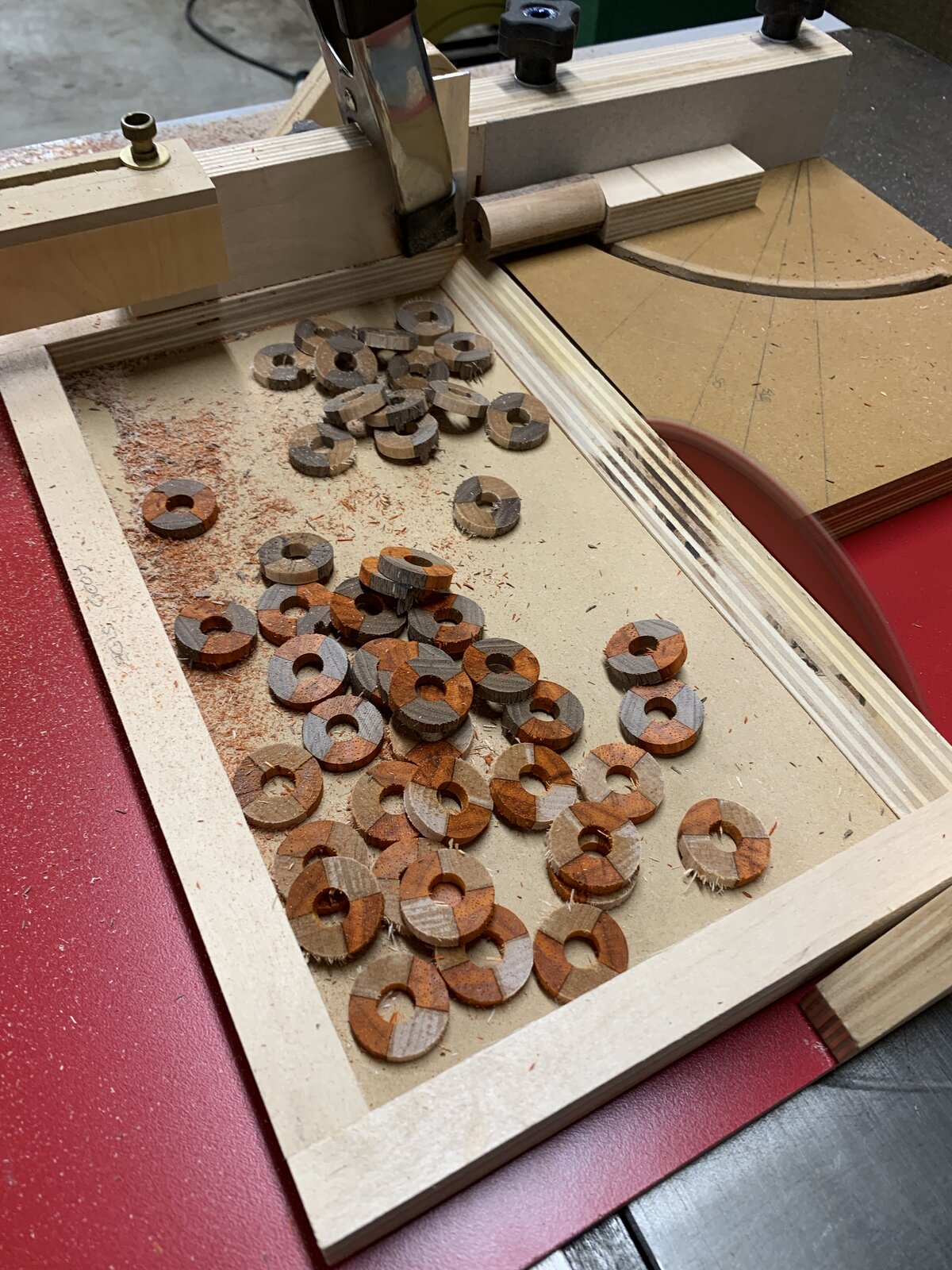

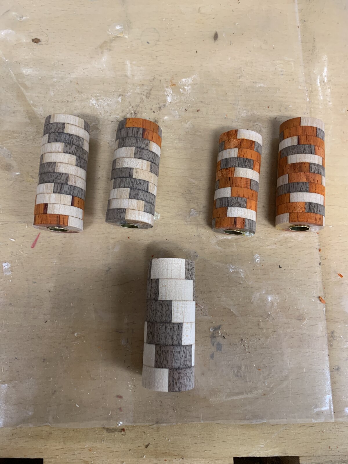

All the comments from Ken above are excellent. I'll only add... learn how to use what you have - SAFELY! Most saws will allow you to learn how to give you the precision you need. But, proper jigs are a must. I have used a Bosch contractor's table saw, a Rikon band saw, a Craftsman band saw, a Craftsman table saw, and a Byrnes Model Makers Table Saw for the same cuts.

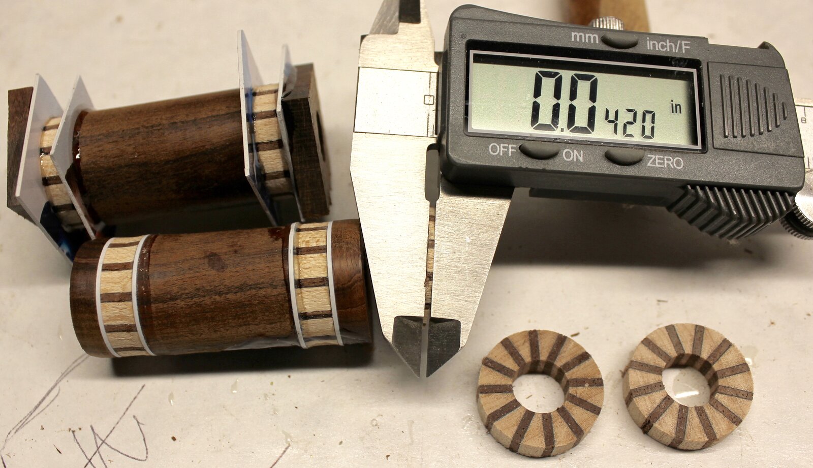

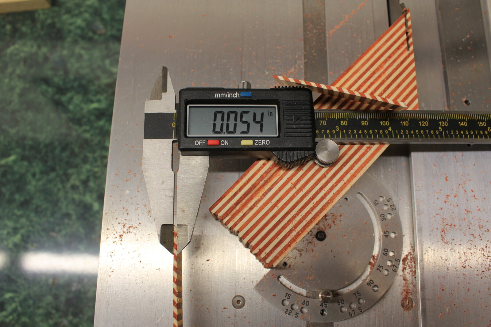

You did say to add pictures, so...
And, the three photos are with segmented trim rings with many glue joints. Get used to failures as you learn to use your tools safely, be patient, note why you failed at times, make tweaks, refine your jigs (KenB259 is a master for this!), and have FUN!

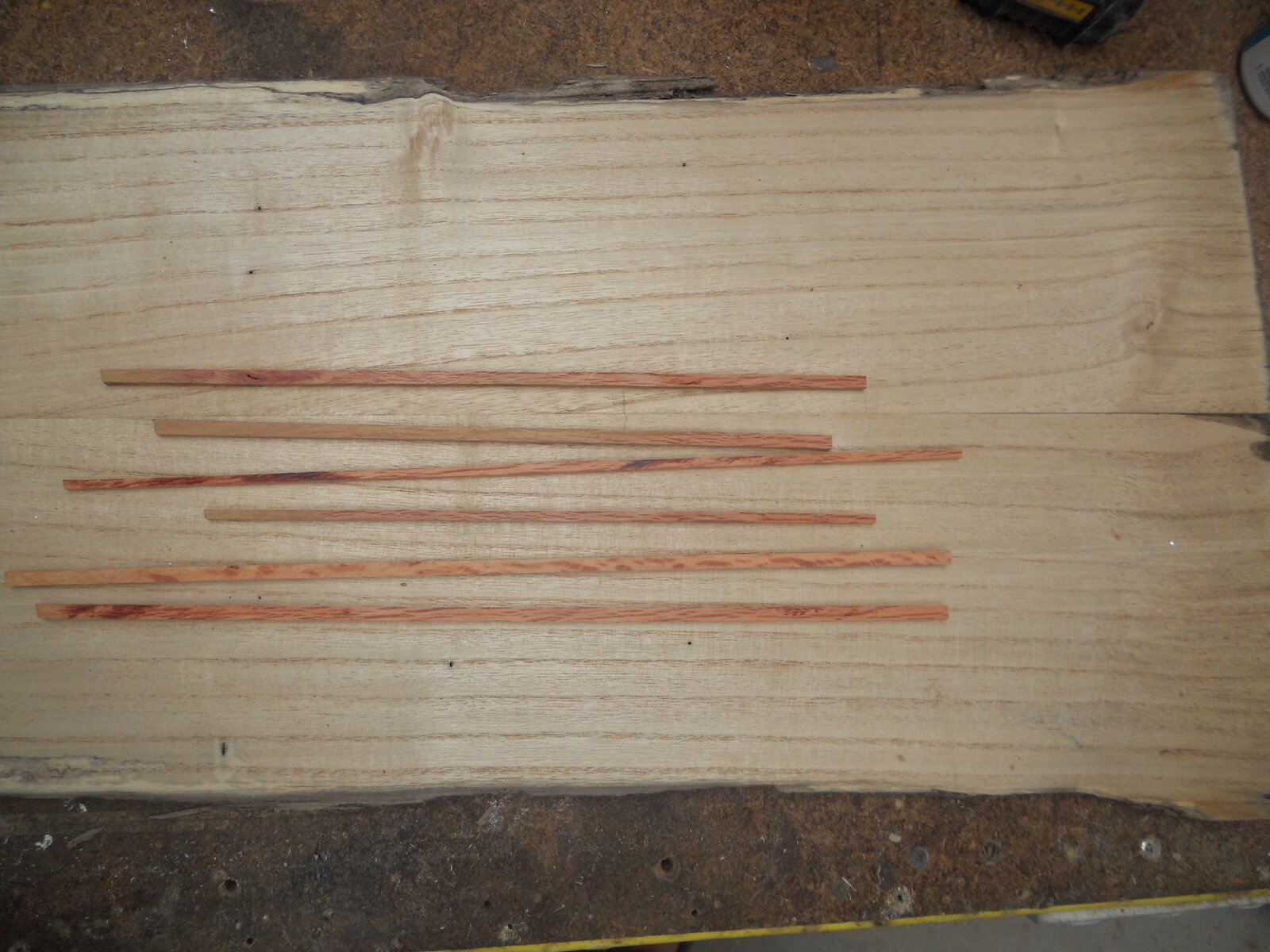

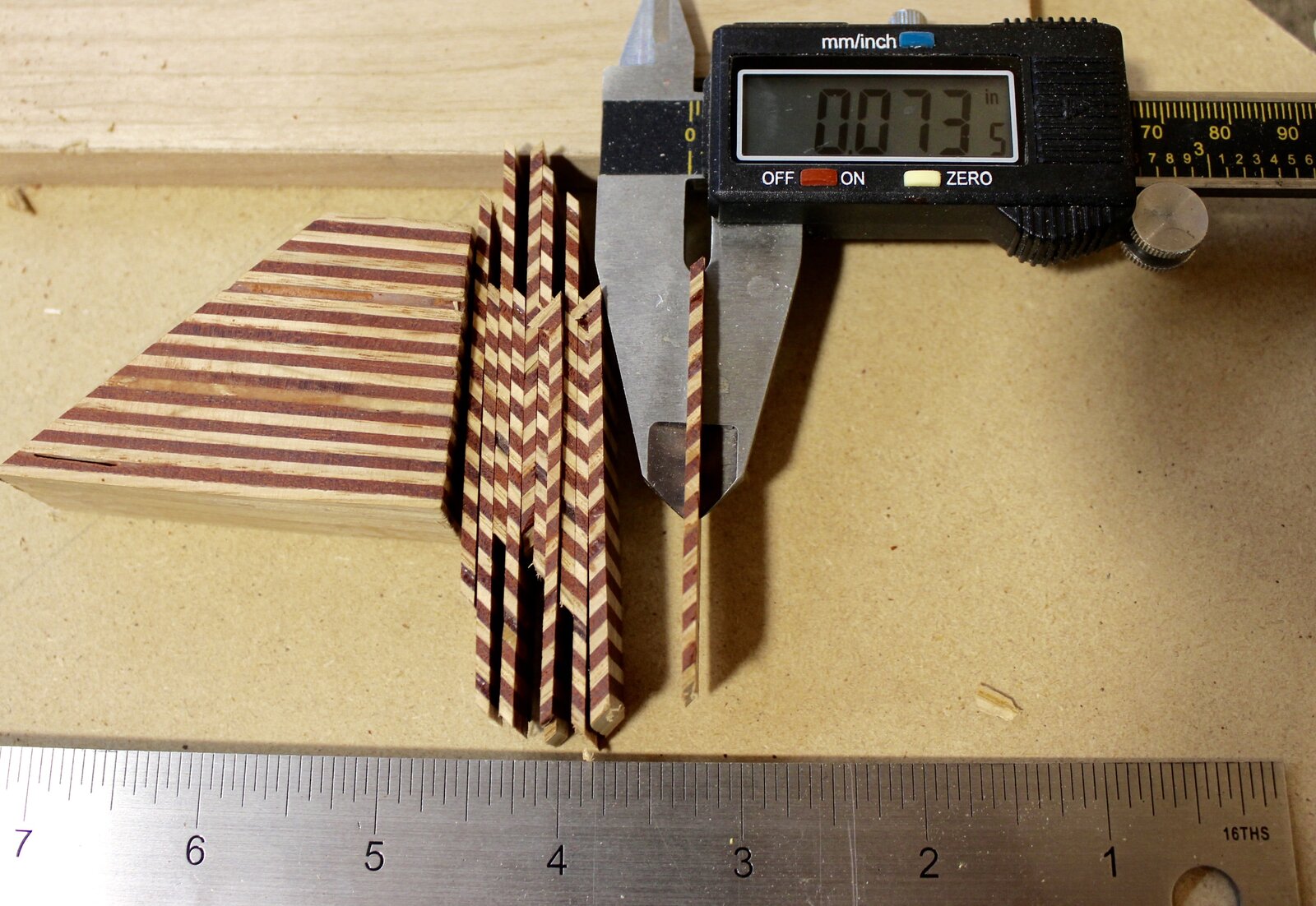

Well, I did go back to Proxxon, then I went to the shed, found a section of Forest Oak that was anything but square, set the saw at 6mm and made some sawdust. I actually ended up with some stuff ranging from 5.5mm to 5.8mm and a bit over 300mm long which translates to about a foot long and a couple of cigarette papers less that 1/4". I worked out that you need a "zero clearance insert" on your saw if you want to do this without dramas. The little Ryobi drop saw has a 7.1/4" 60 tooth Diablo blade which leaves a really nice cut face but once again you need "zero clearance" fences otherwise those little bits you cut off end up somewhere...On the top of the cupboards, behind the mower, you get the idea. Anyway, I took a photo of the little bits I cut and the good part is, no blood loss!

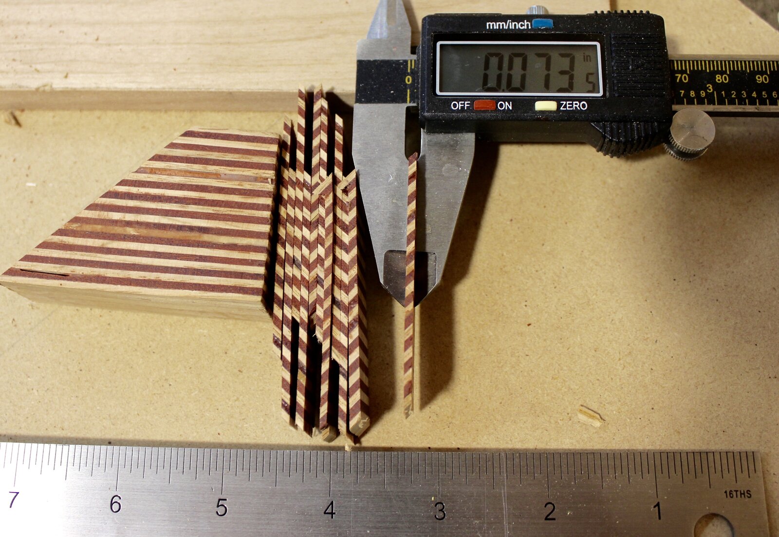

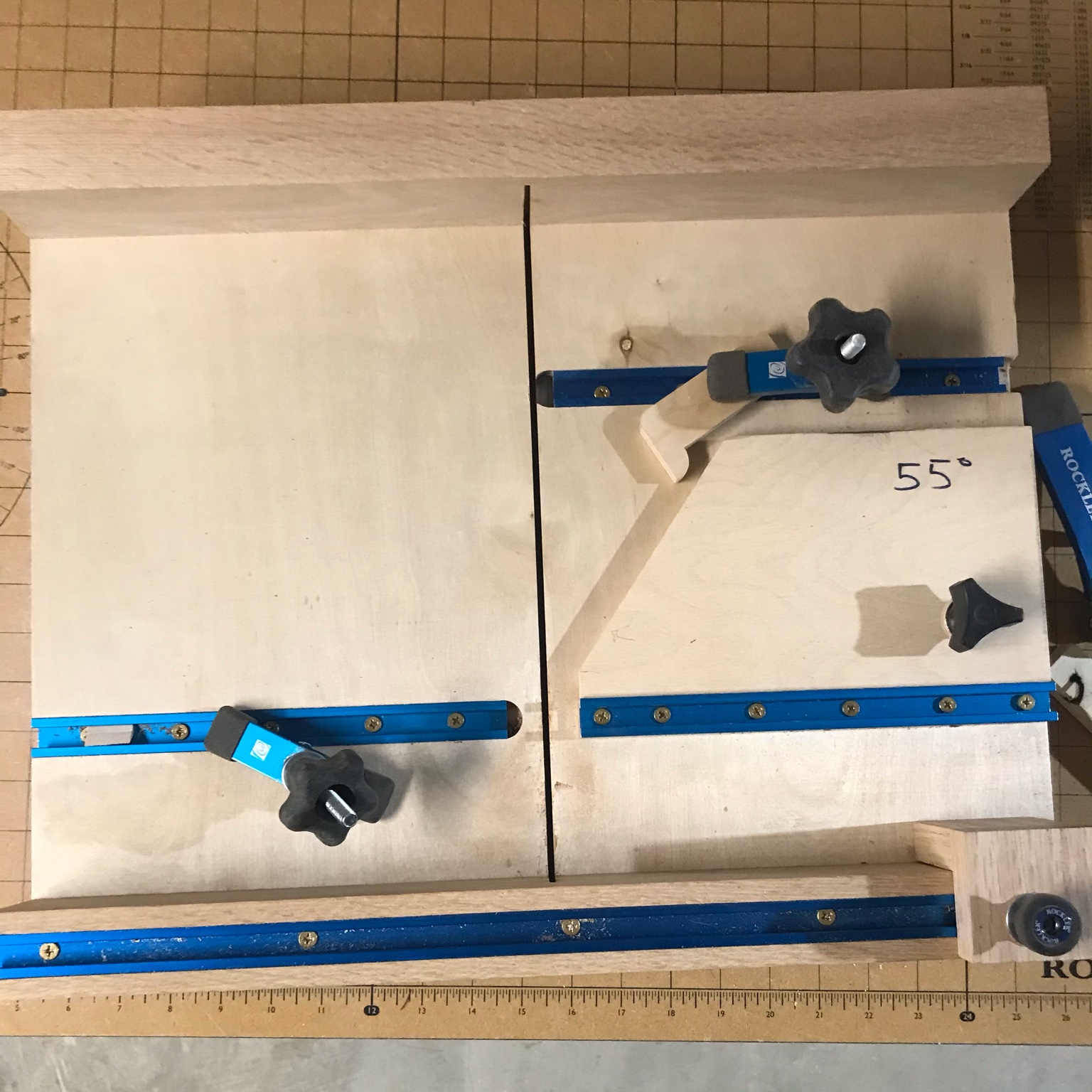

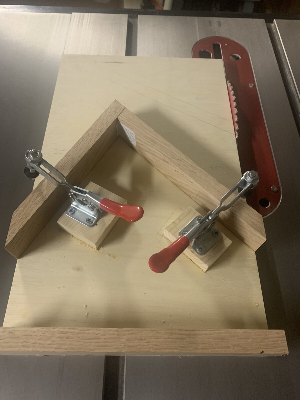

I just wanted to say thanks for asking your question. This was one of the more informative threads yet, Thank you everyone for sharing your experience and ideas. After turning pens for just over one year now (with only a few segmented pens mixed in) I decide this year to focus on expanding my segmenting knowledge. I have used both the band saw and table saw and like most I use sleds on both. I mainly use the table saw because it seems to be more accurate. I am going to start of with scallop pens and just finished making a jig for those (I got the design from Gabe Castro of Exoticwoodpen). The jig is set for 45 degree and 60 degree scallops.
Hi Jim,
You could very easily make Celtic knots with this same jig.
