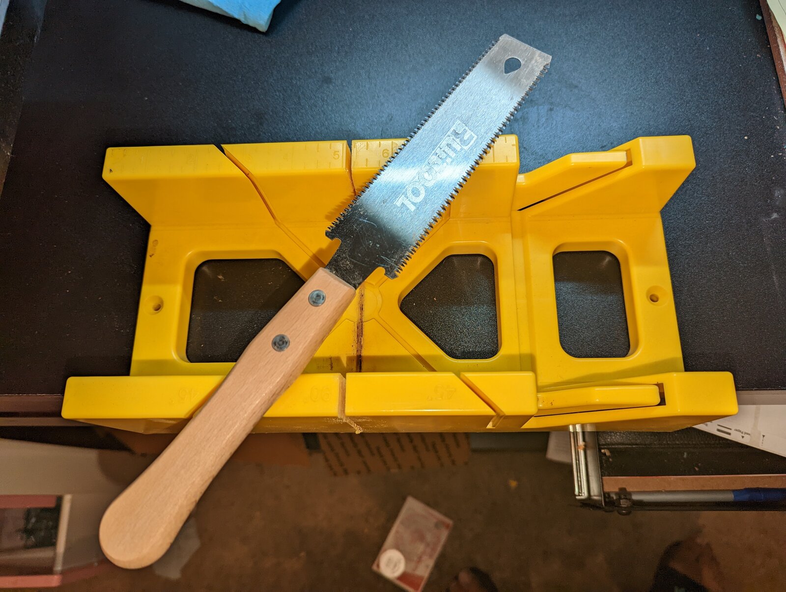

Just wanted to circle back and say thanks. This was some of the best and most practical advice to get me going. Also, I really like the functionaliy of the Japanese style pull saw.
