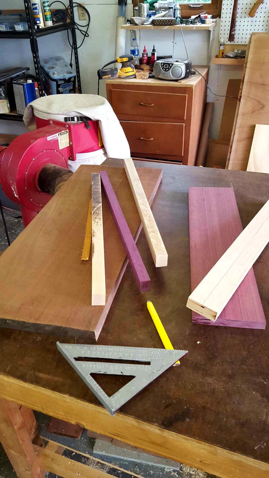

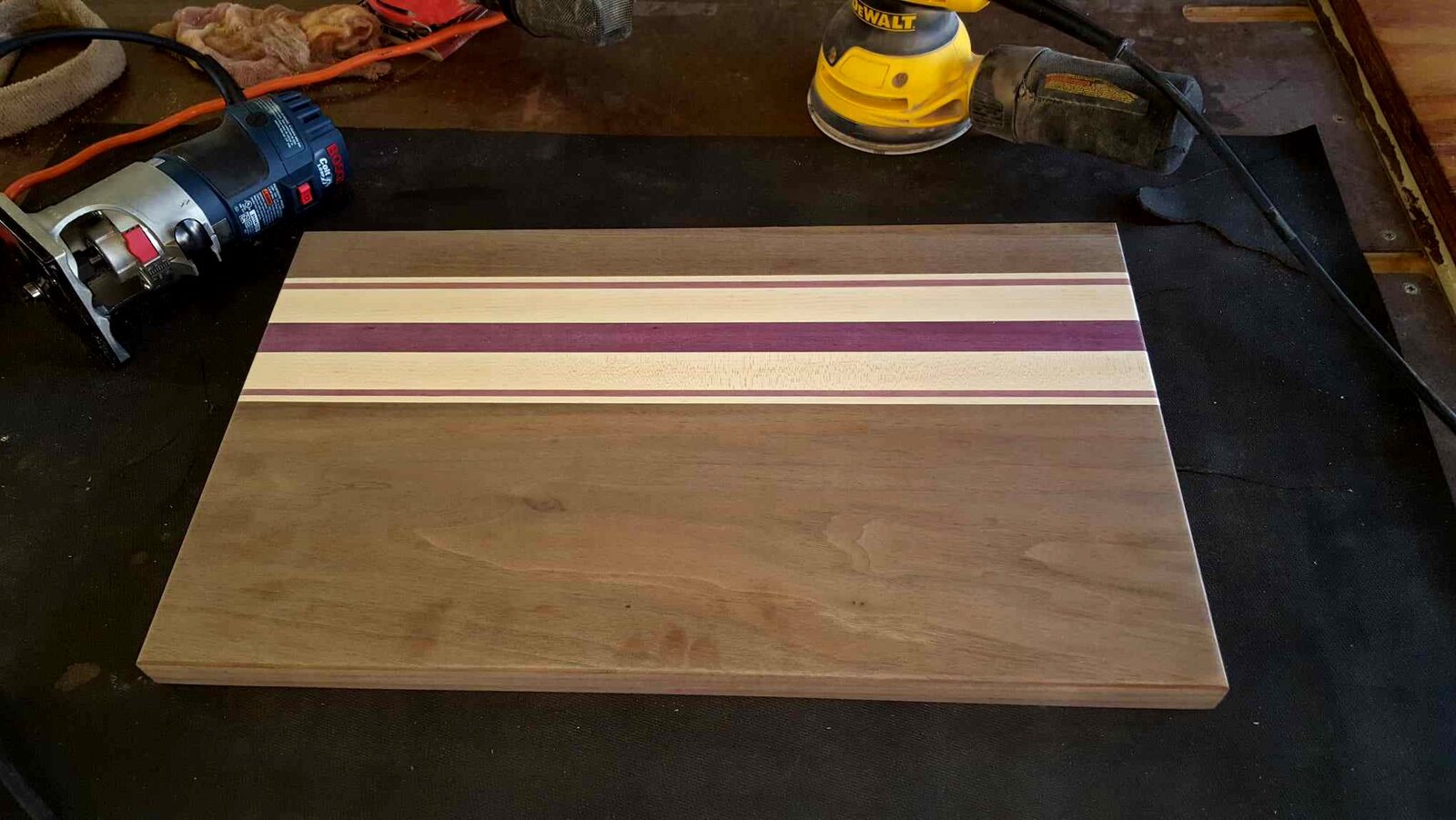

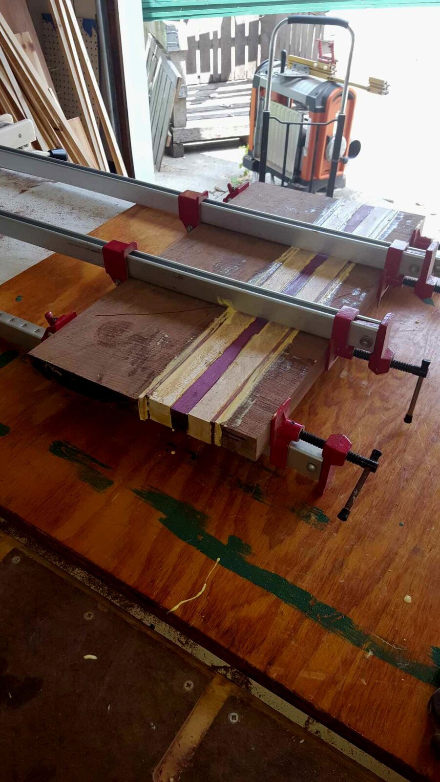

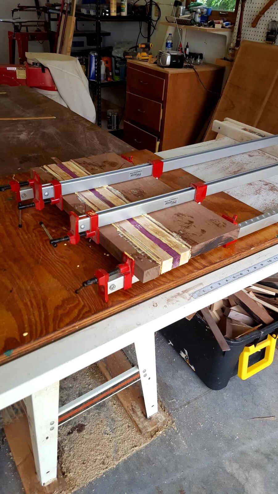

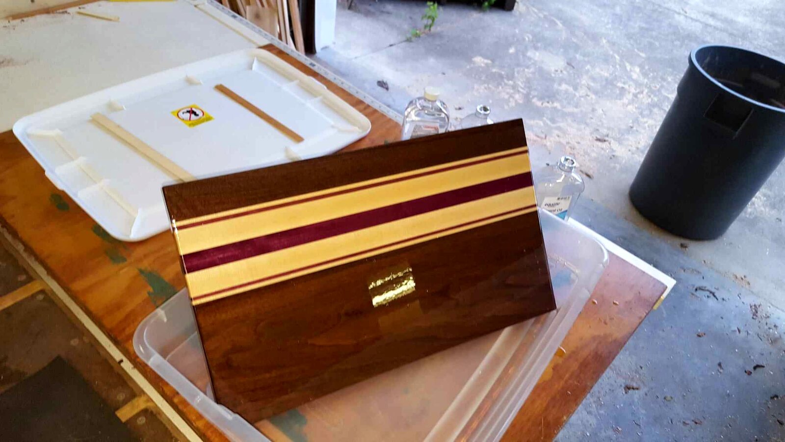

I always make my wife her birthday present every year. Usually, something turned. But I've also made different kinds of boxes for her... shelving... bookshelves...etc. After we moved here last August, she mentioned several times wanting a couple of bigger cutting boards actually made of wood. (we've got those plastic kinds). Well, I'm getting one done for Friday (her birthday).
21" x 12.25"
Walnut
Purple Heart
Hard Maple

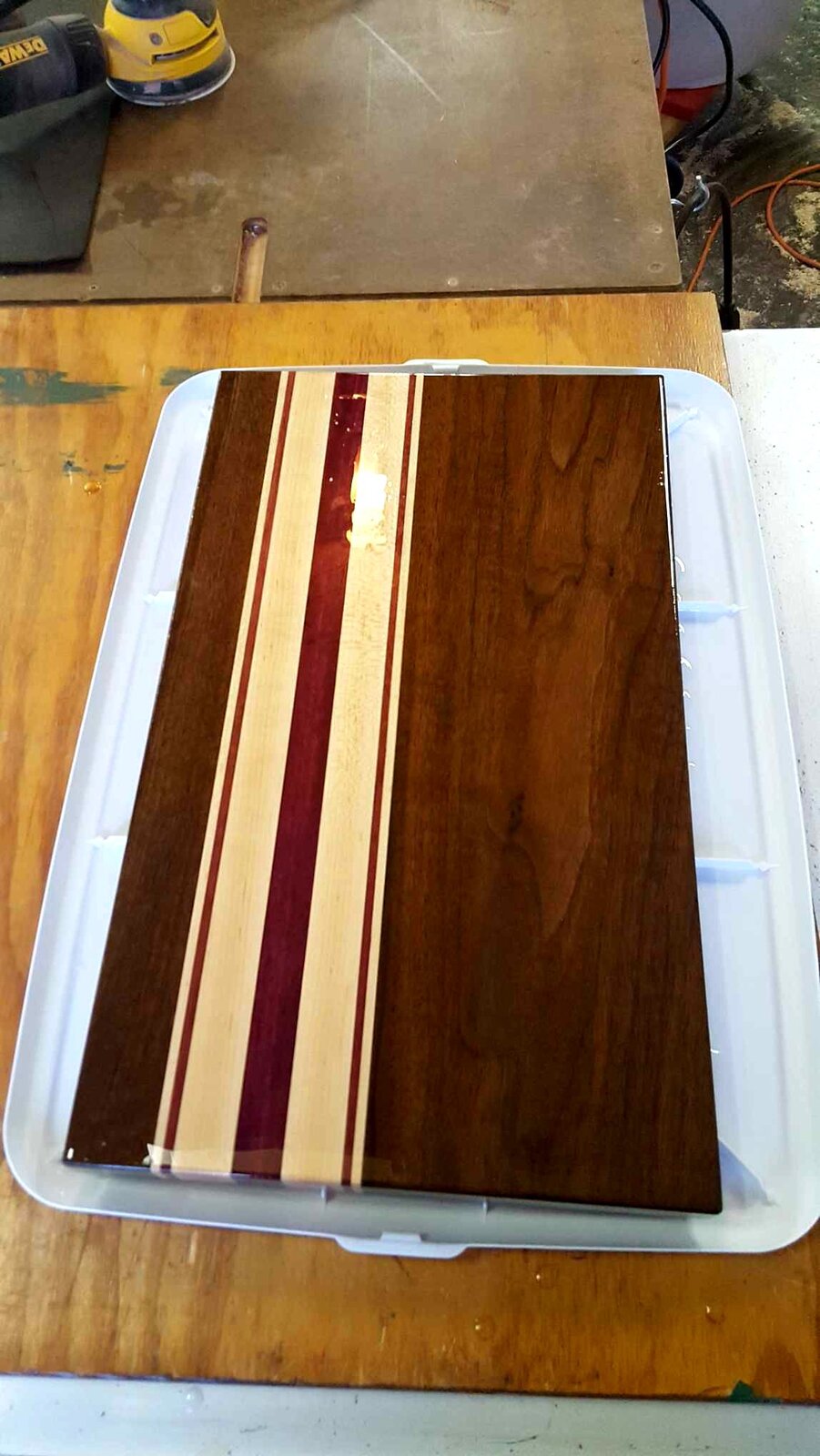

Currently getting oil up and it is sucking it up. The Walnut has been sitting and air-drying for 10 years. A guy in the church and I traded... I got two big slabs of walnut and he (his wife) got three bowls I made. Whenever this thing is done being oiled. I'll wax it up with my special wax I make.

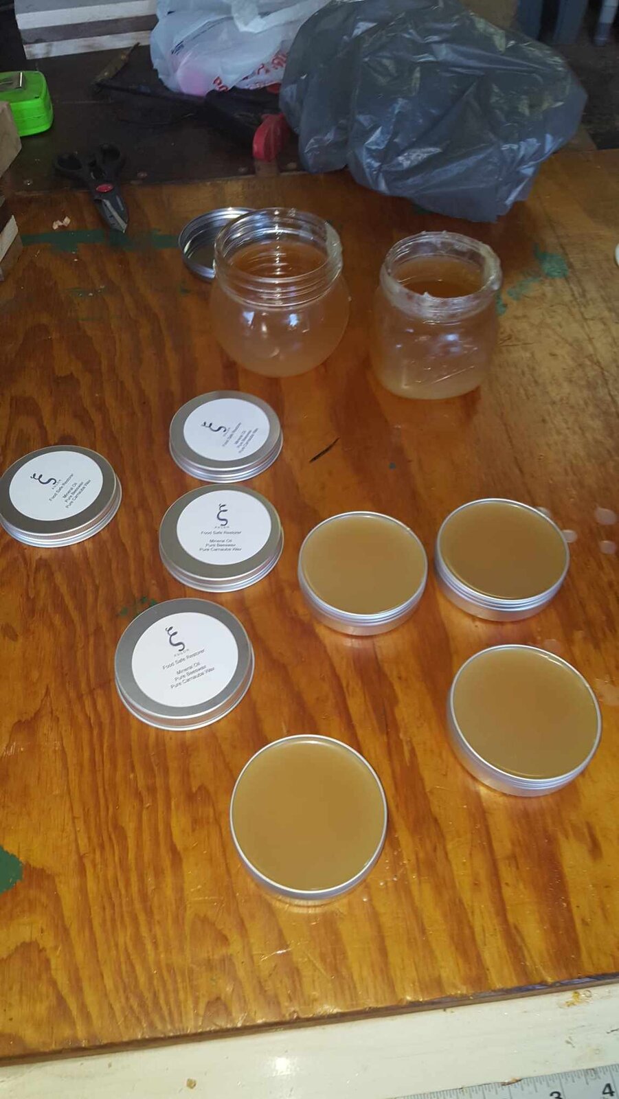

That cutting board is beautiful. What oil are you soaking it in?
I just finished a cutting board and I am using the Milk Paint Half and Half. Hope that's good stuff. My son bought it and he does exhaustive research, so I think it will be. First side of board looks good so far. I am going to use mineral oil/beeswax when it is all soaked up with the above. I understand the "not using it cuz it's too pretty". When I am done I will start a thread and post some pics. I didn't take any during the build.
Mike
Mike
Thank you. I soak them in Mineral Oil. After the dry and are wiped down. I use my own paste which consist of, 16 oz of Mineral Oil, 2 oz of pure beeswax and 1 oz of pure carnauba wax.
