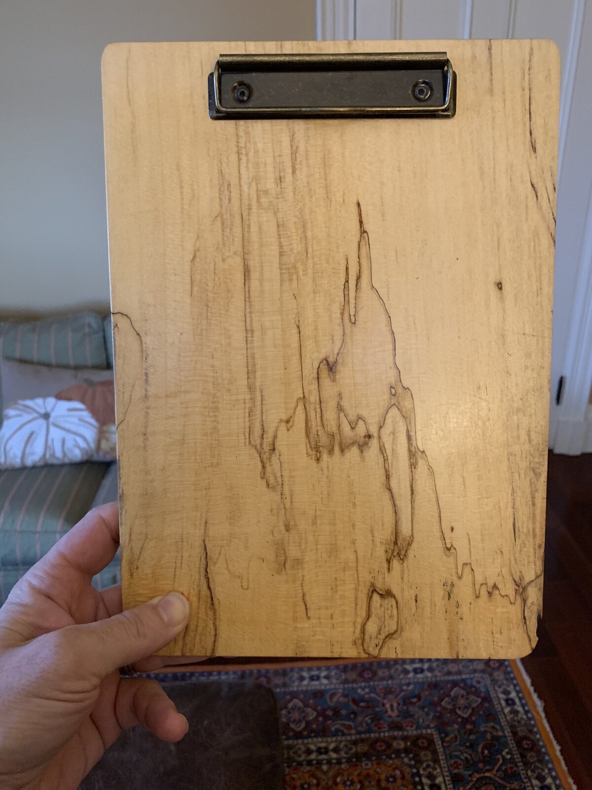

I have some wide planks of spalted maple that I'm looking for projects for. Some are over a foot wide. Wondering if I could just simply cut them to size and finish them, preserving the natural spalting patterns, or if that's going to lead to a board that doesn't last long or serve the chef (i.e., my wife) well, in the kitchen.
I've attached a photo of a clipboard I made from this wood, which I created as a kind of test to see what the wood looks like when made into something. (I use it all the time.) Great test, I forgot what I used to finish it (and am not thrilled with the result, but it's good enough to know that I like this wood enough to continue with it. It's been maybe six months and this clipboard has stayed true, but the wear and tear and blood/guts/water/knives/heat/mayhem/etc. of a cutting board is a different story.

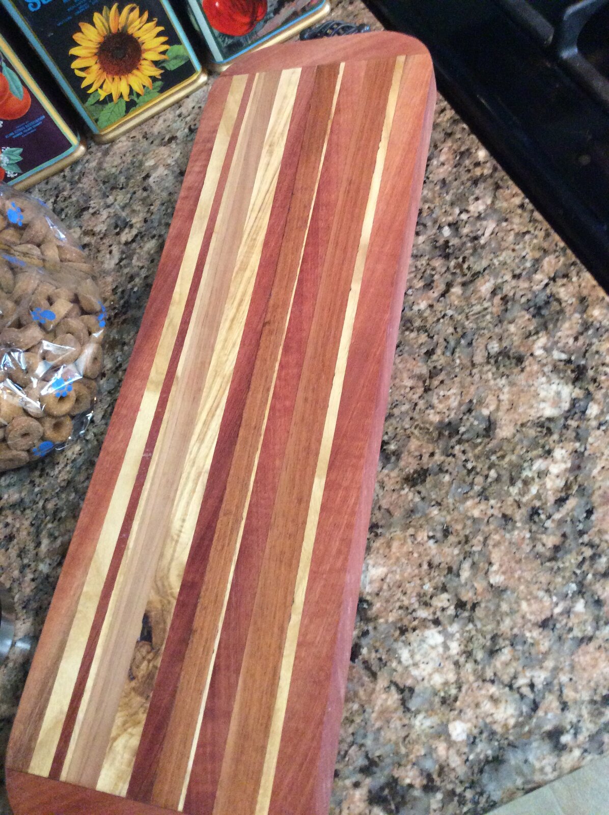

Here is my first attempt at one. Turned it into a meat/cheese board since I under estimated my wood needs. It's she-oak, teak and maple all edge grain. For a finish I used several coats of a butcher block oil that was allowed to sit for 20-minutes before wiping and applying the next coat.

Unless your Maple has soft spots I would use it with a mineral oil finish. Even if it starts too get beat up you can always plane off a little and re-oil it again. If it gets to the point where you think it is trashed, make another. Nothing in the rule books saying a board must last a few generations. The spalting isn't a health problem. Make it and enjoy.
