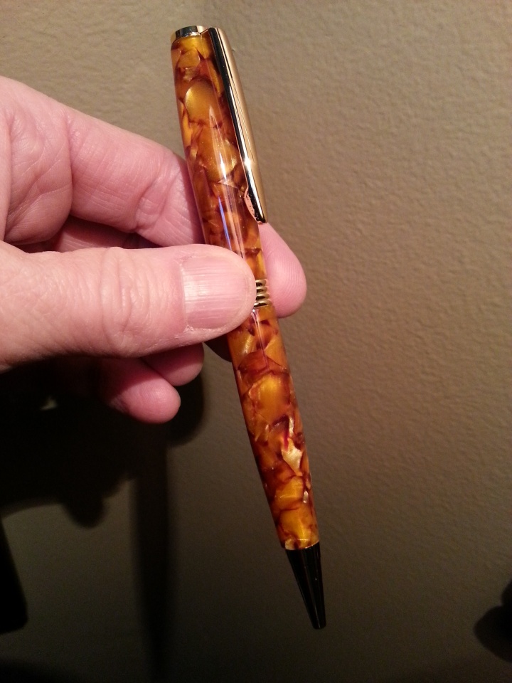

Thank you. At the suggestion of another member, I watched a Ed Burns (Exotic) video. I was not spending NEARLY as long sanding out of fear that it would create more scratches (in one of Ed's video's, he only dry sand and then buffs). I did want he did (but tried wet and dry), Gross' scratch remover, and then the rouge buffing wheel, and I got my best finish ever. I was simply was under sanding. I also think I may be looking for an electron microscope-friendly finish. May not be possible (yet :-).
Thanks again!
