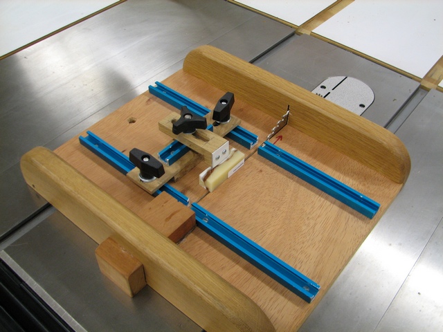

I recommend using a sled when cutting small pieces, if for no other reason than to keep all your fingers. Here's one I made that works well...

Thanks for the reply. Yes, I did mean very thin cuts lengthwise. My table saw is a 10 inch, but I'm going to assume what's important is the kerf and tooth count and set. I'm sure I can find a 10" blade that matches your spec. Very nice looking sled, by the way. Makes my shop made sled look quite primitive!
