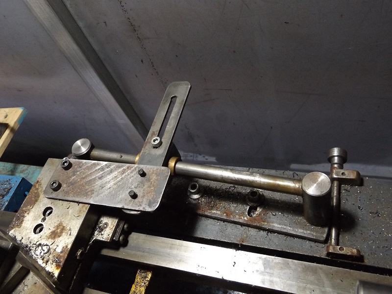

Because I make a lot of my own tools etc. I made a taper turning attachment,that is on my 7X12, that was in the English magazine "Model Engineers Workshop". I don't know if you guys get it over there, if you don't and would like a copy send me a PM and I'll photocopy it and snail mail it to you. I'm IT illiterate, so can't submit it here, sorry.

Hi Curly, the correct magazine, it is in issue no. 178 pgs. 28-31 and no. 179 pgs52-55. We have the same problem here, 3 issues behind, unless you have a subscription. I get it regularly from the shop, as it has a lot of interesting tools and tips. My latest edition has a tap sharpener that I'm going to make for doing the taps but also router and forstener bits. They used a Dremel like tool for power, I plan on using a sewing machine motor. I like tools that can be switched on and used, not spent 10 -15 mins setting up and then using.

Hi Curly, here's the photo. If you want the article on it send me a PM with your address so that I can snail mail it to you.

John let's say you were cutting a M T taper you would not have enough travel on the compound slide (well not on mine )plus you would not be able to use the auto feed,thus the reason for the jig.
