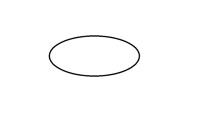

I need to cut a hole in a sheet of 1/8" acrylic approximately 2-7/8" X 7-1/2" in this shape -
I tried using a scroll saw but after it cut, it melted back together and I was unable to get the center out with out the acrylic breaking.
Any suggestions for cutting would be greatly appreciated.
