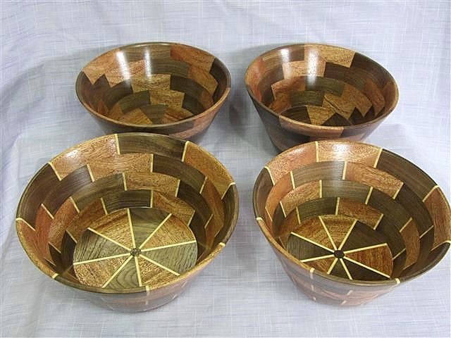

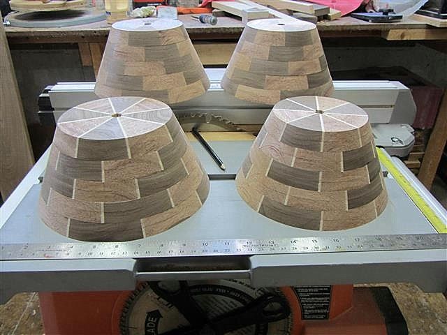

Cut a few more rings out this afternoon and was admiring and appreciating how good that magnetic cutter alignment tool works .
I was able to get pretty close previously using a steel straightedge ruler to have the cutters meet in the middle with no overlap or very little ridge to sand out But it usually took several tries to get it right . Now with the magnetic tool it makes it quick , easy and accurate .
Here are the rings exactly as I cut them out and stacked them up as I went. They are just setting there dry with no glue applied yet . Should be very little sanding to do on those four .
Of course they all started out as just a flat segmented board .
Seeing as these are segmented bowls I will be putting a one piece layer of wood on the bottom of each one which might help with any wood movement between the two different kinds of wood over the years.
[/URL][/IMG]

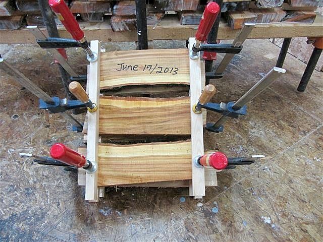

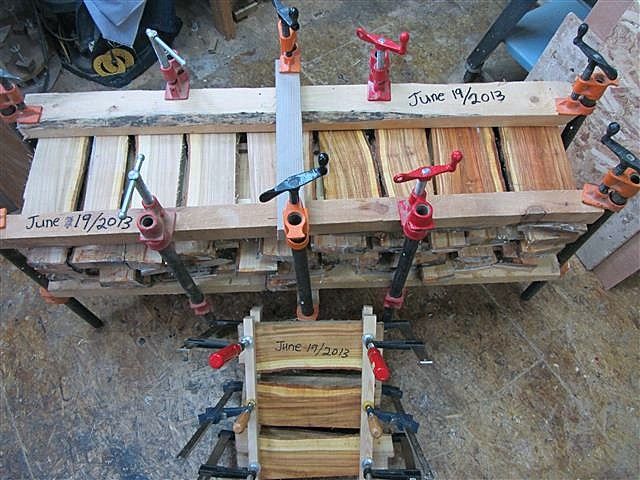

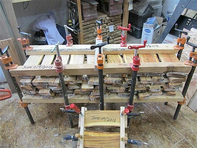

This is how I get my free wood for making Ringmaster bowls .
Pouring Rain all day but I went out anyway with chainsaw and cut those logs into pre band sawing state and took them in the shop and cut them all into 1" boards . Ends are all sealed with anchoseal so with the way I have them clamped I am expecting better luck than I have ever had before with orchard cherry which is famous for warping and twisting .
I wiped a little mineral spirits on a few just to show the beautiful color and grain pattern in that wood .
I will be tightening the clamps down every few days as I walk past that stack . NO room left in my shop so they are going onto my open porch with a roof over it.
They say we never have enough clamps . Think I have that stack clamped well enough ? . .. lol . . .

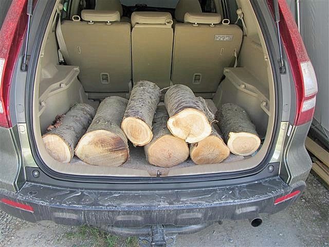

But I just realized that I put the cart before the horse because I forgot that I had not showed how those cherry logs started out on this particular site . A neighbour in town had called and asked if I wanted some logs from some cherry orchard trees he was cutting down.
I get lots of calls like that so only took a few . He would have given me a truck load if I wanted because he was bulldozing out over an acre of cherry orchard.
Here is what those boards looked like when I brought them home .

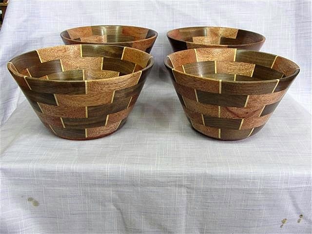

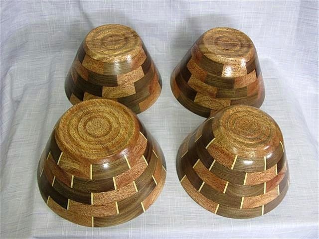

Finally got back in the shop and got some log sawing and other stuff out of the way before finishing these 4 bowls off.
Shop was 55 degrees this morning and the spraying of lacquer did not go well at that temperature. Don't try that at home . .lol . . Had to sand the first coat down and start over .
After 4 hours with a heater on it was up to 70 degrees and sprayed three coats of semi gloss WB lacquer .
Diameter on those four varies from 8.5" to 9.5"
